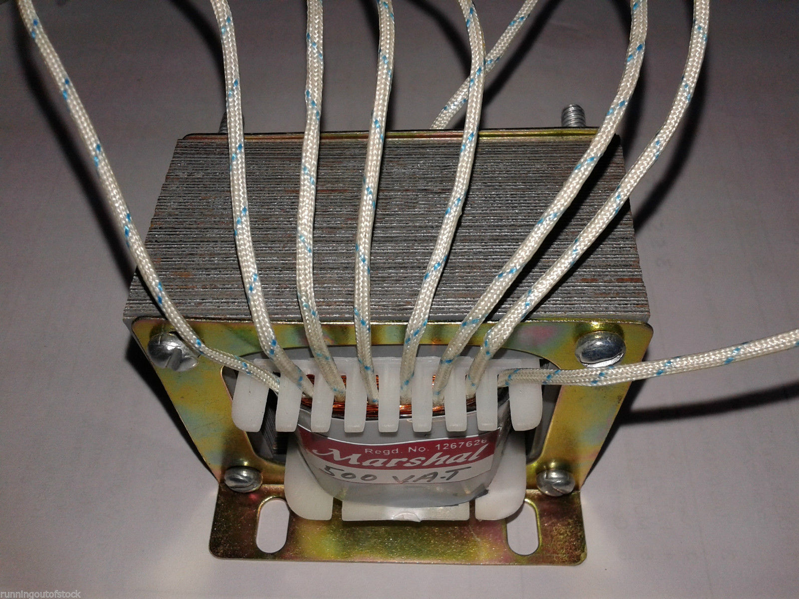

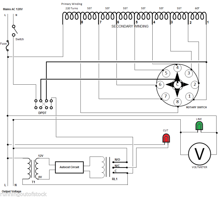

Hi All,
I came across ebay.in (India site) auto transformer with 500Watt. and it is cheap.
Auto Transformer 100-300 Volt 500 Watt for Stabilizer, AC Voltage Regulator
I hope it has minimum 50mH inductance. It has 500 turns. Please comment.

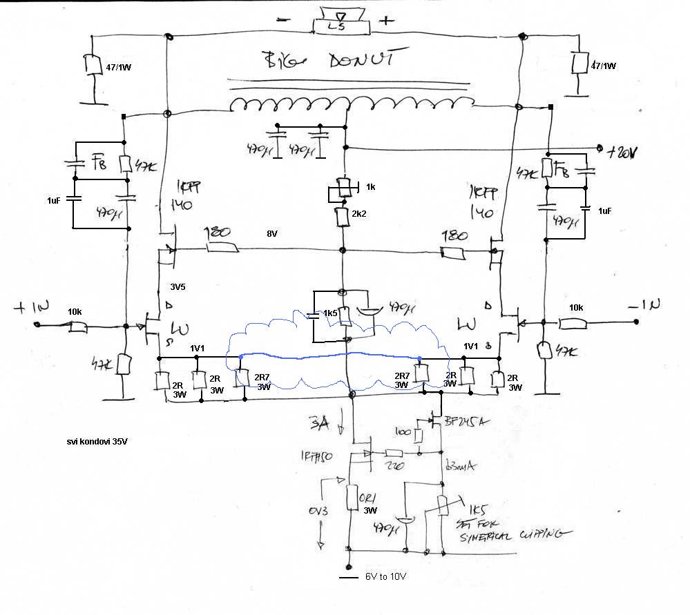

Iron Pumpkin is pretty much exactly that , two buffers driving autoformer ....... common mode choke , center tapped choke , call it however you want
Any link or schema of it ?
Cant' find any
I believe that's schematic of Magura's Big Donut amp
sort of "see what I have , correct that for me " schematic ....... few bits and pieces I would do differently nowadays , but there was some sweet music .......

The whole article from John Broskie:
index
I wanted to go this route. But I was advised to use rather big transformers (to get enough inductance and a low resistance). This is also expensive. Plus you will need to adjust the whole system to a nicely balanced current (as written in ZV7). I don't have this equipment.

zeus with only double choke (toroidal double primary) at the output
no transformer at the input, bias and driving à la MoFo
I would go for a transformer and use the double secondaries (lower resistance). I think the Zeus does this too.
And use a transformer at the input and bias a la F6. You can drive it SE or balanced with this.
