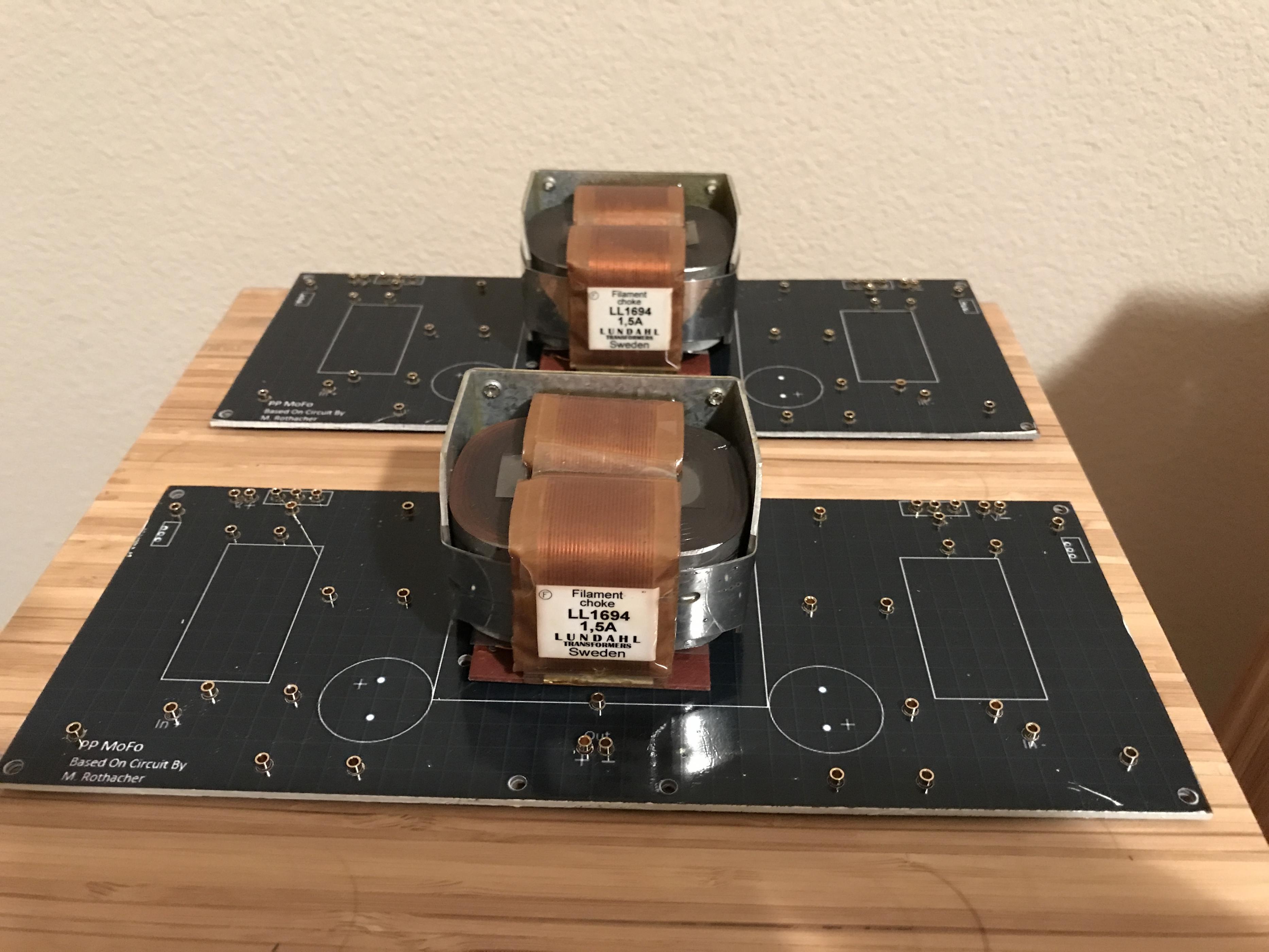

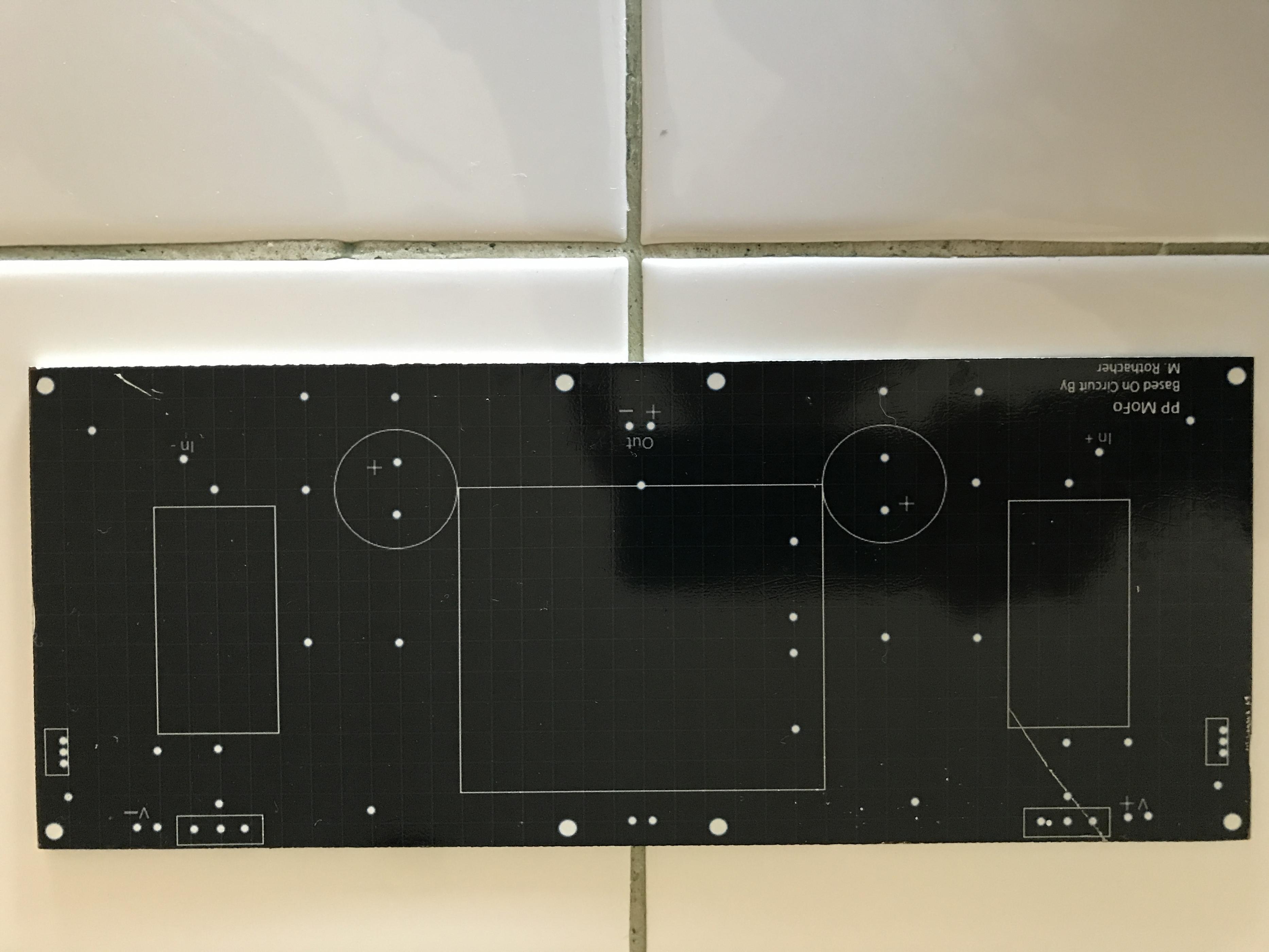

PP MoFo
So I am attempting to make a differential amplifier from the MoFo circuit using the IRFP240 and IRFP9240 with a Lundahl choke. I originally wanted to make a push pull but decided against it. However I do like the name PP MoFo so I stuck with it.
Very niceSo I am attempting to make a differential amplifier from the MoFo circuit using the IRFP240 and IRFP9240 with a Lundahl choke. I originally wanted to make a push pull but decided against it. However I do like the name PP MoFo so I stuck with it.
