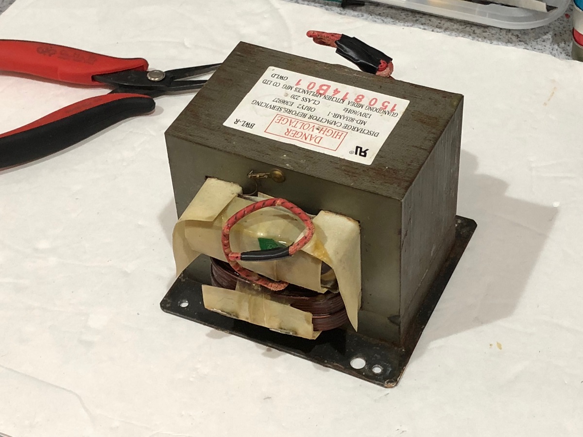

New MOT just arrived via eBay, same model number but comes in at 98mH and 0.98ohms DCR. I will be able to make a stereo MoFo now. Previous one was 67mH and 0.47R. How will this affect stereo balance?

You get more power out with chokes. It sounds a lot more dynamic. The MOTs are nice and cheap under $30ea yet measure well and sound great.
Thanks for the sonic insight regarding chokes vs. CCS. I guess one should investigate both these possibilities further with measurements as well.
Regarding MOT, it would be nice if you could order a pair that measured the same! At least with Lundahl, I know that a pair will measure close but they cost $100 each iirc.
Best,
Anand.
Best,
Anand.
It’s very strange that the same model and size choke would have such a large variation. Maybe I go and remeasure. Something could have been off with that LCR meter. MOTs also have potential for costing nothing (as scrap).
Hi X,
The differences may be in the core laminations, the gap, and the turns and the winding gauge. More inductance will not affect midrange and top end; but it will make more bass, which because it is not directional may not make perceived differences in balance.
The 'dead loss' on these inductors is the DCR. 0.98R means that with 1.7A you will throw away 1.67V from your supply; so if you have 27V supply, you are effectively working only with 25.33V, which reduces your headroom but is not too much of an issue if you can deal with the heat from the active device.
