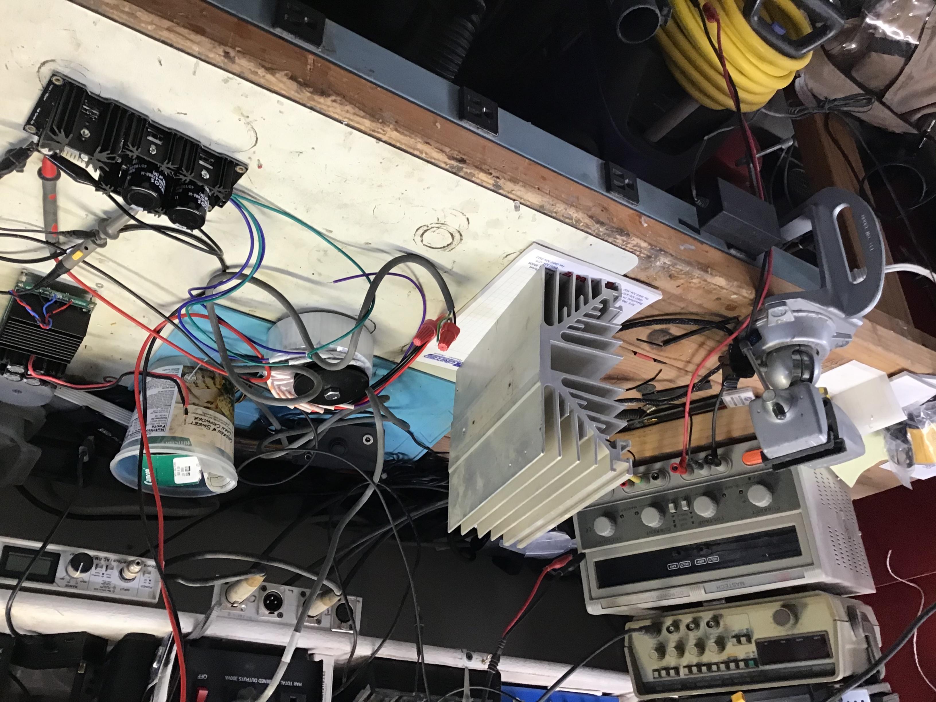

While I realize it’s a stupid reason to build an amp but hey any reason is a good reason. If I cut this in half I wonder if it would it dissipate enough heat for a pair of mofos, they are just unconventional enough to join my odd man collection. Strange when I post the picture it keeps inverting it, the gremlins are at play today!
Bill
Bill
MoFo runs a LOT of bias, try one with the whole heatsink and see if it’s cool enough. (They do run hot because it’s so hard to remove heat from a single device...)

I like them raw, I will order the circuit board but in the end I really like the Look of nude with flying wires. I will cut the heat sink in half and give it a try, I have some ordinary extrusion that would work if they get to hot. Will have to pair it with a good economical OB would look really cool. Kind of a wine cheese pairing thing. Finally built my Frugal horns and paired them with a pair of OPC wire 16 watt LPUHP mono-block amps nice system.

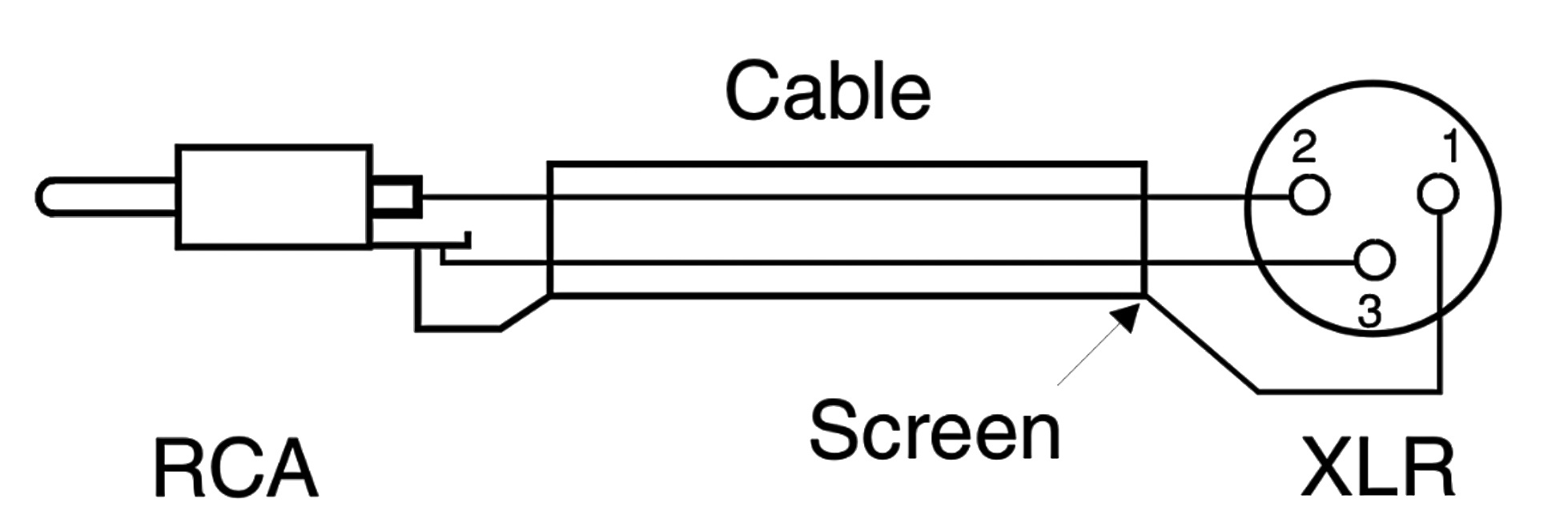

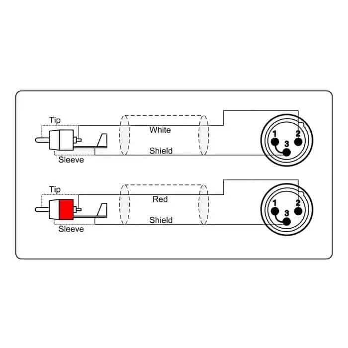

..with the mofo, what do you think would be the best way to merge the two?
Bill
Hello Billjust put some cables in between
pins 1 and 2 of XLR are take out points for RCA output 🙂
You need connect XLR pins 1 with 3 as well for proper RCA output 😉
Edit: you can make DIY cable with picture two
