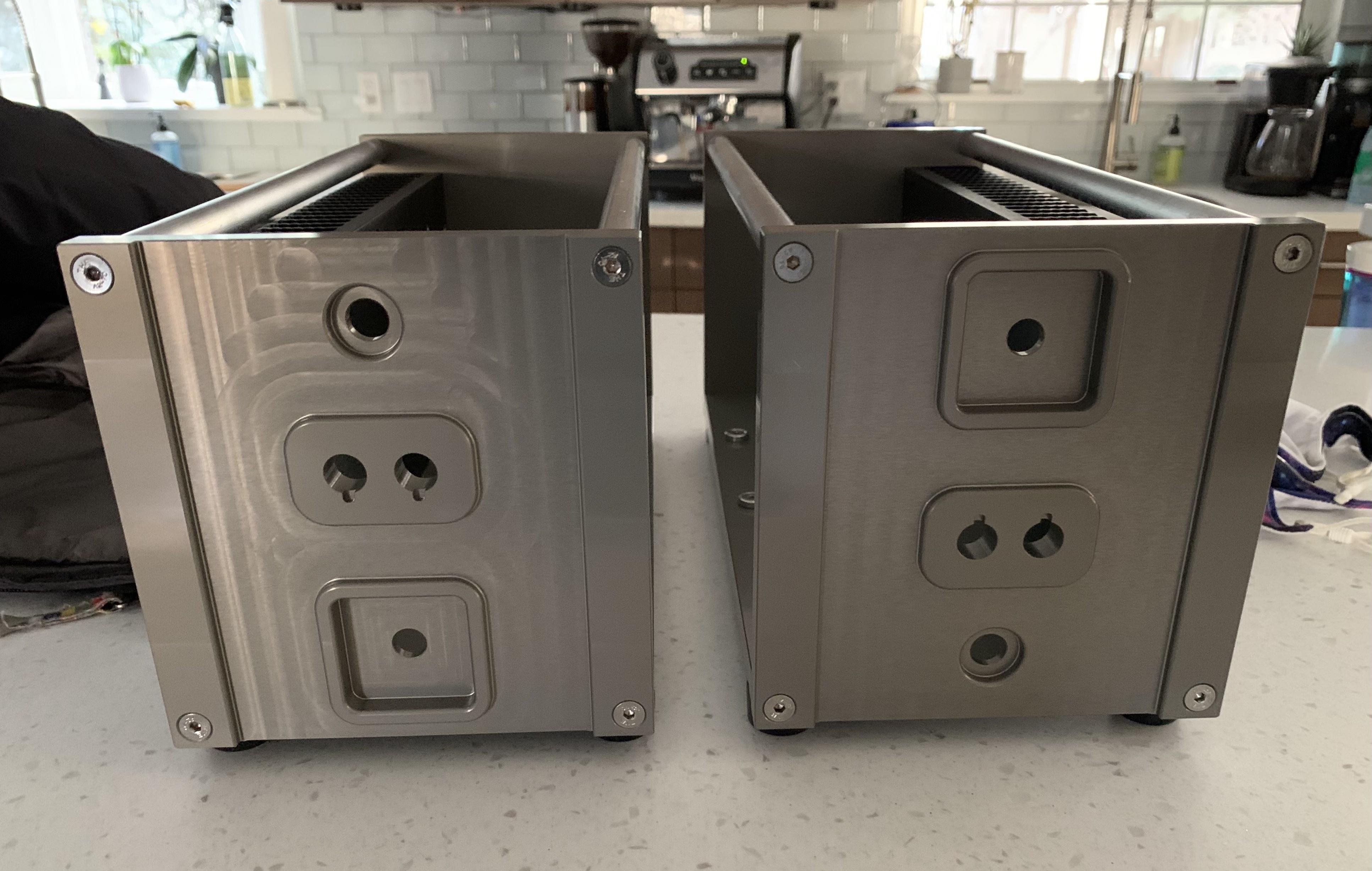

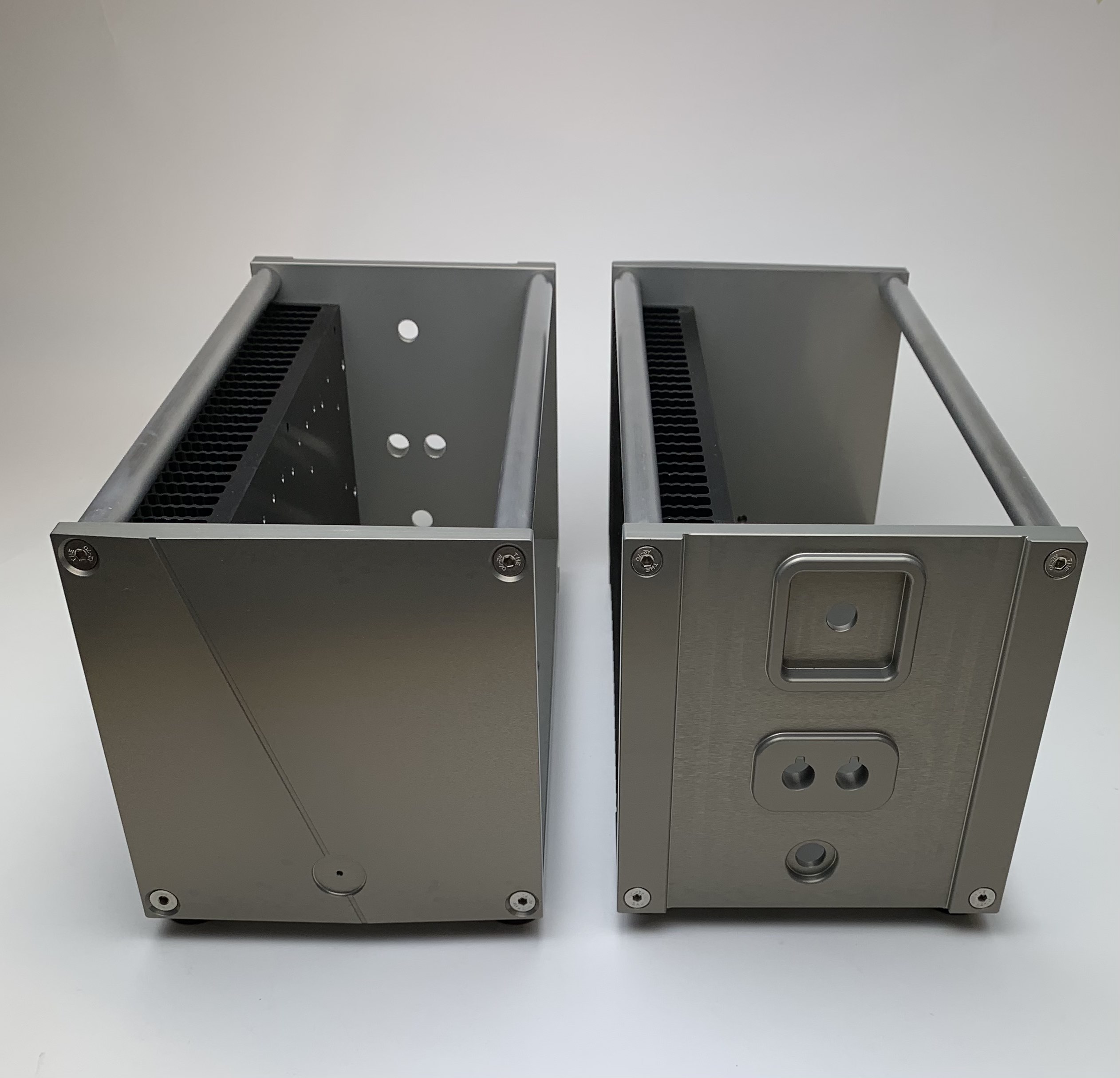

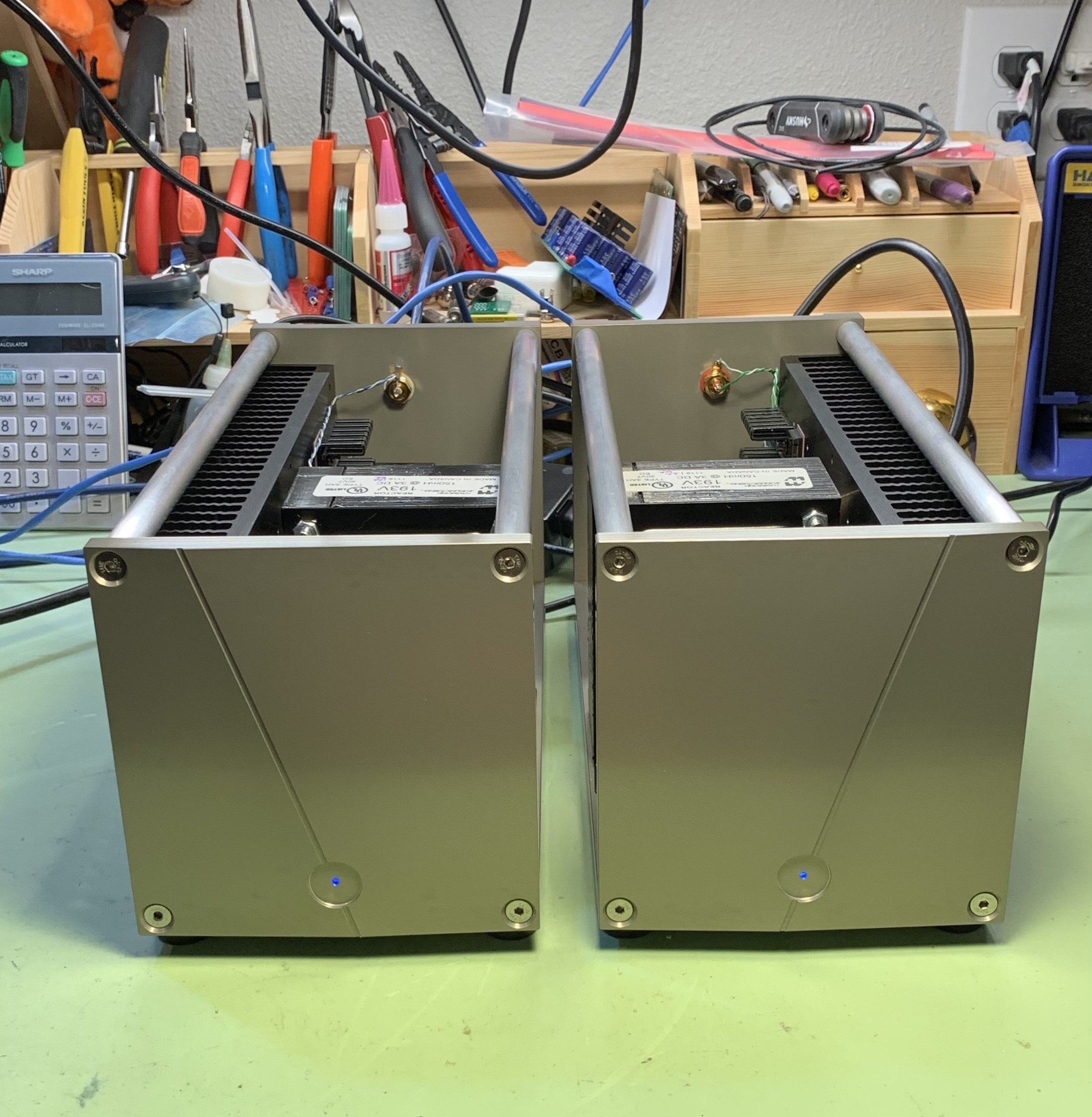

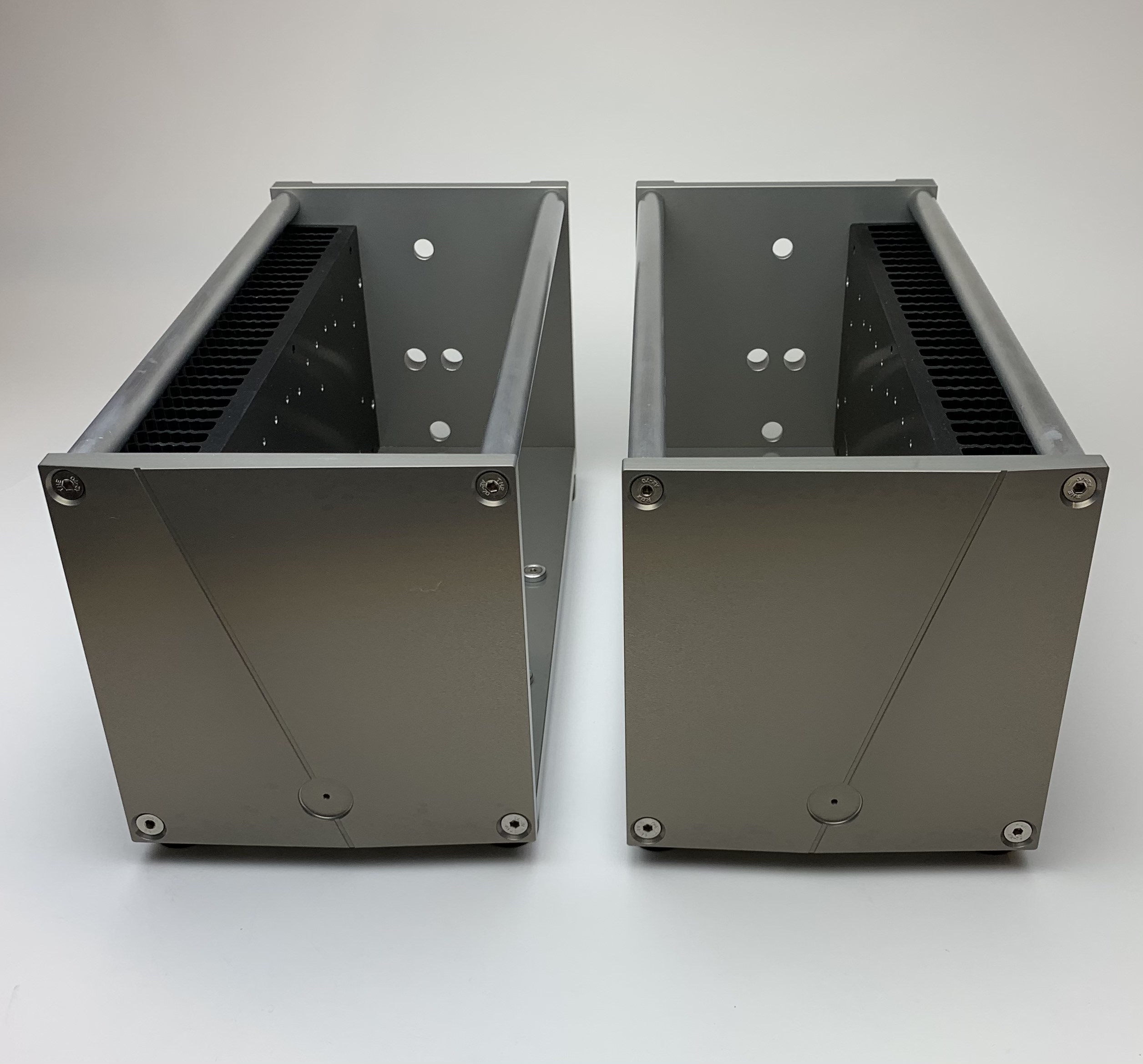

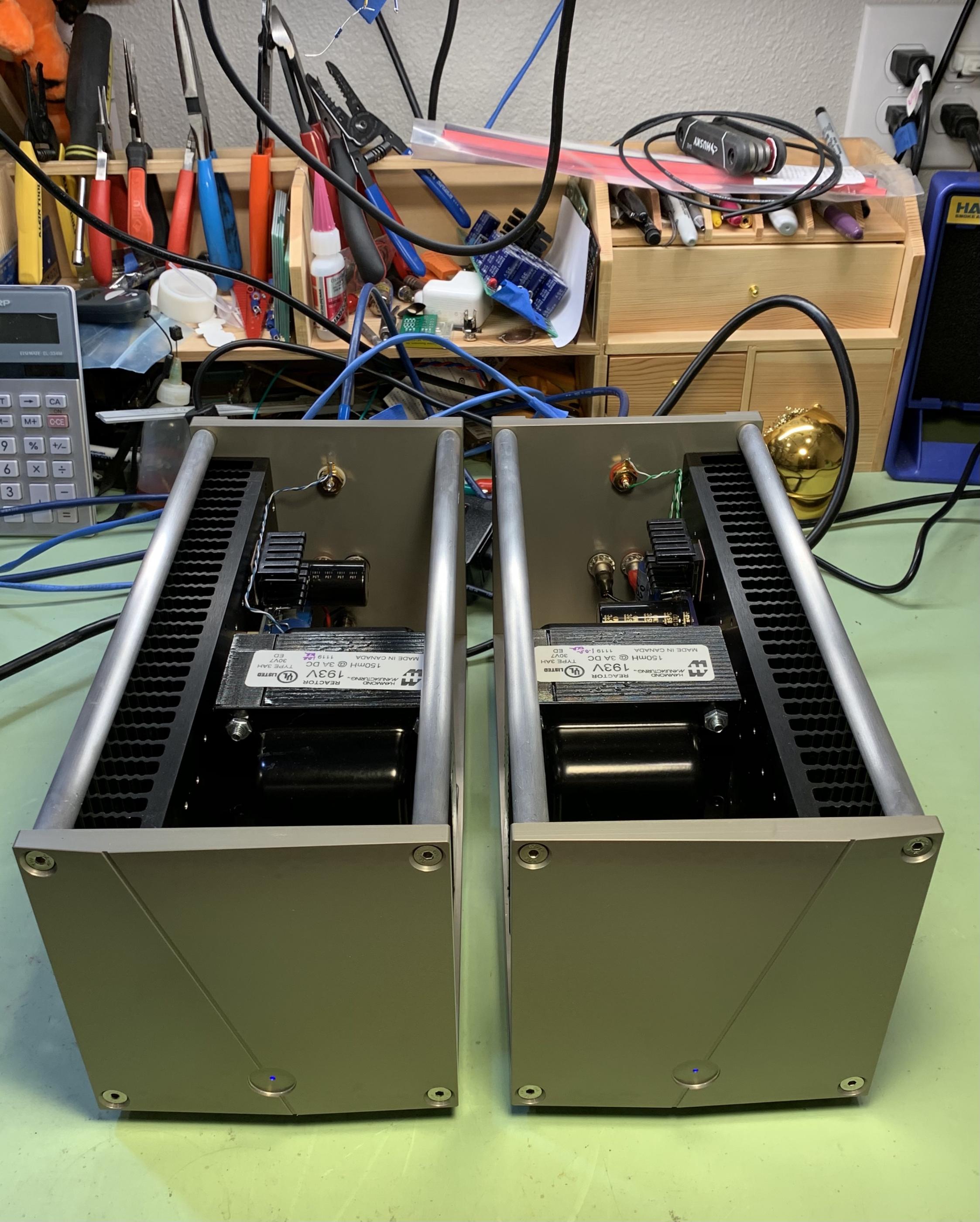

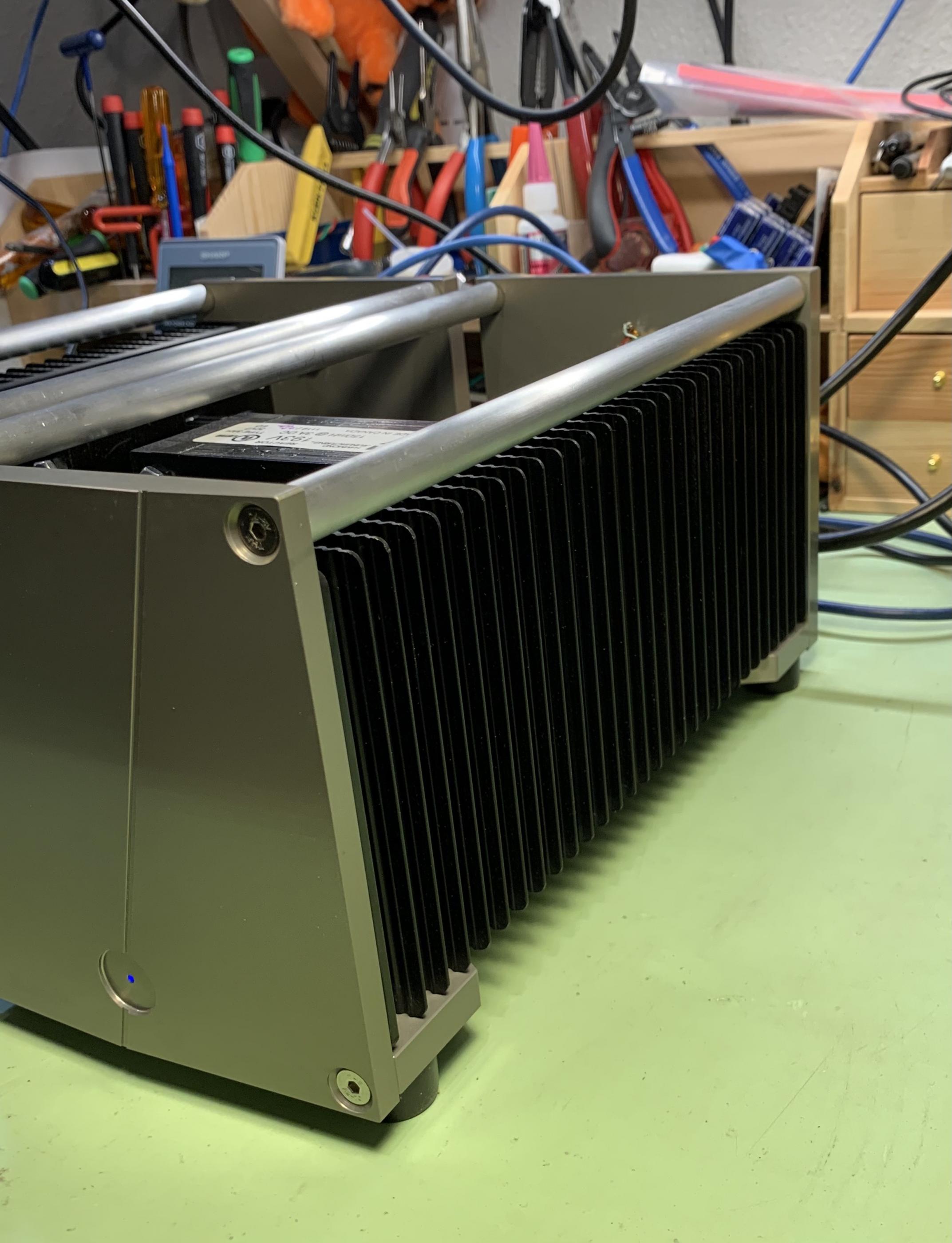

Absolutely stunning chassis by member j_thomas. Ill take some better photos soon but this is just too good to wait.
