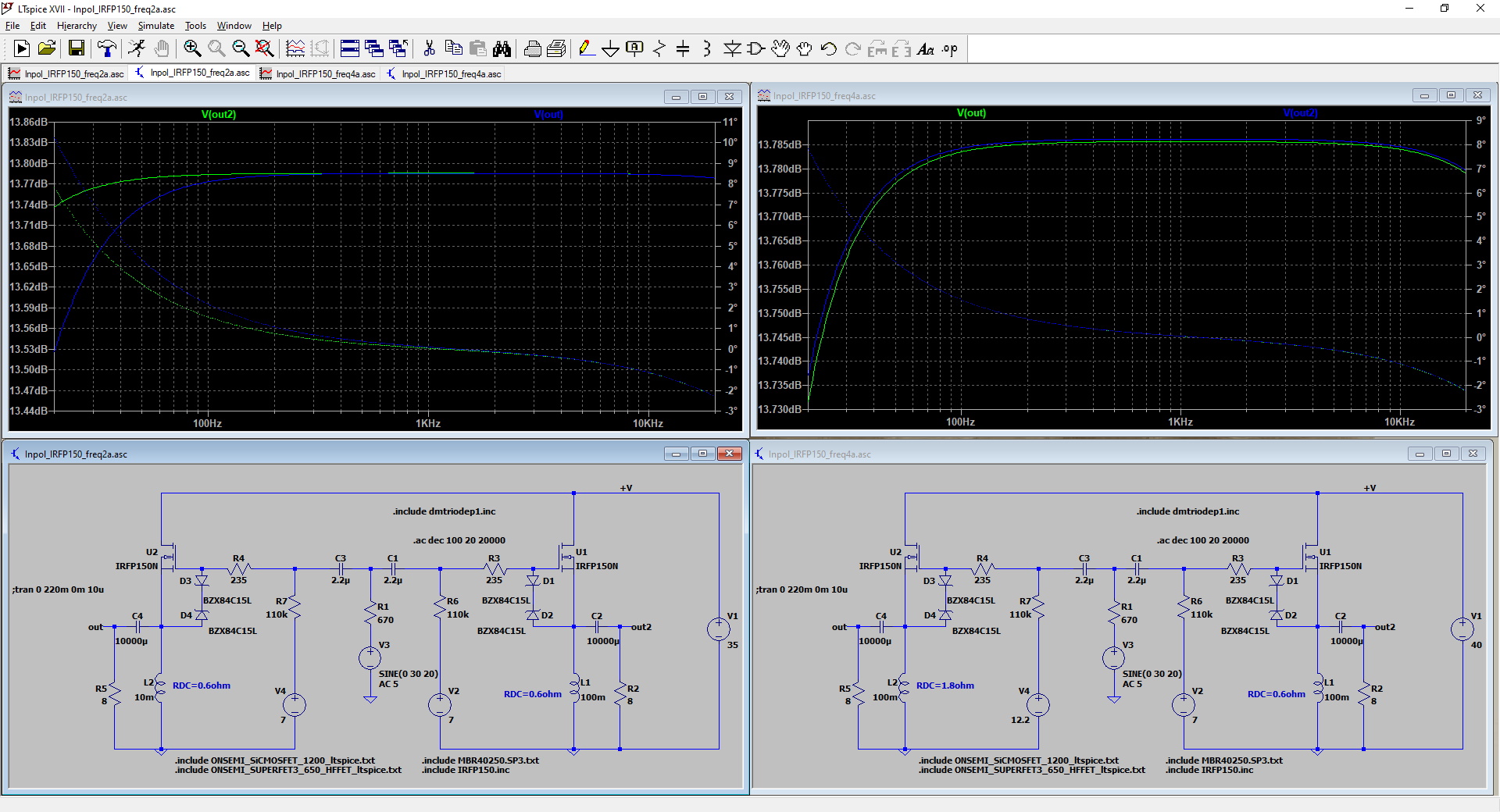

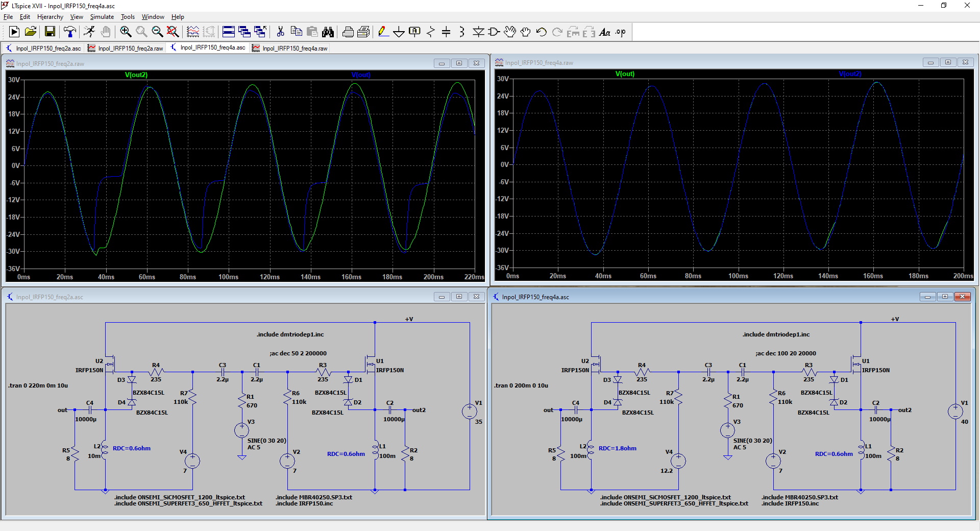

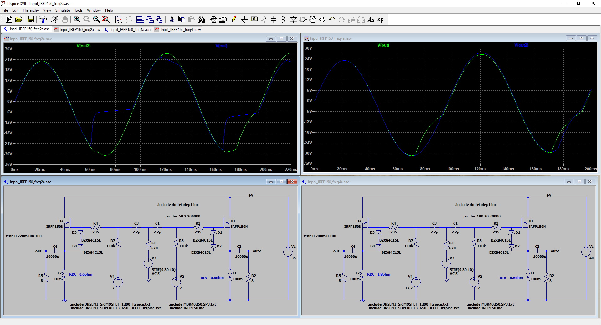

The parameters of the choke are important and there are big differences in low frequency, see here the simulations with different chokes.
100mH RDC=0.6ohm vs 100mH RDC=1.8ohm
100mH RDC=0.6ohm vs 10mH RDC=0.6ohm
10Hz, 20Hz and frequency response

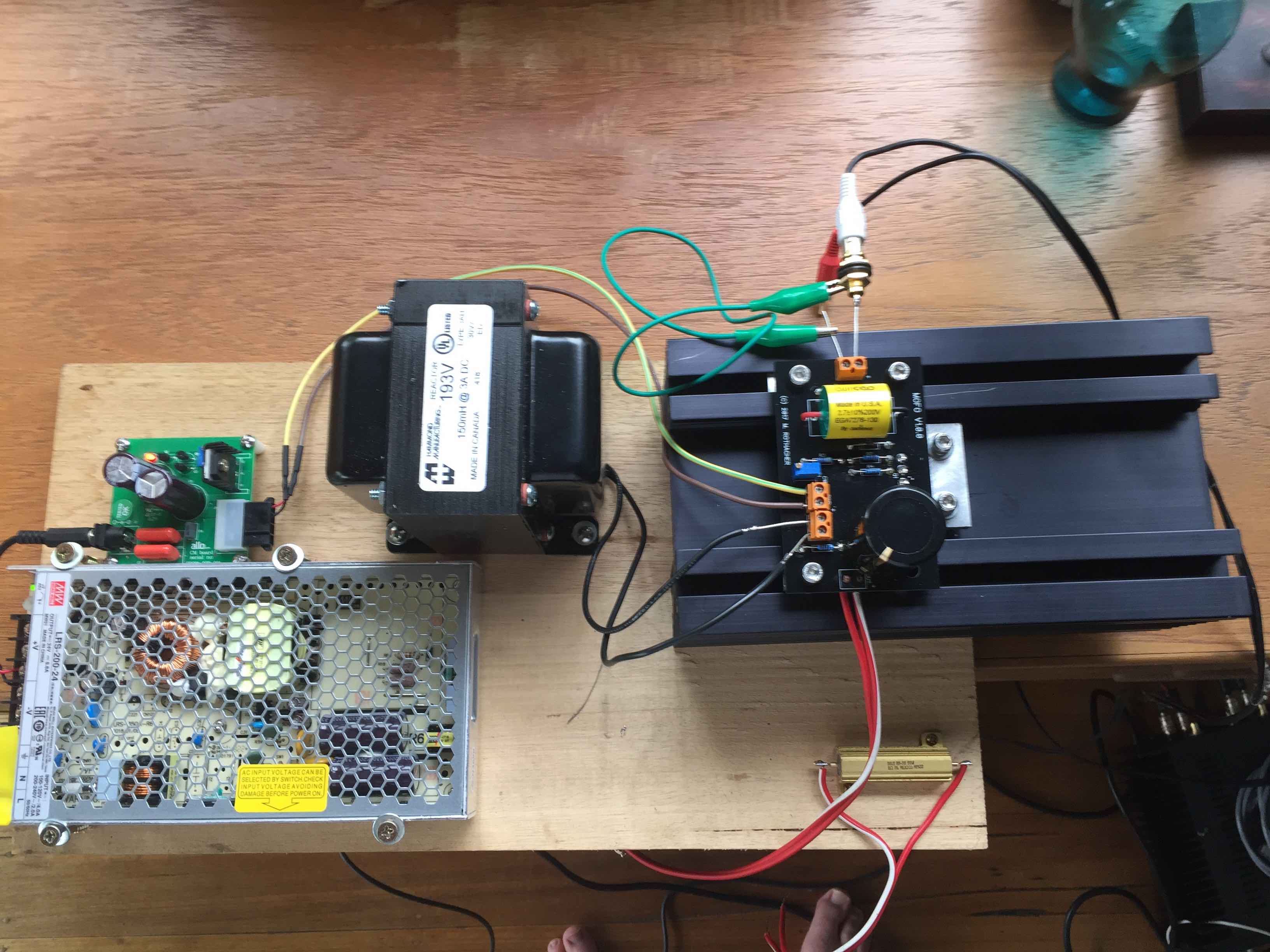

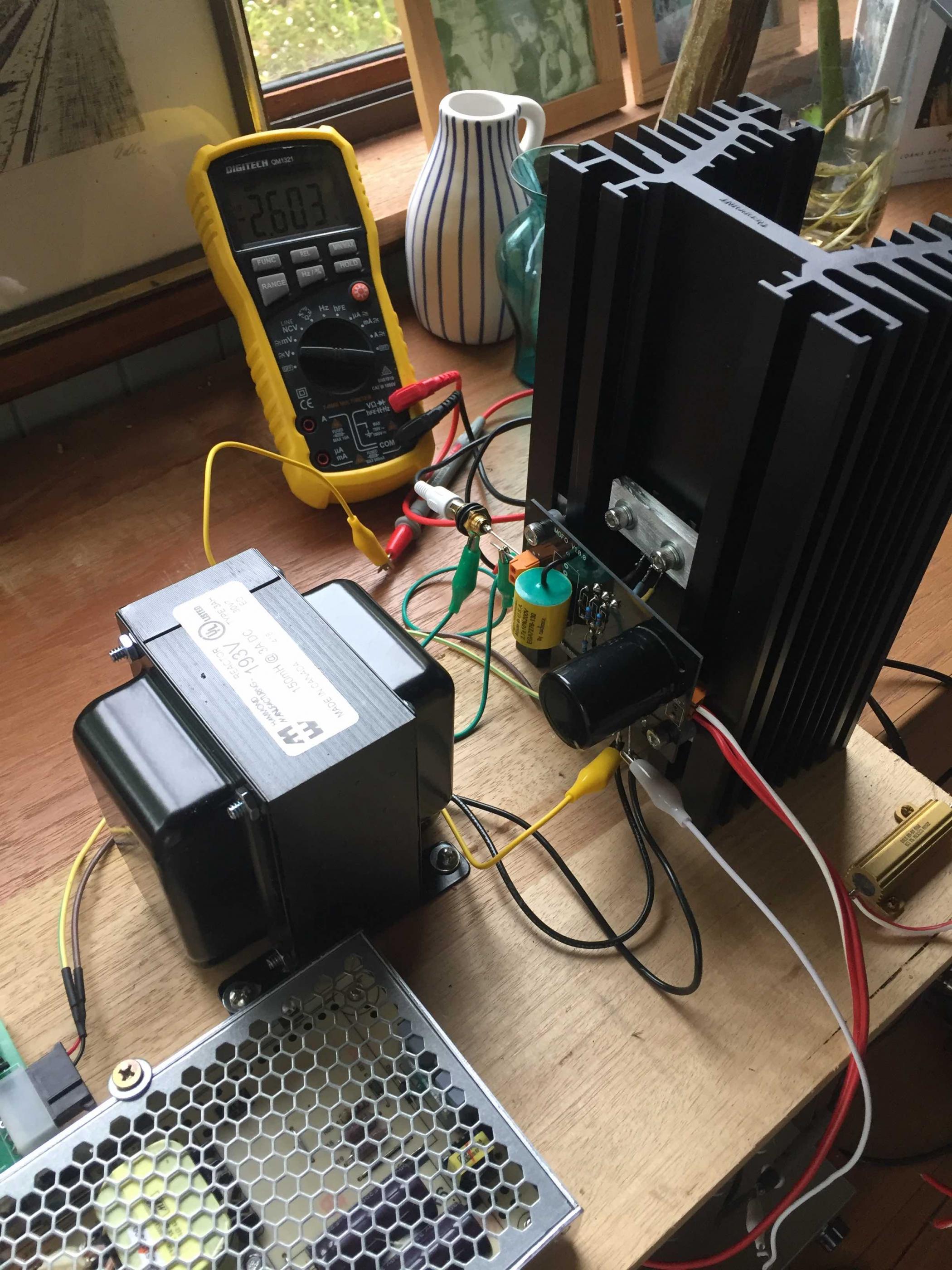

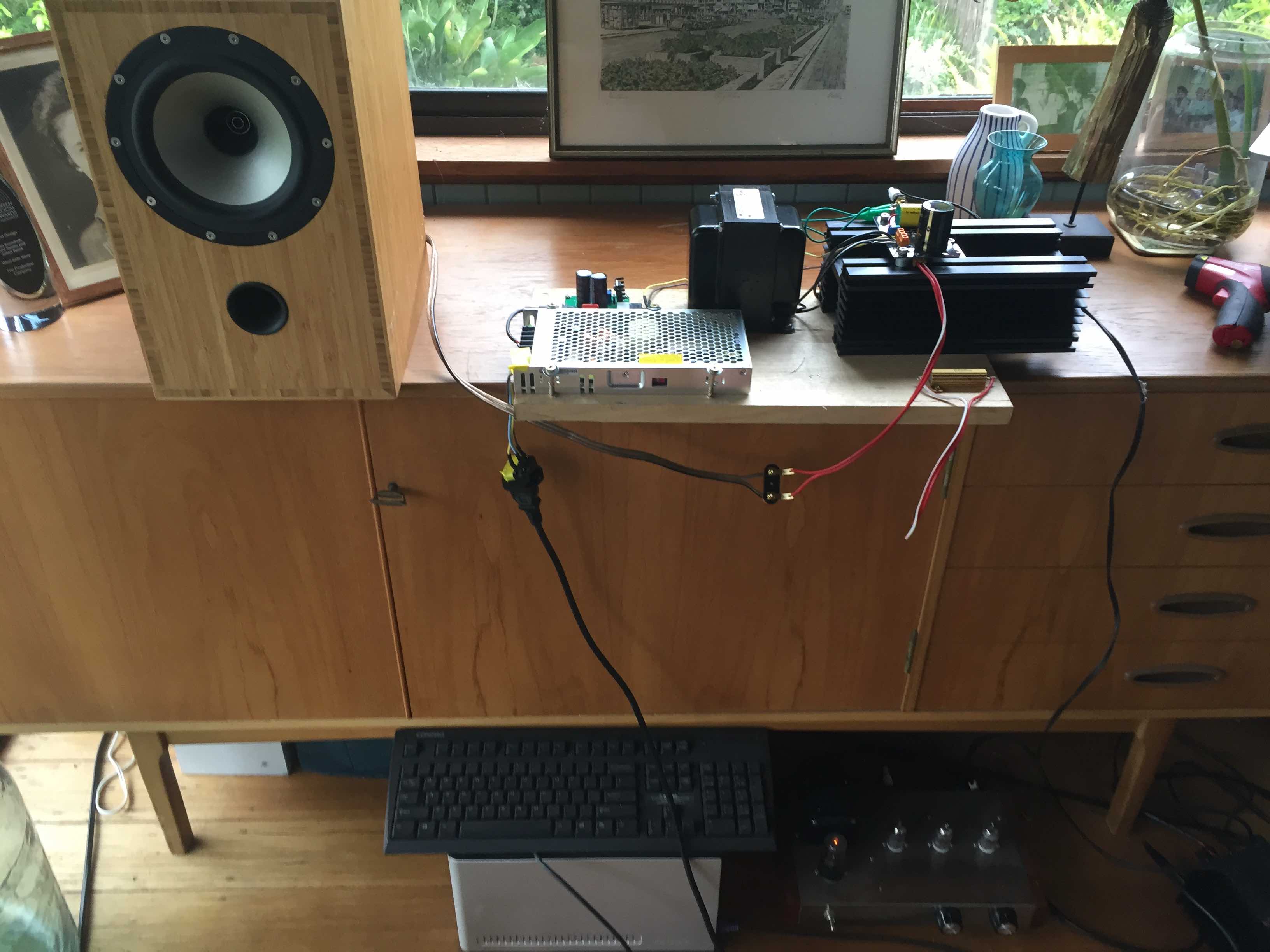

Well, after 3 years of chin scratching finally got to put the parts together for a basic test of one channel Big MoFo before building into chassis... Chassis design still in progress...! 193V inductor measures 1.1 Ohms, 24v Meanwell SMPS, Allocap CapMX. Adjusted to 26vdc output from Meanwell. Adjusted AllocapMX pot so as to read 24v at output.
Biased up reading 2.6vdc across the 193V inductor. Testing with music - reading around 54 degrees C just above the IRFP250.
Using chinese valve pre for listening test through self-constructed Bamboo Ply Tannoy DC1 clone. Amazing how so few components can sound so detailed... and... generate so much heat!
