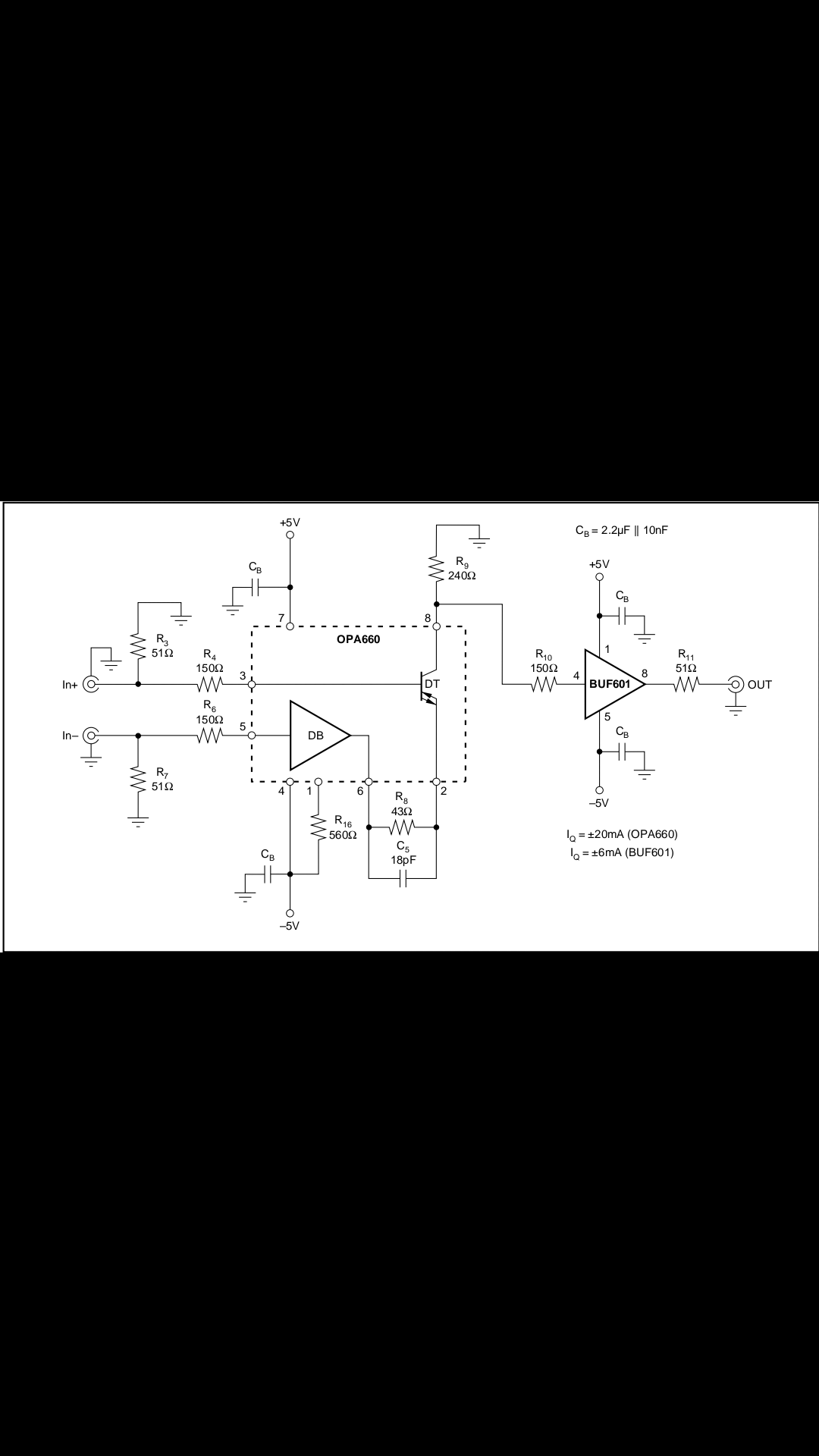

Hello folks 🙂
I've got your point, but if transformers and gain stage after isn't the "right and most suitible" way of using the ES9018 chip, then what is then? Is the Legato and Opus stage from TP really the only circuits who can make this dac do the best performance ever? At least on paper, because how it all sounds is up to the individual to judge🙂
Therefore, I mentioned fet and op-amps😉
I don't know much about fet and opa.. Still it could be interesting to see schematics from a McIntosh MCD500 cd-player, it use ES9018 chip and was said to be one of the best sounding digital players! Or maybe the Gryphon Kalliope dac!! Yes sir!🙂
Anyway.. Yesterday I powered up my dac prototype. Buffalo III loaded with 1,5 ohm from each phase to ground. Going into LL1684 1:1 Lundahl tranni's and futher into high gain (150 times and plenty noise) pentode EF86 tube stage. Sound was very good, really! but... It was not better than my first experiment with dac into LL1684 1:1 with no resistor to ground! And futher into low gain EF86 tube stage (25 times and low noise)
I could not hear any difference between loading the dac with 1,5 ohm and high gain, or no load and low gain - Maybe that's just me....
The next days I will try out these brand-unknown step up 1:15 tranni's that I got, load the dac and use the 25 times EF86 gain stage and see how it turns out😀

We are playing with transformers not because we don't know OPAs...
My mistake about your preferences, sorry!)
As I've read in the net the best choice for ES9018 could be discrete fet I\V stage, besides transformers. The most prefarable for me would be Erno Borbely all fet I\V converters.
Has anyone seen those schematics?
