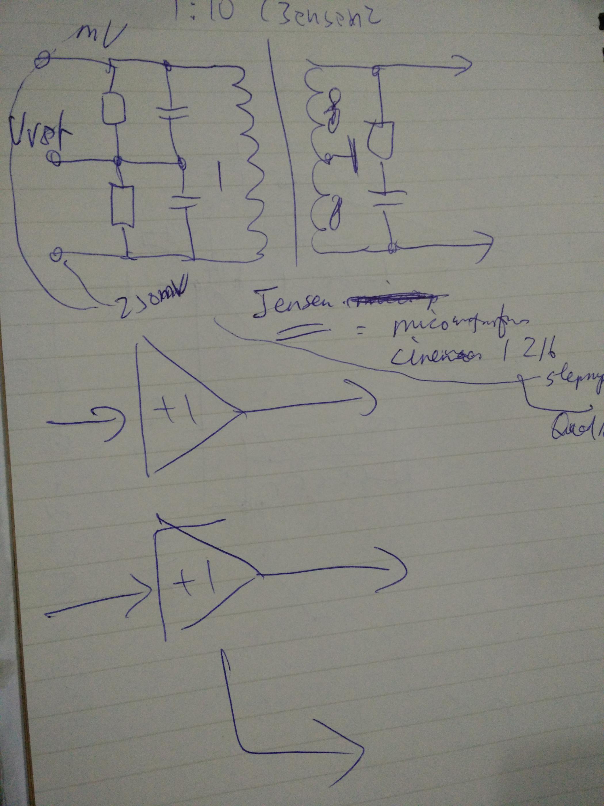

Last night at a gathering I asked Thorsten Loesch to recommend me an IV stage for my 9018 dac. The only way he knew he said that would sound good is ....and started drawing it on paper..see the attached..
So it is a step up transformer stage(to be followed by a 5867 tube or a lsk389 FET buffer). And it should be low voltages across those resistors.
He also stressed that the resistive loads should be connected to Vref and not ground....
As for the OTA opamp approach I also asked, he said that should work ok too... :)
This is thinking along straight "voltage" DAC application - is Thorsten just following convention - a convention that can not be broken for any other "voltage" DAC, other than the Sabre DAC. Also, in my view, offset current is preferable to offset voltage.
Sometimes rules needs to be broken, but only sometimes.
Done over a hundred of those with the Sabre DAC. :D
Cheers, Joe
Yeah..I am not sure if he had done anything exhaustive recently on the 9018 iv, as this chip is not in his current agenda I guess...
I did question him if I should use small resistive loads to get into deeper current mode..and he asked me to define it...:( He definitely knows it well but just doesnt care about using it under current or voltage mode I suppose... :D
BTW, is it ground or Vref that the loads should be connected to? Have you tried it on Vref?
As for the OTA, I recall hes the one.that first proposed the opa660 which I plan to try....a bit OT here, could you answer my question wrt ota in the other.thread? Thanks Joe :)
Only with opamps, but with OTA I would rather take it out of the equation. It's just another potential way of letting noise in - and in this instance less is always a plus as Vref is supposed to be a zero impedance reference, across a very wide bandwidth. Sorry, here I believe it to be a good thing to be suspicious.
Besides, using a zero feedback OTA, getting things to Ground makes sense in other ways, much easier as you don't have to get rid of +1.65V when you connect directly to OTA (off topic I know), which I do all the time.
But I don't want to come across all preachy, I just bring up the options for others to consider and they decide what suits them.
Cheers, Joe
