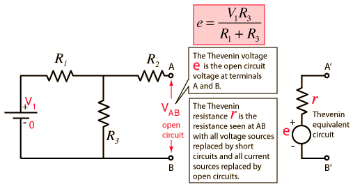

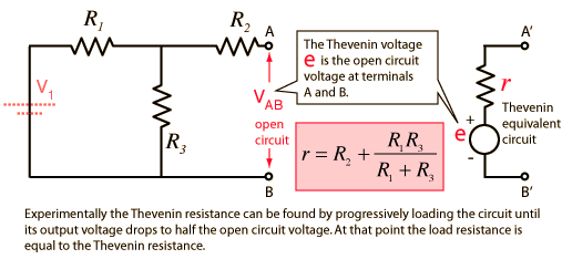

From Thevenin law:
you can replace DAC (1,65V +195ohm) + Rload circuit with equivalent e voltage source with r resistance (in this case R2=0).
You can quickly calculate your new source equivalent with online calculator on boottom of this page (enter R2=0,000001ohm because it doesn't accept 0 value):
Thevenin's Theorem
So do the math and come back with results 🙂
Hello 🙂
All right, I tried to enter the data that I have - dac, load and so on.. The picture look like this:
I must admit that I don't understand much of these numbers or the calculater..
I never heard of Thevenin law, but hey, I'm a carpenter😀
For me it looks like transformer is served an output impedance of 0.49872222 ohm from dac on primary winding when I load the dac with 0.5 ohm!
Is that true??
Can you Marek.. Or somebody else bring a light on this for me 🙂
I would be so enormously happy if it is possible for me to present the LL1941 for a source impedance as low as 0.5 ohm!
