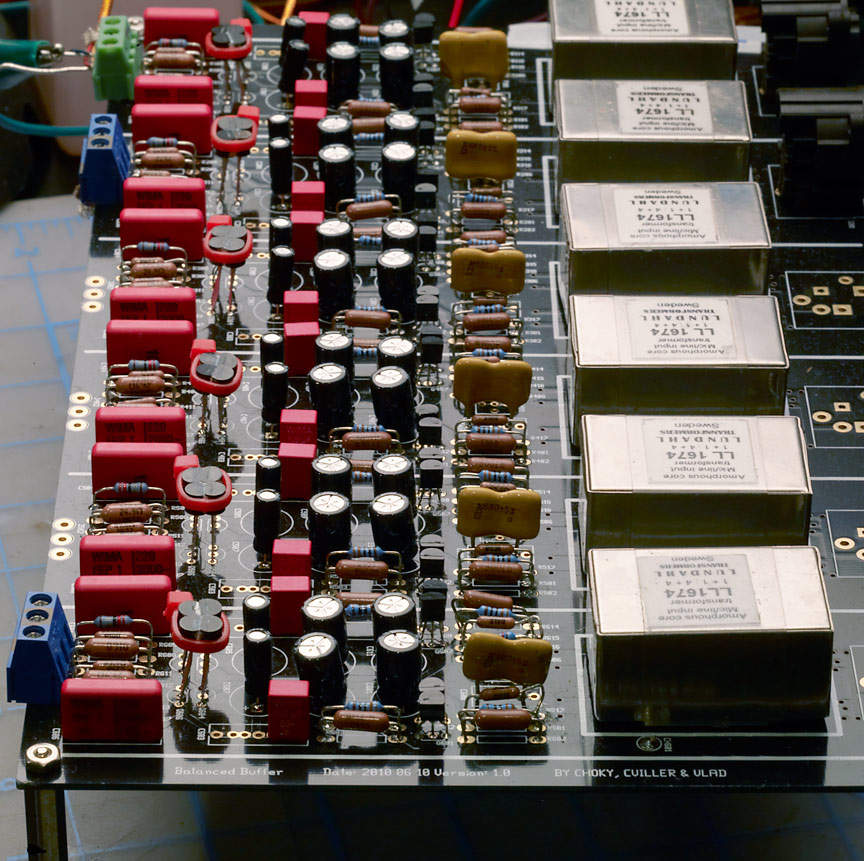

For now I have finished a tube gain stage and I'm ready to experiment with Joe Rasmussen's suggestion to load the Sabre dac with 3R to ground or even lower (I have borrowed 2 Lundahl 1984 1:1) but: First of all I was thinking: Why use a transformer 1:1. The signal has to be gained after 3R of course like 50-70 times..
Would't it be enough to load the dac, put in a high quality cap between dac and tube gain stage?
What role does this 1:1 transformer actually have if the if the signal has to gained pretty much?
I had this theory - Why not use an Lundahl ribbon mic transformer like : LL1927A :http://www.lundahl.se/pdf/1927A.pdf
Or LL2913 :
http://www.lundahl.se/pdf/2913.pdf
And together with the exstremly low dcR of the primary it would be possible to let the dac see a very low impedance without "killing" the signal to ground with these very small resistors! And the gain after transformer would not have to be as high like in a riaa preamp - You guys follow me?

Lundahl MC transformers
I don't understand this. This transformer is not designed for a 50 Ohm source,
just measured this way:
quote: "Lundahl Frequency response (serial connection, source 50 Ω,
no load / secondaries open):
8 Hz -- 100 kHz +/- 1.0 dB"
Remember, this is a moving coil transformer, suitable for cartridges from about 1 to 15 Ohms, the highest would be the Denon 103, 40 Ohms.
Because of this they are perfectly suitable for our task, if their distorsion is low even at these higher output voltages, around a few hundred of millivolts.
My favorite would be 1941Ag, I use a silver output transformer the other way round, makes 1:25.

It is really not important that it is for 50 or 40 or even 15ohm.
Note that DAC output resistance and inductance of primaries makes high pass filter. Transformer suitable for ES9018 has to be at least 200:xxx because that transformer is designed to work with 200ohm source impedance.
I got my LL1931 on my desk for couple of years and unfortunetally despite its very very high performance (great mids, suberb details, 3d imaging) it has too low primary winding inductance to handle low fequencies properly...
With LL1941 things would get ever worse because of even lower primary inductance than LL1931.

I have reread your postings and I think I have found the problem:
You don't see an advantage to use the dac in the current mode, because of just slighty better figures. I can't see the advantage as well, but I can hear it, it is quite a difference.
Now If you use it in voltage mode, source resistance will be 195 Ohm or so,
completely wrong for a Lundahl MC transformer.
So try current mode with two resistors of best quality, below 1 Ohm, I have chosen 0.6, use very thin copper wire, silver would be better, midpoint to ground. Then use 1:16. If the volume is too low, use 2 Ohm or even more, but the lower the better for a 9018. Try!
I have just looked into the LL 1941Ag specs:
Static resistance of each primary: 0.5 Ω
Static resistance of each secondary: 95 Ω
Frequency response (serial connection, source 10 Ω,
10 Hz -- 100 kHz +/- 1.0 dB
So they take 10 ohm, because 1:32 ratio is possible.
So for our task, about 1 Ohm source, it will be absolutely perfect,
and I have heard very good things from these.
