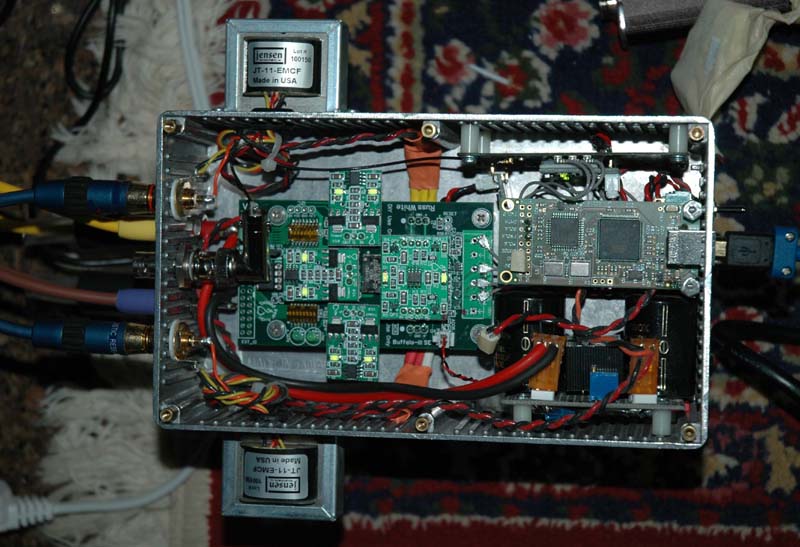

A member from vnav.vn used jensen JT-11-EMCF for Buffalo III SE, He wrote that he like jensen transformer more than IVY I/V in his system .
Best Regards .

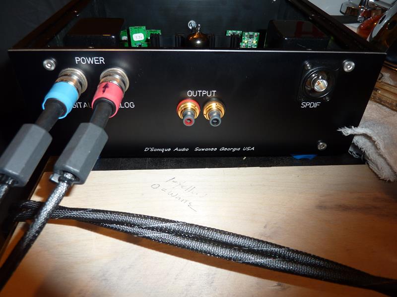

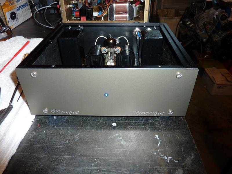

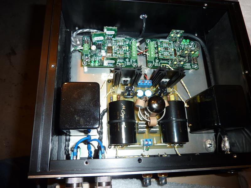

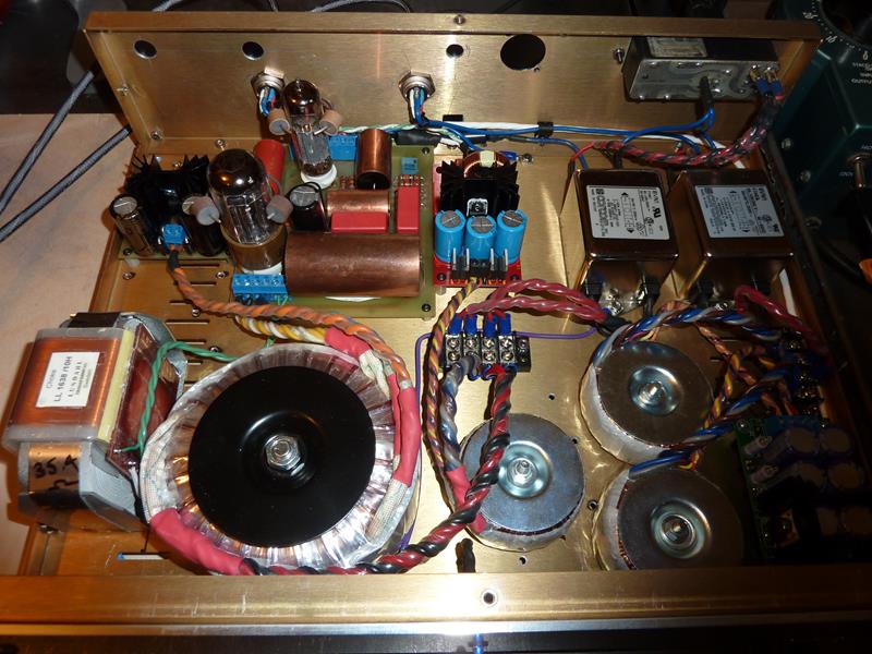

Been happily listening to my BII for over a year now. I'm using the Feastrex transformers. Audio Nirvana no regrets. Very minimal design. My own design tube output buffer and outboard separate digital and anaol power supply.
JD
