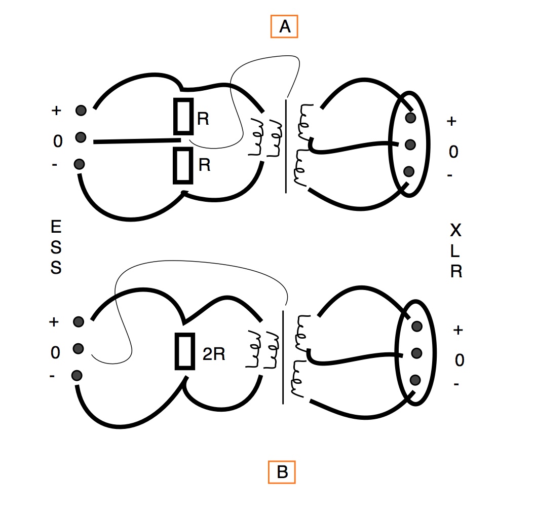

Q to Joe... The grounding of the middle-point of the 2 resistors R as oppose to use just one (2*R) resistor.. what gain is at hand here and whats the working of the earthing?
Several. For one thing, it gets rid of the 1.65V offset and means that it is easier to get rid of capacitors in the signal path. The offset voltage becomes and offset current of 2.1mA per phase. The other is the much lower Z. If you don't ground the midpoint, the termination impedance becomes the Z of the other phase, so you are no longer using the DAC in current mode.
BTW, you can certainly try both, but I suspect I know which you are going to like after listening. Sabre DAC sounds better in current mode, a more fully fleshed out balance and not lightweight as it sounds when in voltage mode.
Cheers, Joe
Thanks!
Just to be clear... is your description valid for the situations in the picture?
BR //
Looks about right.
Diagram A is correct as far as the way the ESS dac and resistors are connected to the transformer.
But you don't like whats going on at the secondary side?
I am not very familiar with balanced outputs but your connections don't look correct. Aren't you supposed to connect the secondaries in series and reference one pin on the XLR output connector to ground?
I am sure somebody here with more experience with balanced outputs will chip in.
I am not very familiar with balanced outputs but your connections don't look correct...
In fact, the centre of the secondary need not be grounded to chassis or even to Pin 1. In fact, it may well be advantageous NOT to ground it at all.
What then determines whether it is balanced is the receiving end. If the receiving end grounds the bottom (or one side) of the secondary, it then becomes unbalanced. On the other hand, if the input on the receiving end is truly balanced, then signal will appear on both Pin 2 and 3. But the signal that gets processed is the difference between Pin 2 and 3, and not with any reference to ground. The ground reference is not the reference to the signal and that is a good thing. Hence best not to ground the secondary at all.
The receiving ends sees the difference between Pin 2 and 3, that is all. Hence, perhaps the better description is that it is differential rather than balanced, since signals at Pin 2 and Pin 3 may not be exactly balanced or exactly the same amplitude anyway.

In the case of a balanced interconnect, the XLR pin #1 is not part of the audio circuit ground. The XLR pin #1 is only a shield and should be connected to the chassis very near the connector. Occasionally at the receive end of the cable, the shield is not connected at all or connected through a capacitor. But this modification should be done inside the cable connector not inside the chassis.
Yes, interconnect shield to chassis ground. The outputs of the transformer (signal) should not be referenced to ground.
