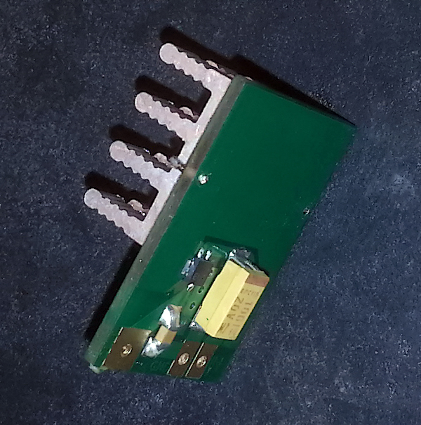

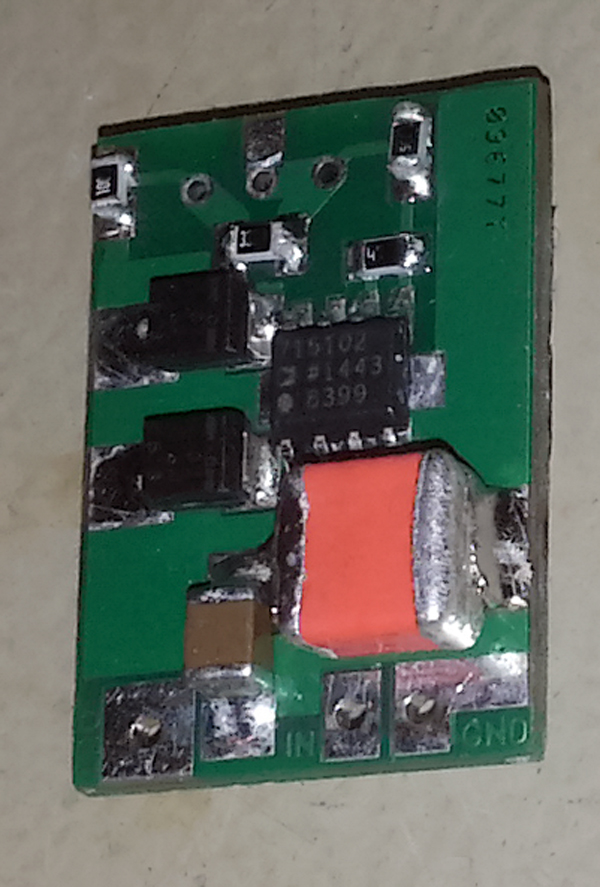

I have seen oscillations in other also "recommended" shunt regulators... I personally do not like to have regulators at such oscillations edge working domain. Think that the components get aged somehow, or it may modify its parameters with ambient temperature. Any small instability of the regulator circuits, can (uncontrolled) produce unexpected anomalies at any time...
ADM7151 is a very stable device, no any oscillations whatsoever on its whole working domain, and provide the lowest noise on marked right now...
It is my last choice... with excellent results.
These are my regulators....

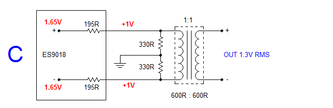

Hoping for some insight into my implementation of a transformer output for my buffalo III in stereo mode.
I read the 622 posts and it seems easy enough so I tried using a pair of Jensen JT-11P-1 transformers in place of the legato I have been using. First I hooked it directly to the dacs output and then tried the attached schematic. Same problem both ways. The music plays but there is a high frequency sort of pulse tone. Not sure where to go.
Thanks,
Evan
Just so I'm clear the two 330r resistors go to the dacs ground pin between the differential outputs.

Hello Evan,
I took a different approach and used a high primary inductance transformer (Lundahl LL1676) on the DAC output, with no ground connection on the primary side. With the high primary inductance there's no need to worry at all about the output impedance of the DAC. That feeds a DHT tube output stage. It sounds fantastic - highly detailed but not at all harsh.
Feel free to stop by and have a listen if you'd like to check it out.
Bob
Bob,
Thanks for Checking in. I used the Jensen transformers because I had them on hand. Ended up with 680r from each leg of the primary to ground. Any lower gave up too much gain in my system. No pramp here just a buffer.

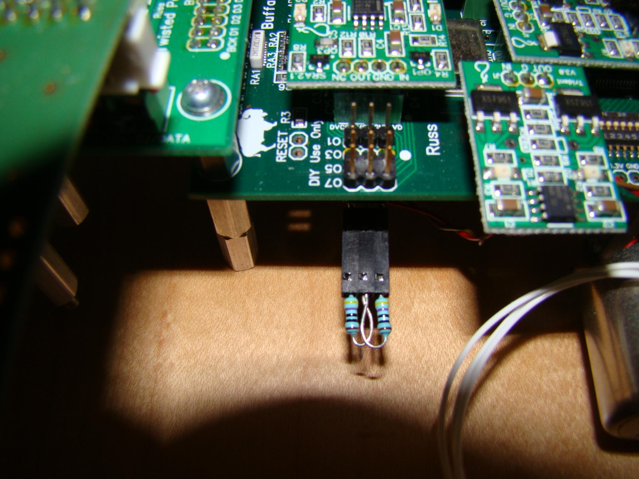

Turns out the hum problem was grounding. The whole dac system was floating...no connection to ground at all. Worked fine with the ivyIII as the output for the dac not so for the transformers as the output. I tied the dac power supply to ground and voila no hum at all. The output transformer secondaries are still not connected to ground. The sound going from active to passive changed a bit....but not much. Maybe a bit of distortion has crept in...sounds more direct. Much simpler this way. I doubt I'll go back.

I think the root of the hum was your ground connection on the primaries. Keep in mind that ground if not the mid-point between the +/- points of the DAC, since it is powered from a single rail. For that arrangement, I think you want AVCC/2 as a virtual ground, or use none at all. I suspect you will see some weirdness on a scope.
Brian,
I can scope before and after the transformers this week. Sorry for the poor photo. Hard to do in place. I used a right angle header under the board hooking the +- output of the DAC to the transformers. The resistors to ground can be plugged/unplugged easily enough. Subjectively grounding the power supply has worked. No noize-humm-buzz. The sound is very close to what it was running through the ivyIII.

To be honest, this confuses me a bit....was the whole point not to get really down in impedance to bring the DACs into current mode....and now 330R ? What for ? We are here in voltage mode, no ?
