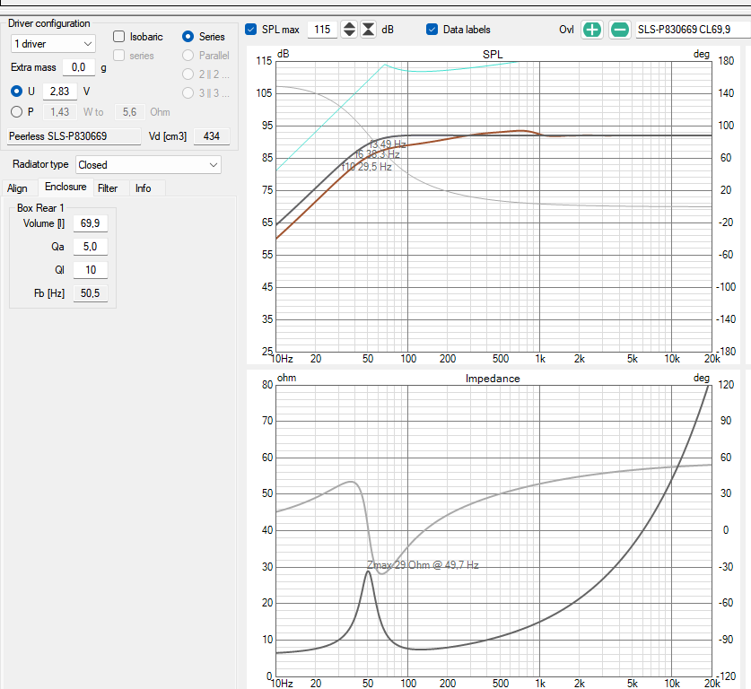

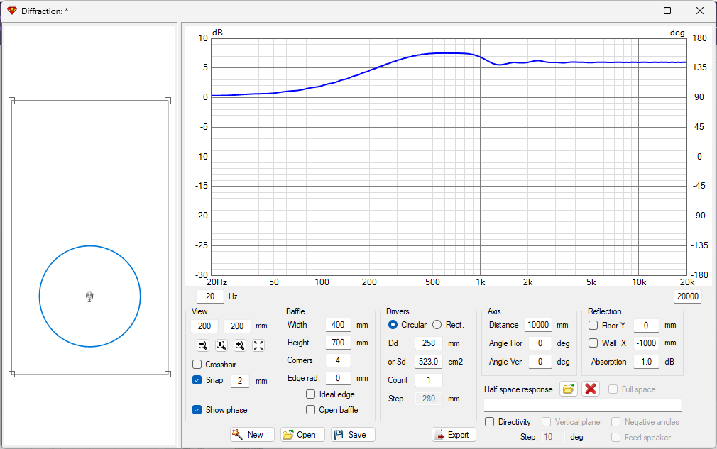

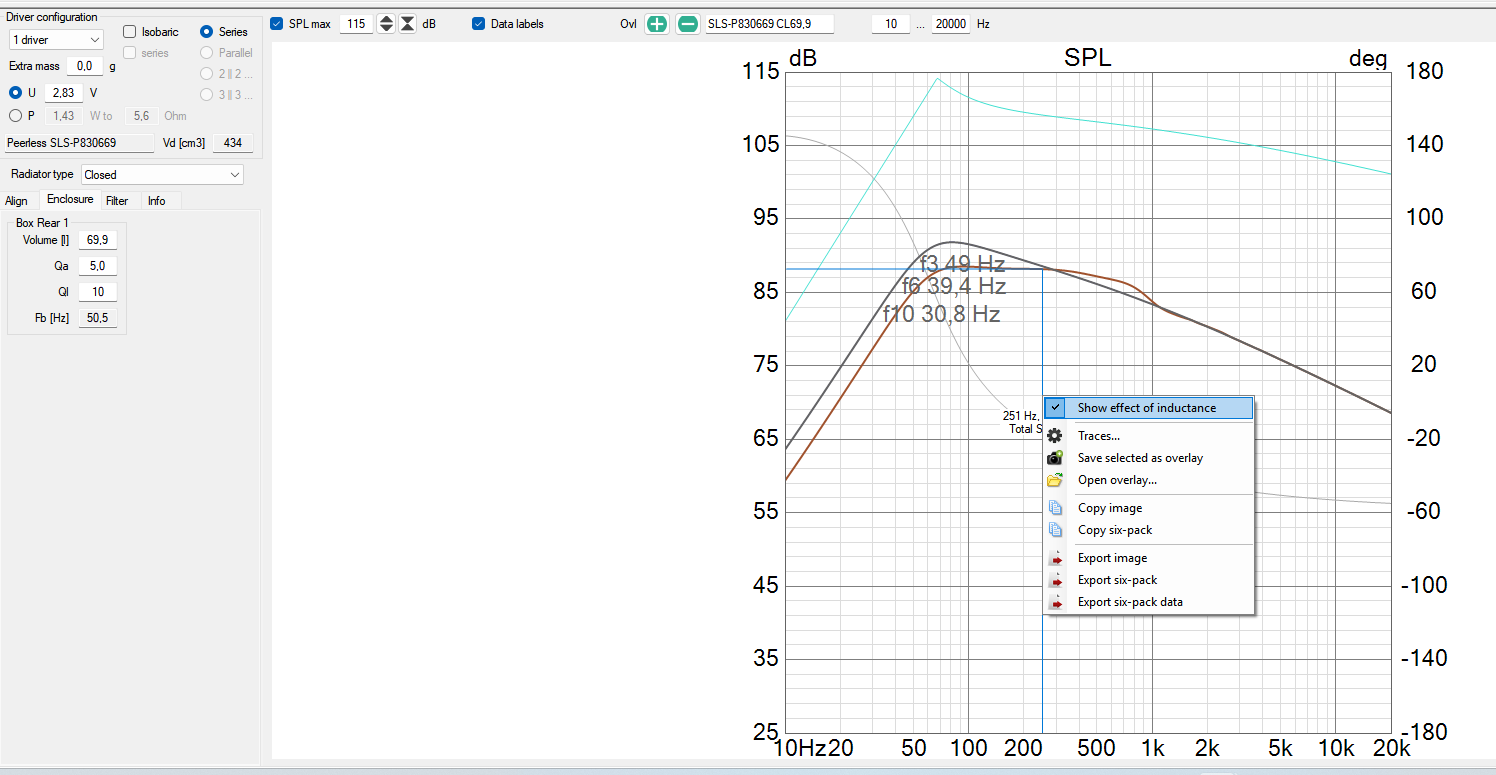

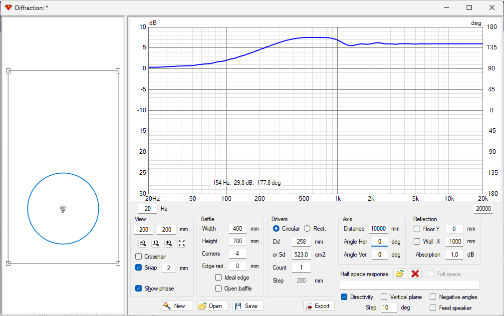

Okay, resistance is not futile, trues numbers even less, here 2 sim to illustrate my question (seems the SLS12 reacts better than the SB34RNXL to the "show effect of inductance" in Vituix option).
Which surprise me hence my questions is the F3/F6/F10 are moving up so less low end (2 Pi sim). With the SLS12 the option "effect of the inductance" move not too much the low end versus the SB34RNXL I made.

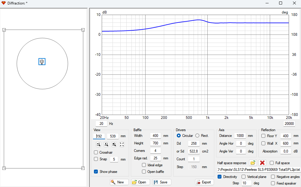

All is 2P w/o LP, brown difraction with F3/F6/F10 datas on screens . So behind 250 Hz (supposed to be the cross over cut off) remove -6 dB circa. so 83 dB sensivity at Pi 4 full space
Notice the parameters for the baffle and datas (distance of walls, etc).
How please, you guys do your sim from T&S ? With or W/O the "show effect of difraction" and how do you add still in the sims the effect of the coil inductance for the low pass at chosen crossover ? Do you need to swap into the filter making screen, so have measured your speaker already ?
Are those sims correct according to you ? (SLS12- Qtc 0.77 - 70 L w/o LP filter : F3 : 49 Hz F6 : 39 Hz - sensivity 4Pi at 100 Hz : 82.6 dB)
This is with the former datasheet, the new is said 2 dB less. Don't know which ones are on the shelves everywhere?!
So sensivity of mid around 250 Hz is around 2 to 3 dB loss after difraction, so minimum sensivity of the mid needed 85,6 dB/2.83V ? (more if resistor in serie or air coil with Dcr)) ?

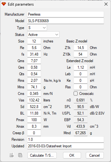

I always set the Z1k/10k in the T/S parameters
"Show effect of inductance" always checked
Qa = 5 (full stuffed) for closed box / Qa = 20 (stuffing only on the wall) for BR
Set the driver in the actual position on the baffle and export the diffraction responses at 10m for the low freq. part and at 1m for the high freq. part.

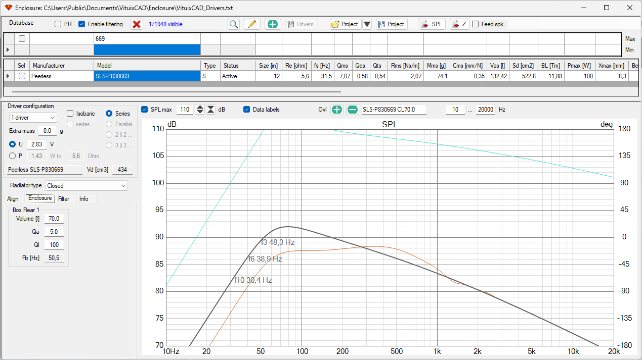

You should get something like this
STATISTICS
f3 48,3 Hz
f6 38,9 Hz
f10 30,4 Hz
Zmin 5,9 Ohm @ 5 Hz
Zmax 34,3 Ohm @ 50,4 Hz
GDmax 5,7 ms @ 47,6 Hz
XmaxC 1,1 mm @ 5 Hz
Pmax 1,4 VA @ 5 Hz
DRIVER: Peerless SLS-P830669, 1 pcs in series
n0 0,69 % Reference efficiency
SPL 90,5 dB/W Sensitivity
USPL 92,1 dB/2.83 Sensitivity
EBP 54,3 Efficiency bandwidth product
Dd 25,8 cm Effective diameter of driver
Vd 433,9 cm^3 Maximum linear volume of displacement
Cas 9,43E-7 m^5/N Acoustic equivalent of Cms
Mas 2,71E1 kg/m^4 Acoustic equivalent of Mms+Mme
Ras 7,57E2 Ns/m^5 Acoustic equivalent of Rms
Rae 9,22E3 Ns/m^5 Acoustic equivalent of Re
BOX REAR 1: Vb=84,8 l, Ql=100,0
Fb 50,5 Hz System resonance frequency
Cab 6E-7 m^5/N Acoustic compliance of air in enclosure
Rab 1,05E3 Ns/m^5 Acoustic resistance due to absorption
Ral 5,25E5 Ns/m^5 Acoustic resistance due to leakage
Qtc 0,75 Total Q factor

thanks. So it gives also a tip to add the effect of a 6dB serie low pass inductor if we cheat with the 1K windows... Cool ! At least an aproximation.
You setuped the distance at 10 meters (10 000 mm) ? What is the 1 dB absorption in the low end ? But 10 meters, should we put here instead the max deepness of the listening room ?
I simmed at 0.60 meters from the front wall (with the front baffle assuming the deepness of the cabinet not being more than 40 cm )!
Ah, I layouted the woofer at the wrong heigth for the project...
I will try to make a spl file made from the sim of difraction to make an artificial filter from those datas to see how react the low pass of a 12 dB or more for that woofer.
