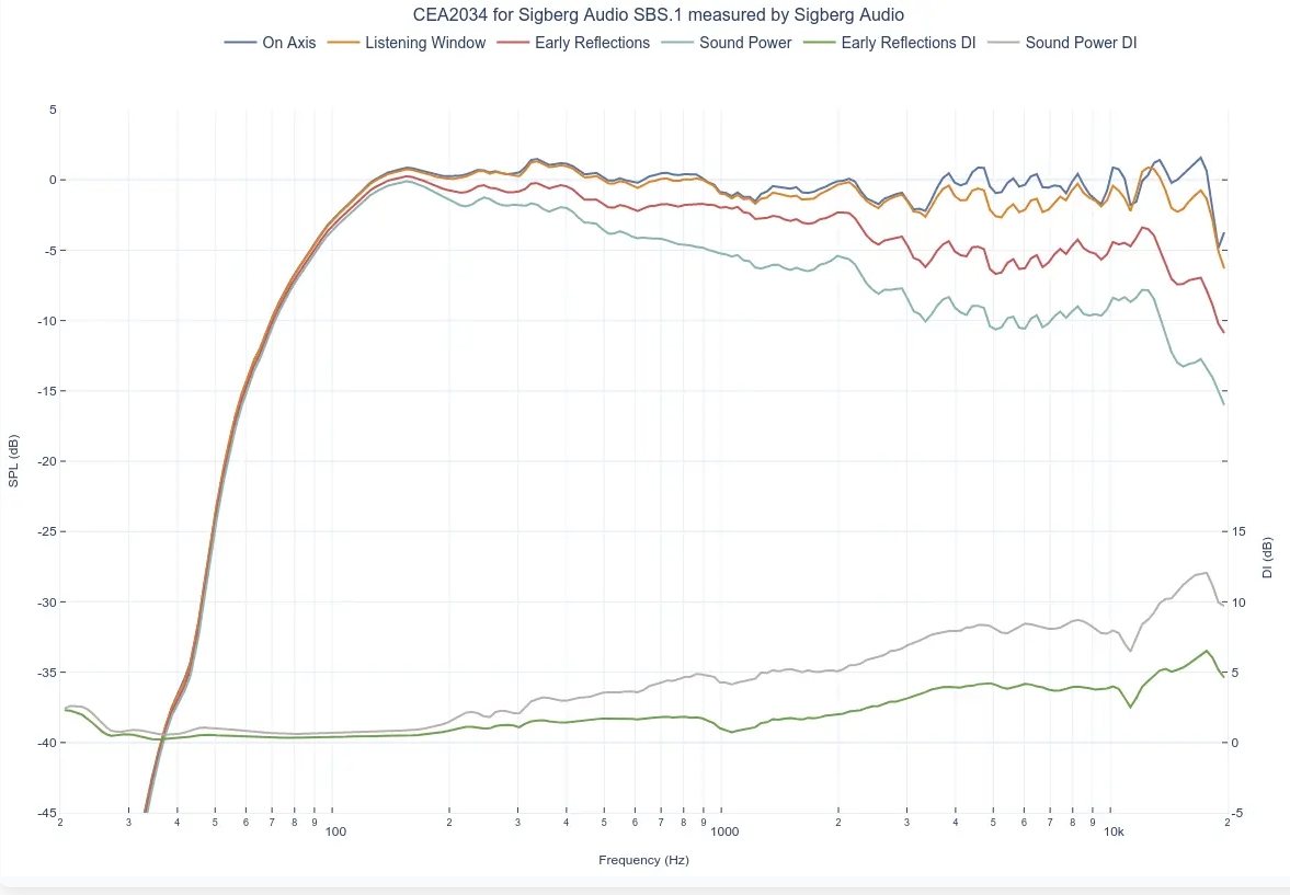

In case you didn't use this before, as pointed out earlier in this thread, the document written by Kimmosto shared in this earlier post is incredibly helpful in the sound balancing process. Especially useful are the general slope recommendations for each of those curves in the spinorama plot:

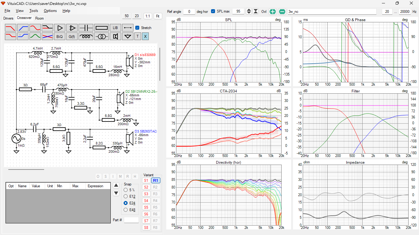

The sim is derived from the Gema kit: baffle and coordinates are the same, I just replaced the sb34 with the SLS and reduced the volume of the mid cabinet to 1.2L.
Marmite??? Please explain, do you mean that the nrx series sound just like this...
It appears as if Z-axis was not accounted for.
It's just a simulation to see if everything could work well. Generally, I assume that the drivers are measured in the same way, especially if the manufacturer is the same, and that should include the time of flying from the driver to the mic.

The high-value inductor is needed to compensate the low-frequency impedance peak that would otherwise interfere with the low-pass. Take another look at the circuit.

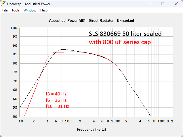

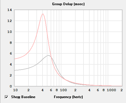

I was thinking about what seems to be th t-bass technic.
Thread 'Open Baffle Bass Boost: +4 to +7dB w/ Passive Xover, No DSP' https://www.diyaudio.com/community/...boost-4-to-7db-w-passive-xover-no-dsp.404171/
It seems some people have done this in sealed enclosure too.

In my own recent, still learning from experience, trials... a 500Hz bump in response, which guessing often from baffle/diffraction effect, gives annoying slappy upper bass sound. Take it away and sounds golden, cleaner. Regardless, this thread has been been very informative with nuggets of wisdom.
still there at 3 meters in a living room ?

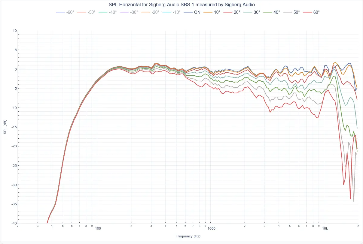

The way that high frequency directivity rises makes me wonder how a coaxial would perform on the monkey casket. SICA 5,5 C 1,5 CP. SICA has a tweeter/mid crossover premade for it and it's pretty inexpensive compared to a Scan-Speak/SB Acoustics mid/tweeter combo.
The original monkey makers used tweeter over mid but if they had modern tech coaxials would they have gone that route instead to get the free waveguide? (if real waveguides are restricted on this project)

Funny I has the same idea with Sica coax this morning 🙂 My choice will be 6,5" to match 12" better. Imho good fit to sls12 with bucking magnet. My concern is consistency - had few of them in my hands and some had different polepiece, some had not so good tweeter to cone area, ...

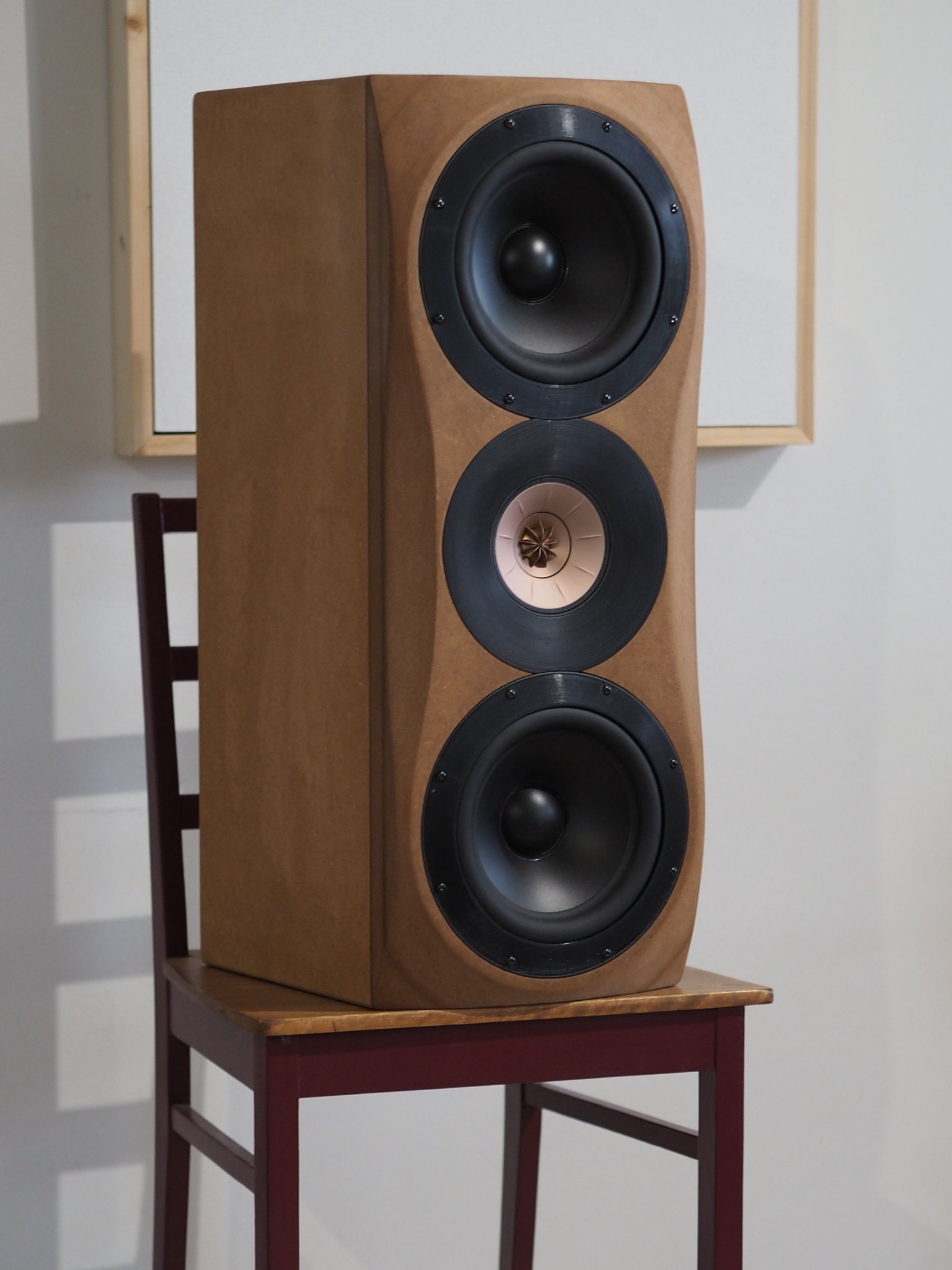

My approach with a Sica 5.5inch coax/6.5inch coax/another suitable coax for a given budget would be to have dual 8ish inch woofers helping with bottom end and the coax itself either with cardioid side/front vents (only for the mids and not the bass) or even without cardioid vents (just for simplicity of design). A shaped baffle around the coax would help with some amount of proper "termination" of the waveguide formed by the coax mid driver for the tweeter. Another optimization could be to properly dimension the width and depth of the speaker for overall directivity goals. In short my idea of that project would look like the speaker shown in MrStitcha's excellent thread with the KEF coax replaced by another suitable and available coax.
It would look nicer (to me), can have relatively higher sensitivity and maybe other benefits in terms "looks of those performance graphs". Maybe it can even be put on its side and called a center speaker in a multichannel set up if one needs to do something like that 🙂
Given the expertise that we have on this forum and the technology available these days in terms of simulations and manufacturing these kind of cabinets, I think it is definitely doable and more exciting (for me atleast).
