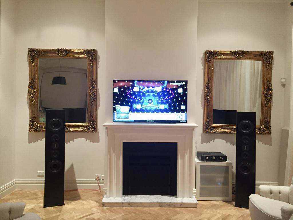

Here's the house I lived in 10 years ago:
For reference that is a 55" diagonal OLED TV and amplifier standard 19" wide unit.
So the room is 6m wide (20ft) (what you see) and 9m (30ft) deep and ceiling 3.2m (11ft) tall.
That is the Statements II by @jholtz and Curt Campbell;
designed for "Optimum from the wall behind the speakers is 18" - 36". The next sensitivity is 87-88dB / 2.83V

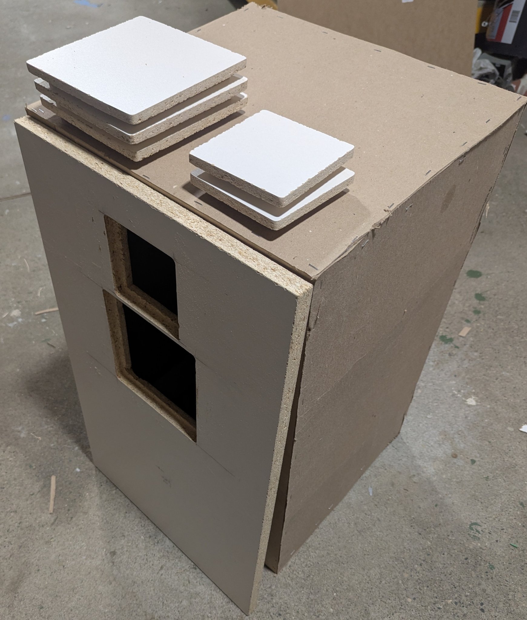

I built a mock-up cabinet out of scrap mdf, some Ram Board (cardboard floor covering for construction work) and some melamine cabinet board for the baffle. But, somehow, of the dozens of router bits I have, I didn't have a 1/4-inch spiral cutting bit. So I'll take some measurements of some 4 and 5 inch midranges and tweeters that I have on hand by the end of the weekend, in a box that is pretty close to what we will end up with. (This isn't a sealed box to take real measurements in, just something to get an idea of how some midranges and tweeters measure on- and off-axis on a 16" wide baffle)

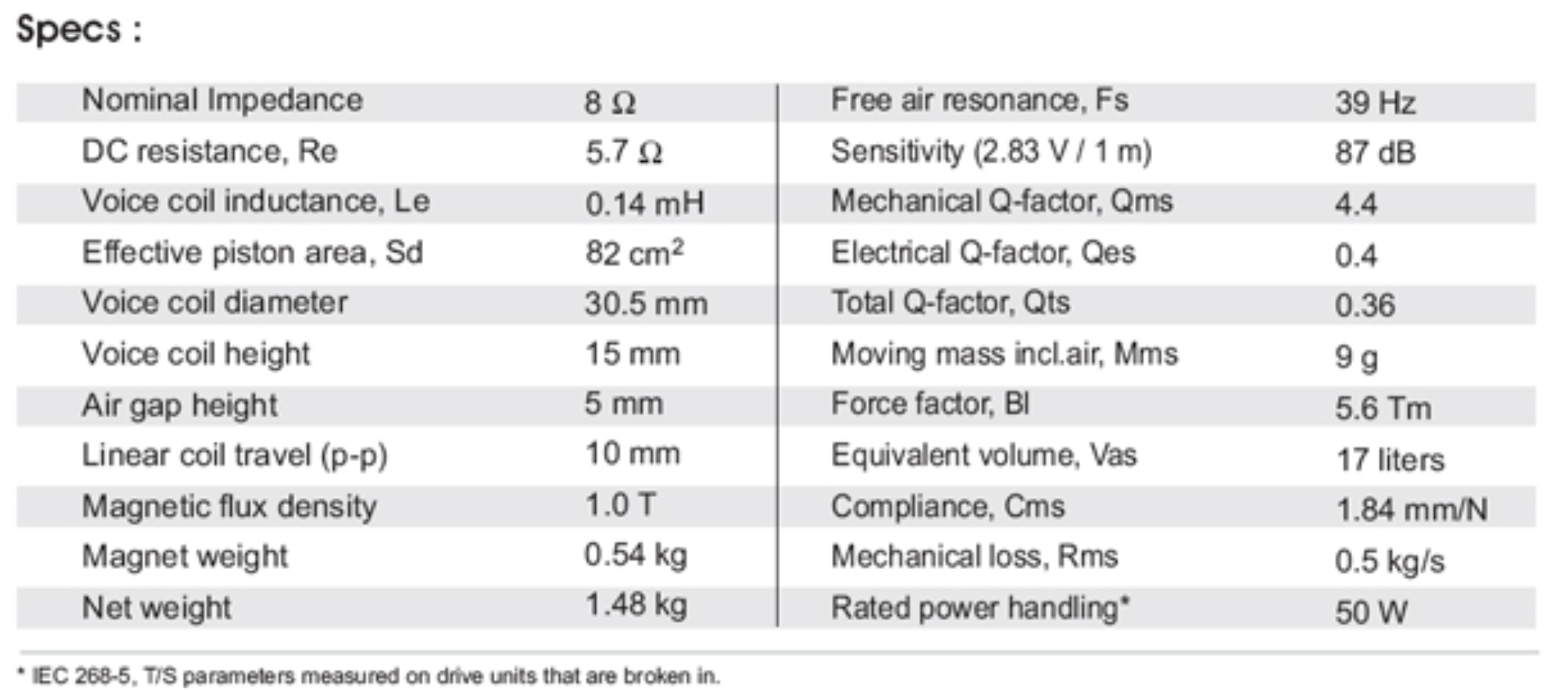

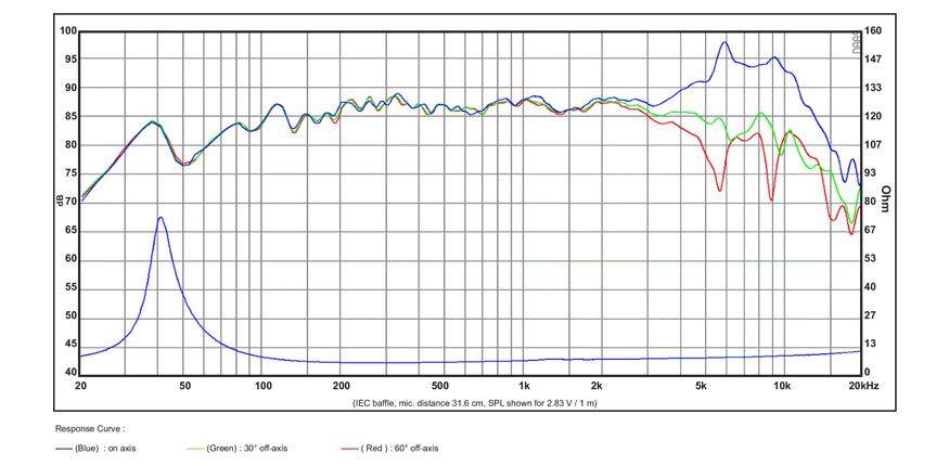

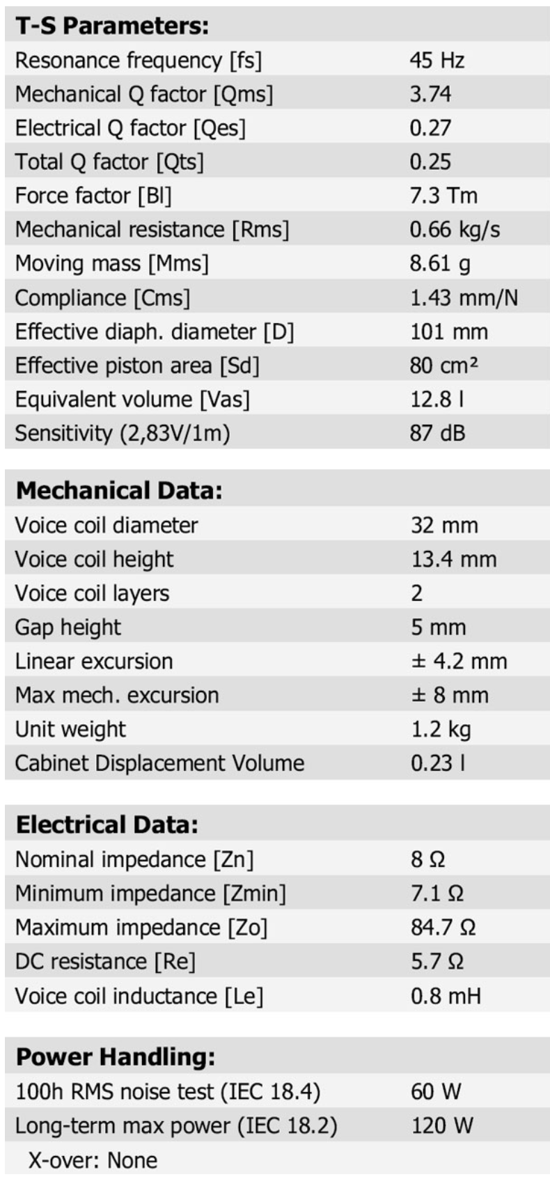

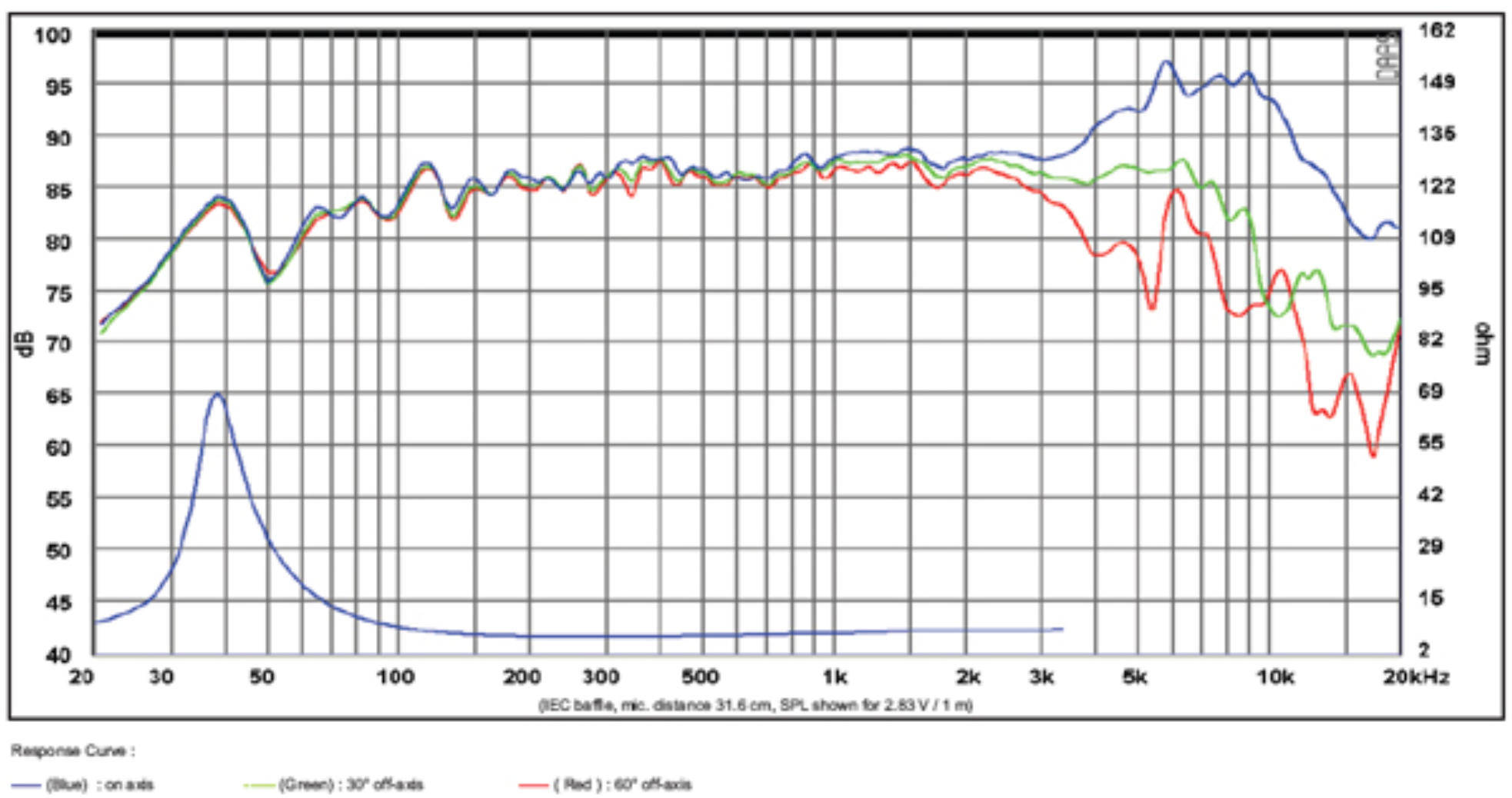

For discussion...looking at the SPL curve, impedance, and TS parameters of the Scanspeak 15W/8434G00 and the SB Acoustics SB15MFC30-8, what are the pros and cons of each? While the SB15MFC is $16 cheaper than the Scanspeak in the US, they are almost exactly the same price in the US. The SB15MFC may take an extra inductor on the low-pass to bring down the broader and higher cone breakup.
15W/8434G00
SB15MFC30-8
15W/8434G00
SB15MFC30-8

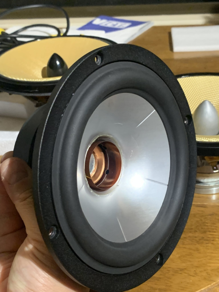

All SB15/17 share the same 100mm diameter magnet with the raised copper cap
(in SB literature “extended copper sleeve on pole piece for low inductance and low distortion”)
Here is an example of a SB17NAC to see the copper cap:
This is responsible for the lower voice coil inductance, lower H3 and H5 in the midrange than one without the copper cap. The clue is in the extended and flat impedance curve all the way to 20KHz:
The bottom blue trace extends to 20KHz, and is well under 13 ohms there.
Compare that to the 15W/8534G00, which at 20Khz is above 32 ohms, as shown in @A4eaudio previous post.
The 15W/8534G00 has a single alu ring, acting as a demodulation ring.
To get a Scan-Speak Discover product with a copper cap, a user has to step up to a driver with the Symmetric Drive motor. OEM can order a custom Discover product with a copper cap, but that needs a considerable MOQ.
Reference: Decoding Scan-Speak model numbers
An alu ring as a demodulation device , will have higher H3 than H2, particularly around the 300Hz-1000Hz range, on a static exponential sine sweep. As higher voltage drive levels on an sine sweep, H2 will rise faster than H3. And thus the relative proportion will change such that H2 and H3 are at similar amounts.
A driver with a copper cap will tend to show H3 lower than H2 AT ALL drive levels.

I will second Zvu's preference for the ScanSpeak vs the SB. The SB is better if you are building a small 2-way because it has more solid bass and can go louder before audible distress in that format. But they can be a bit recessed compared to other competitors in this price range. For a dedicated mid the ScanSpeak Discovery line are very good, clear, open. They get stressed easier than competitors but I don't think that will be an issue as a mid.
SB measures significantly better.

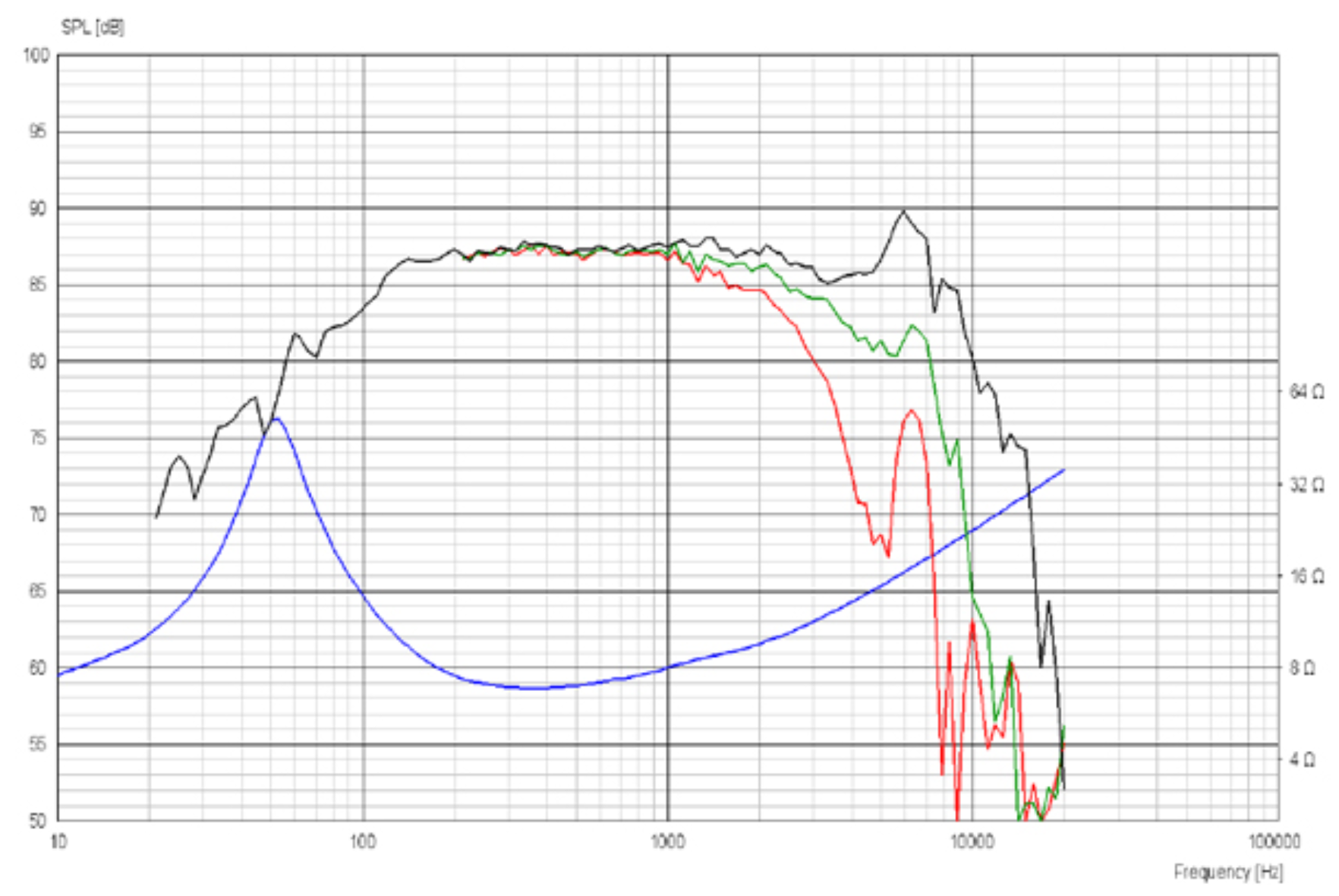

Are we looking at the same drivers ? SB measures worse in my opinion. It's frequency response has 10dB resonance at breakup and resonance dip at 1500Hz, unlike SS. Scan Speak has much cleaner CSD and even THD looks lower under same conditions (dibirama).
Scan Speak 15W8434
SBacoustics SB15MFC35-8
I linked 8 ohm Scan Speak so things would be comparable. If we could get some higher resolution measurements, such are at Hificimpass, that would be great.

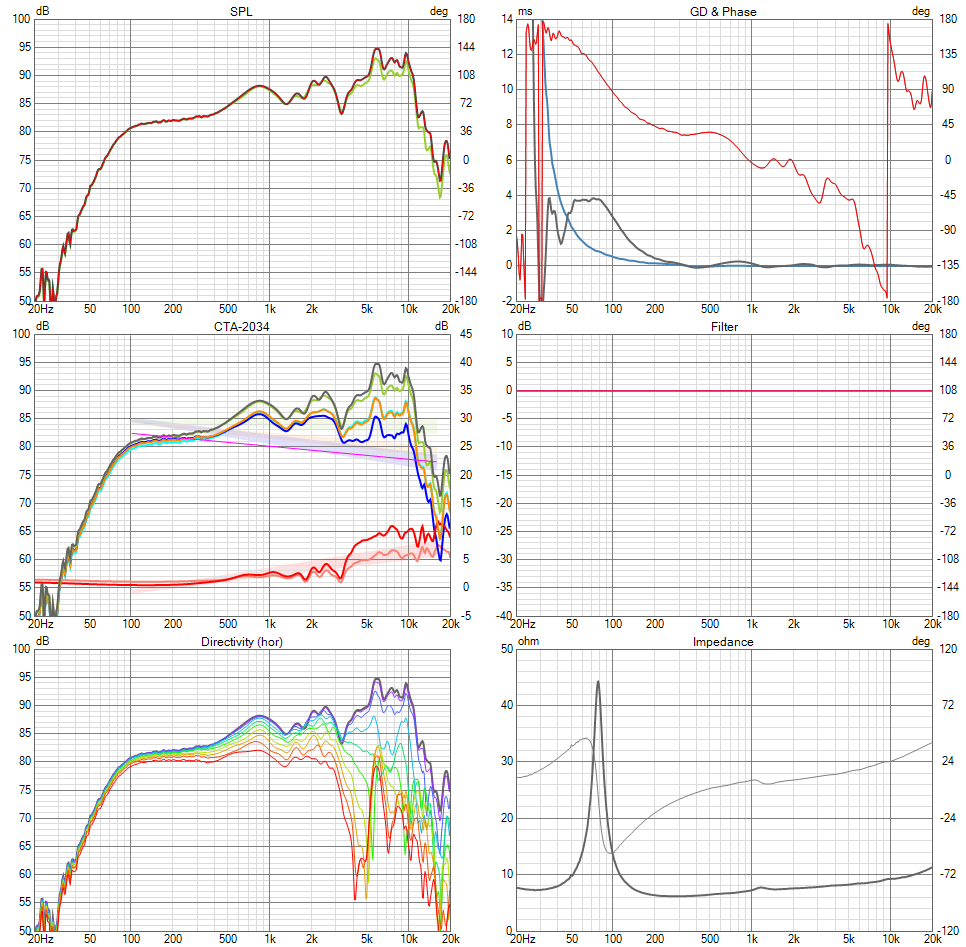

Here is a measurement of SB15 MFC-08, in a 9 L closed box.
Front baffle 20 x 29 cm , radiused vertical edges with r=20 mm
1000 mm measured distance. 0 to 90 deg horizontal. Merged near + far field , baffle-step compensated. No smoothing.
