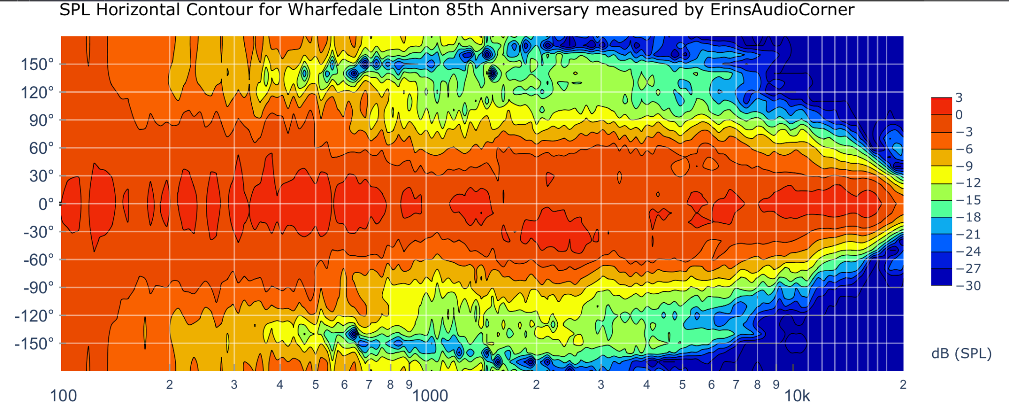

The directivity is quite good:

When I linked Wharfedale Lintons, discussion was about directivity smoothness in mid-tweeter xo. It has more axial spl where DI is high, which is the old school way to balance the farfield/room response. Lintons have only 8" woofer, but this project has 12" so please don't do direct comparison over price/cost.
In seventies many passive 3-way speakers had adjustment for woofer and tweeter spl (stepped resistors), to adapt placement in the room. BR speakers can use vent plugs to tame bass. Also amplifiers had tone controls, even a loudness switch and they were used without shame.
IMO a sealed 12" hifi-speaker should not have full BSC (for flat 4pi response). In a normal room and placement on a short stand near the wall 2-3dB compensation is best compromise and the extended low bass with low GD will give the oomph and bottom that the listener expects from a large woofer. This also gives higher system sensitivity. Race for best looking anechoic/CEA curves should not be the goal, but "performance" and tonality in typical listening conditions.
