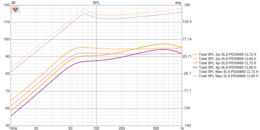

I would have chosen twin 10" 830668 which is both higher in sensitivity, more output and needs a lower box than a single 830669. But that it an different (slimmer floor-stander speaker, with higher SPL)

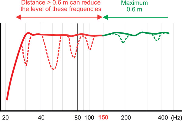

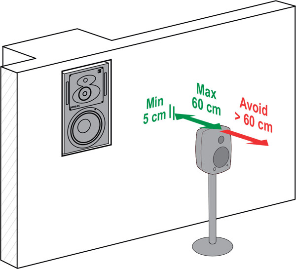

Reference: placement of (full range) speakers

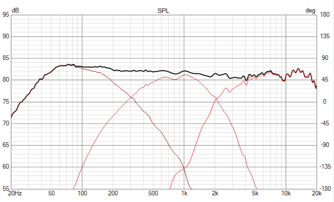

In my view, crossover design may be the easiest part of this whole attempt as it just takes a couple/few hours with VituixCAD to create one/some versions that generate good-looking plots and sound good if drivers are sensibly selected based on power handling/max SPL/cabinet size-shape/directivity requirements.

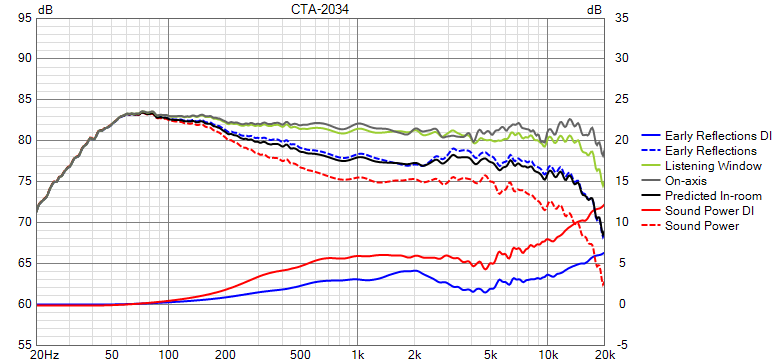

Let's assume that we want a smooth Directivity Index through the M-T crossover region, basically from 1k - 6k. By "smooth" I mean a DI which is either flat or consistently rising, and which has minor peaks/dips which are less than 1/3 octave wide.

... and on the other hand, maybe we don't care about DI curve performance? The designers of the original 1960 - 1980 "monkey coffins" obviously did not concern themselves with this.
Speaking only for myself, I care about directivity performance and how we can IMPROVE those classic "monkey coffins'. Which is one reason I have said that I will measure a version with/and without a waveguide.

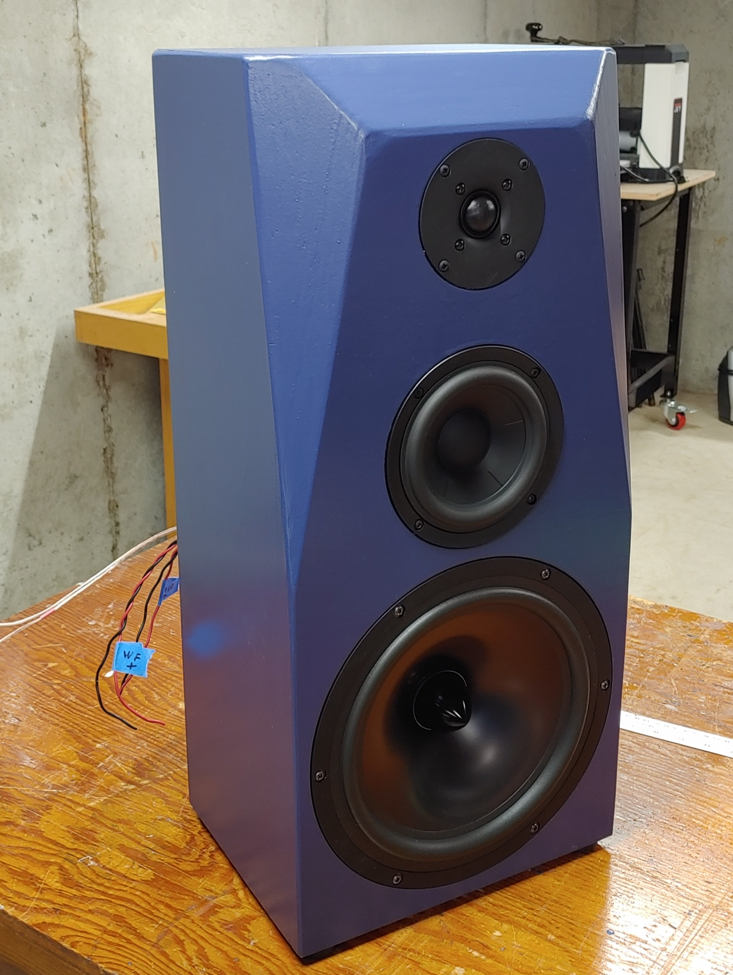

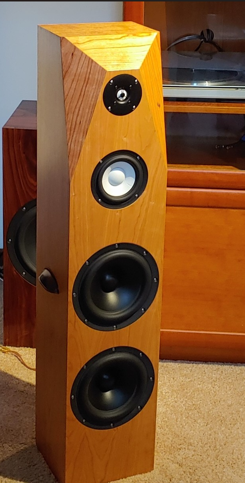

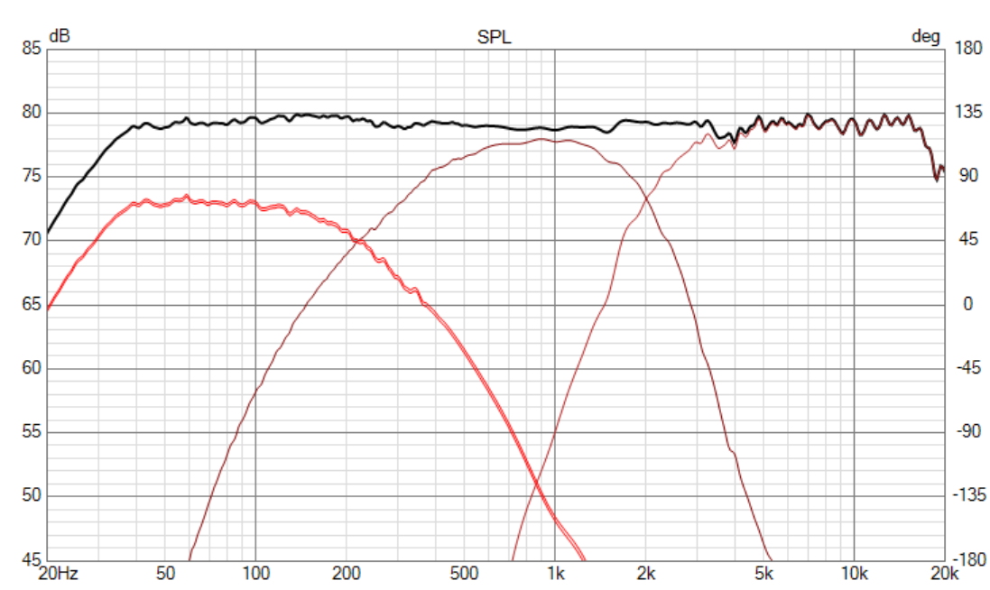

First example: SB15CAC30 in a 3-way active speaker, two 8" woofers, and SB26CDC tweeter.
The DI performance is very nice. I experimented with voicing in the 3k - 6k region, and in my room, this the voicing that sounded best... despite the PIR curve which rises a bit in this region.

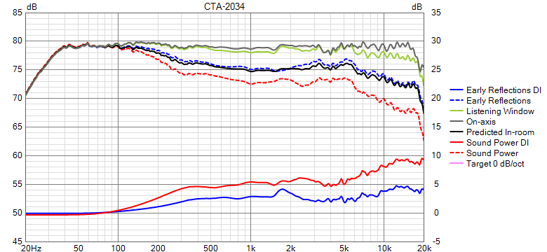

Second example: SB15NBAC30 in a semi-active speaker with passive crossover from mid to tweeter (SB26STAC) and active crossover to Dayton RS270 woofer.
The DI curve is again very nice. This speaker is used in a different room, and I voiced it to have a little more bass below 200 Hz. Here again I experimented with making the PIR curve flat from 2k-7k, but it sounded, well, a little flat. This is the final voicing.
A 5" driver can be crossed to a 1" dome at 2k with good directivity performance... BUT, the baffle area around the tweeter needs to be shaped to minimize baffle gain, and the CtC spacing between the mid and tweeter needs to be optimized, even if it makes the speaker look strange.

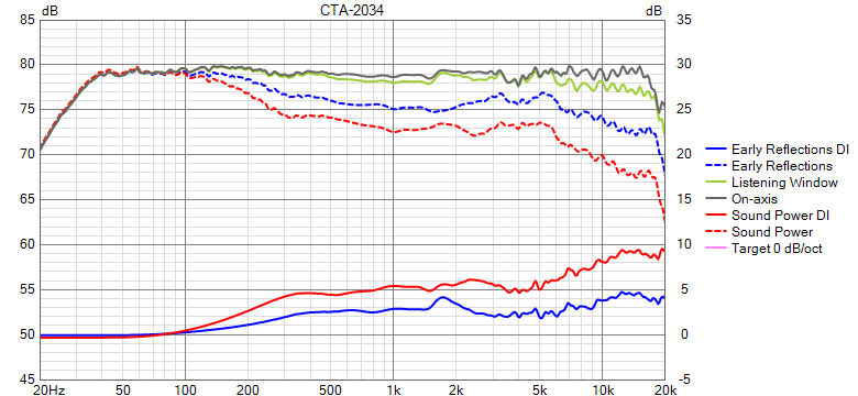

And all of this directivity focus may not matter that much in real application... I have another speaker that I use in my main system which has a 4 dB dip/peak in the directivity index. With careful voicing, and proper placement, it sounds excellent, better in fact than the two systems I showed above.

If you sim the optimal LW, PIR, DI, etc. taking as given the drivers and baffle, then by definition any change you make in the voicing process to actually make the speaker SOUND better will make the squiggly lines LOOK worse. I'll take a better sounding speaker over better looking squiggly lines any day.

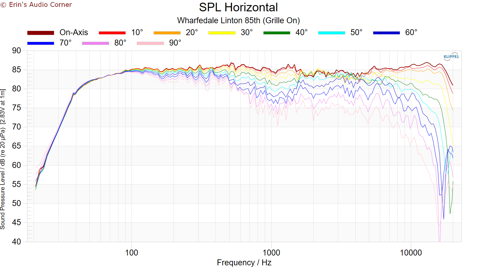

https://www.erinsaudiocorner.com/loudspeakers/wharfedale_linton_85/
  • This is truthfully one of my favorite speakers so far. On sight, I half expected this speaker to sound quite colored and have resonances; an experience I had with the Klipsch Heresy IV. However, my subjective listening experience was the complete opposite. For the first time in a while I found myself going through an extensive number of songs and just enjoying the music. There were no “standouts” that bothered me and pulled me “out of my element”. Even upon additional listening sessions I continued to find myself more and more happy with the sound from the Lintons.
So, don't be osessed with directivity slope alone ...
