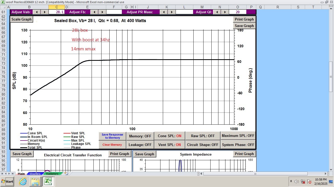

To sum up a possible design.
Mid fourties f3 if ported
High fifties f3 and low Q if sealed
Much smaller box is also an option for sealed.
82dB sensitivity ( Typical of many 6.5" 2-ways. )
Strong output with 65w. Nowhere near x-max at that power.
35L volume for woofer
60L volume total
$20 mid
$40 tweeter
Approximately $660 for a pair. (Drivers, and x-over. )

Too high. Need to get F3 below 50Hz unless it's a powerful driver with high XmaX and DSP is available. Not good if passive, and that is the end goal.High fifties f3 and low Q if sealed
My room has boost around 50hz. My sealed 15" sub has an f3 around 53hz. I feel LFE in movies. No EQ, just a low-pass from the AVR.
I think I could make a passive x-over for it. It does look challenging. That's one reason I wish I could buy it today. It wouldn't take long to know.
If anyone here can trace the frd, and zma files, we could find out if it's practical.

Is this enough bass with some boost? Typo on the jpeg. That's at 14mm excursion. X-max is 15.3mm. Rated power is 300w, but you get the idea. It's versatile. And this sim is in a 1 cu-ft box.Too high. Need to get F3 below 50Hz unless it's a powerful driver with high XmaX and DSP is available. Not good if passive, and that is the end goal.
