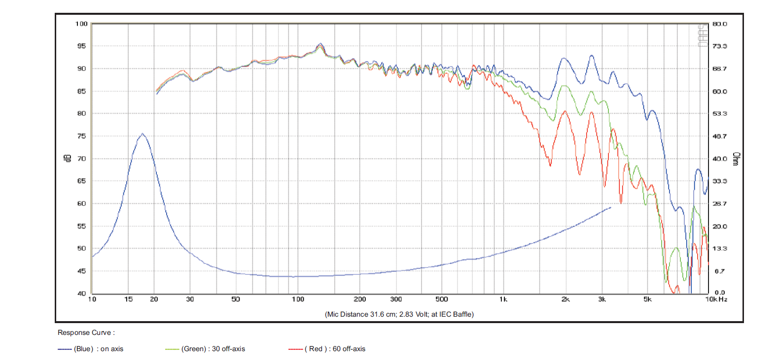

From the SB34NRX75-6 spec sheet. This is 2.83V at 31.6 cm (that is a rather odd distance). A rough calculation to convert it to 1 m results in about 90 dB sensitivity at 100 Hz. That seems reasonable based on my measurements.
On their website they have made it more clear about the measurement conditions. SPL presented was already converted to 1m.
Old datasheet has it different.

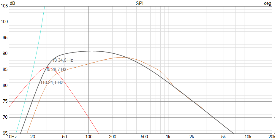

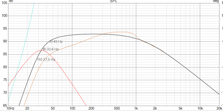

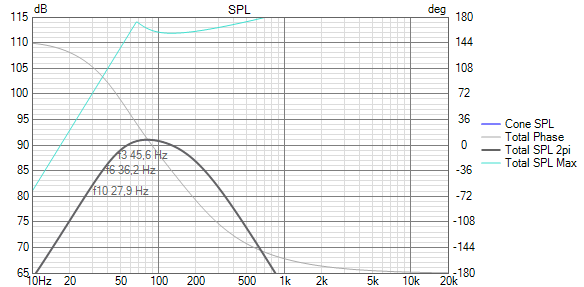

SB34NRX75-6 / 70L closed, Qtc 0.69 (Blue line is Jim NF measurement)

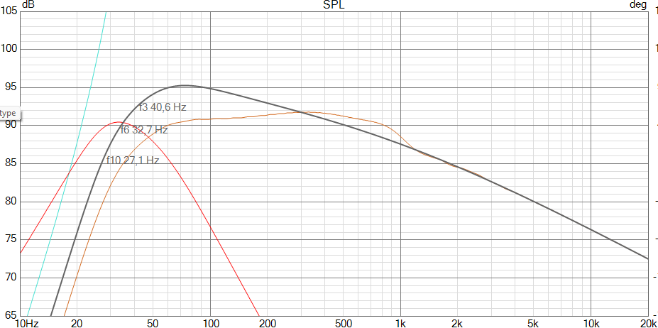

Faital Pro 12RS430 / BR 70L @ 33hz
Faital Pro 12FE330 / BR 120L @ 35Hz

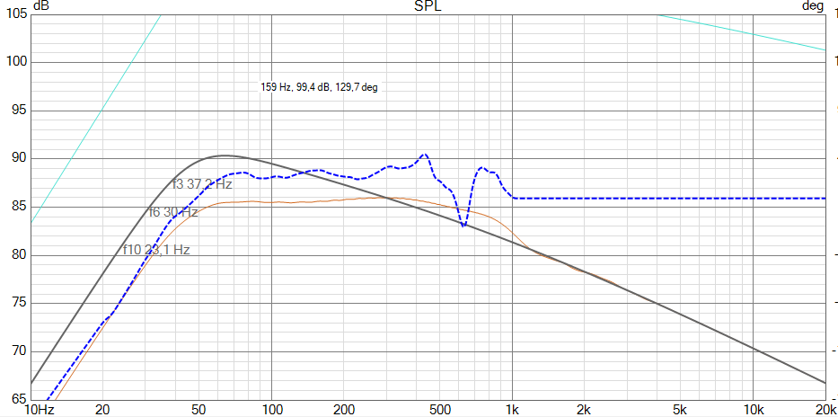

LaVoce SSF122.50L-8 BR 65L @ 40 hz

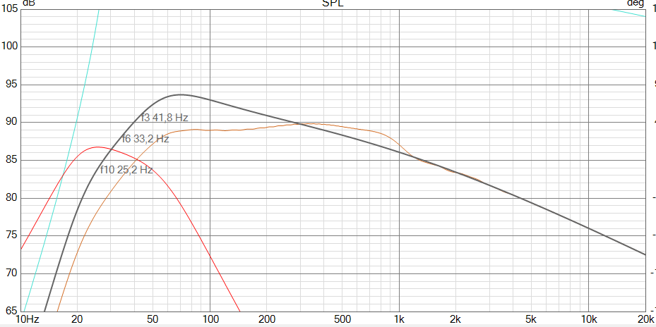

Dayton DC300 / BR 80L @ 30Hz

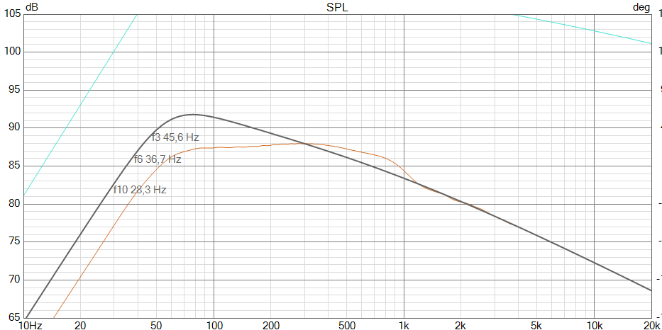

Peerless SLS-P830669 / 90L closed, Qtc 0.72
Beyma 12BR70 / BR 100L @ 30Hz

Here the SLS with a 12 dB low pass filter in spite of a 6 dB, Qtc 0.78; minor leaks, heavy stuffed/sealed : 67 liters. the 100 dB in reality should be around 88 dB.
