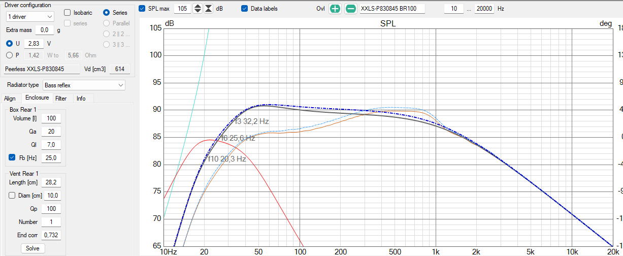

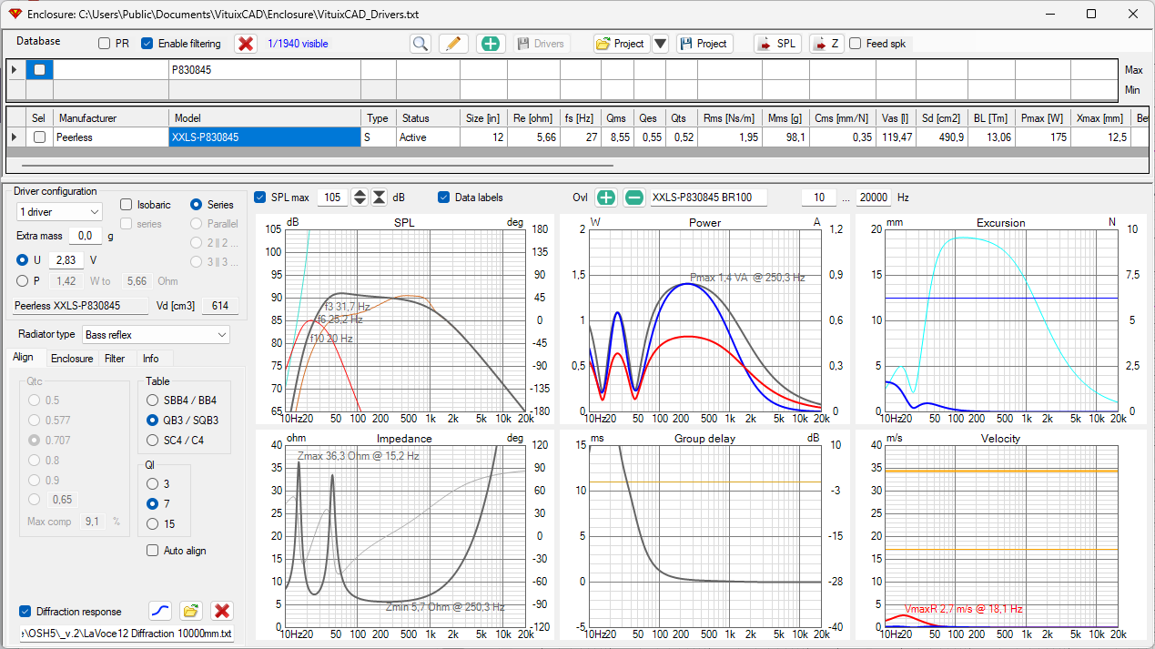

This includes a 0.5R DCR. Qts is high for a BR alignment, hence the big volume.Did you include some resistance from the x-over? I simmed it, and was hoping for a small box, and didn't look closely at anything over 60L that day.

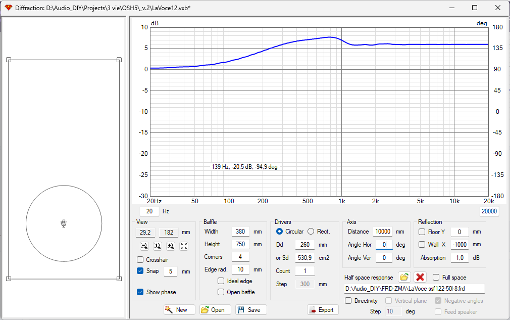

how do you setup in Vcad the 4pi option for the sim please ?
First you simulate the woofer+box in the enclosure tool. This is a 2-pi response. Then you export that response as a *.frd or *.txt file using the "SPL" button at the top.
Next you open the diffraction tool, and import that same response file. In the lower right corner there is a button called "half space response". click this button and you will be prompted to enter the path to the response file. After you enter it, be sure to click the "full space button". Now you can use the diffraction tool as normal.

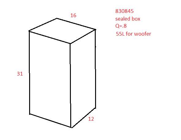

I like the idea of a sealed box that is not quite so large. This sketch shows such a box for the Peerless, and a Q of .8. There is some volume for bracing, and the mid included. This would be the overall outside dimensions. Drawing is not to scale

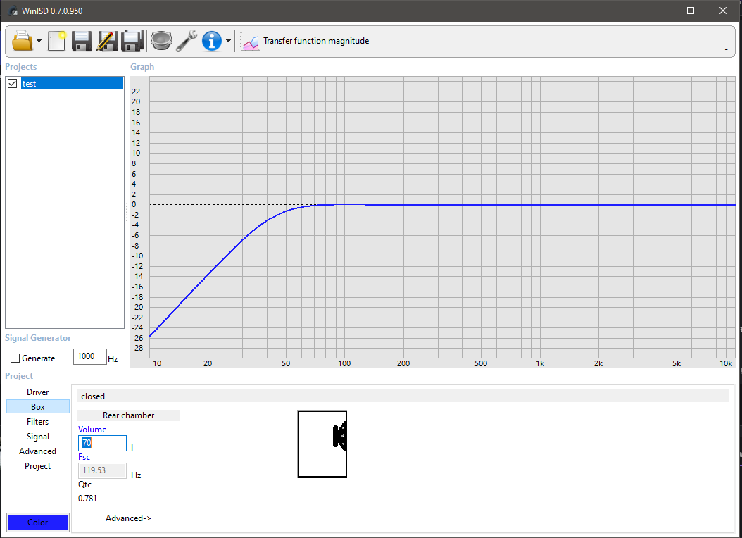

This is a basic sim of the SB34NRX75-6 sealed with filling (half filled with damping material) in a 70L F3 is arround 40hz, F6 arround 30hz.
you can make this a bit smaller without much change, 50L looks very similar on response but with a Q of 0.867. the only disadvantage is the price that is maybe a bit to much for a budget build.
