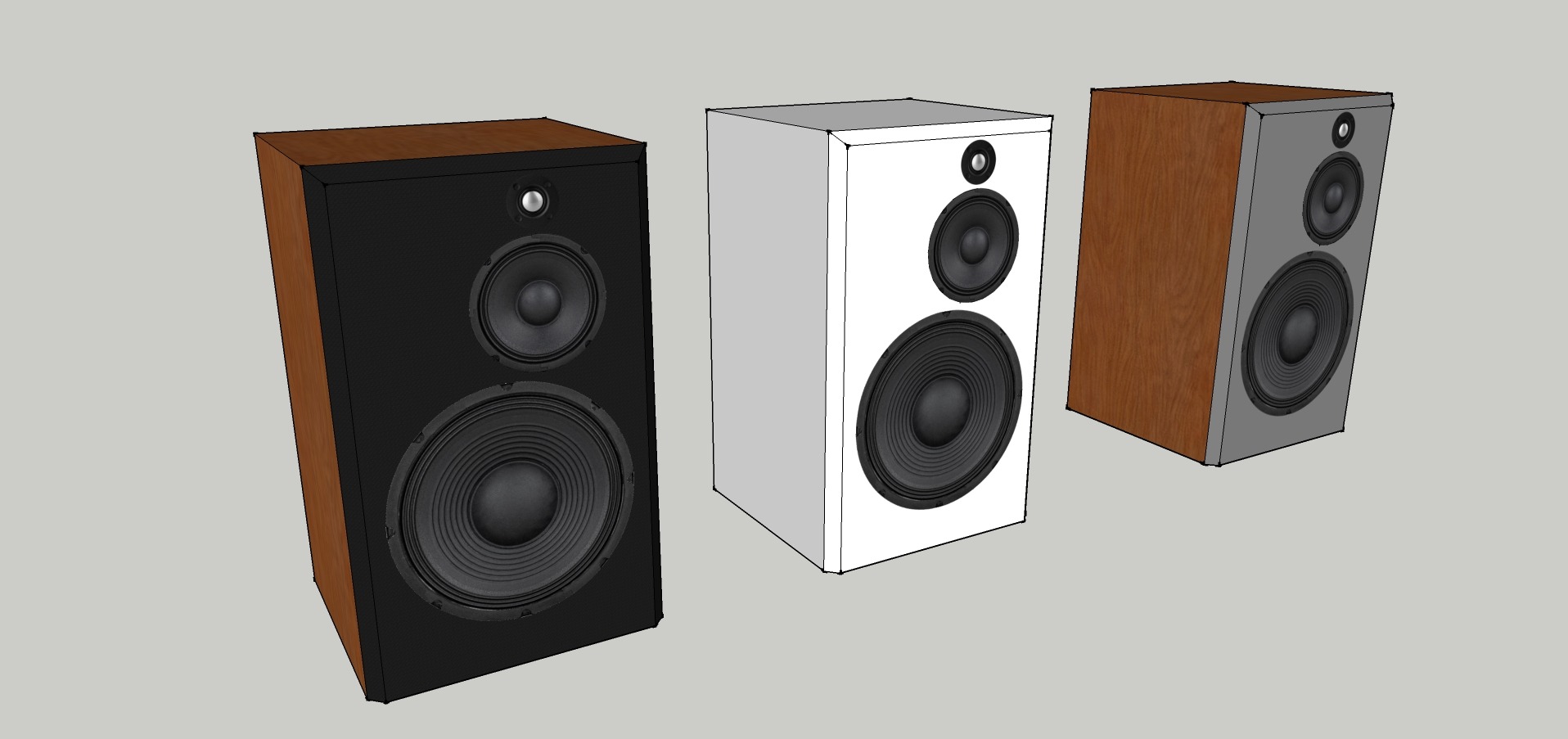

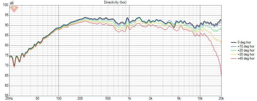

the system would be a small (L100 size) reflex with woofer to midrange having good poer handling and hopefully a clear midrange, I'm having a lot of pain issues but wrose, sision issues so cannot see my monitor well (looks washed out to the point that light graphs in hornresp disappear). FWI I gave a look at GRS12PT in Xsim w. Zobe l and not sure if its on-axis rise would be a problem or not summed to mid if xover is in the 350-500Hz region. MAdybe a 3r order for 12PT? - -notchi filter? - I've got to keep the thing cheap.

Was thinking of similar setup with same drivers.
Modern L100 very very slightly larger than
70's
Good form factor to make it all work.
Mainly straight forward everyday QB3
alignment for the woofer.

Normal stuff, ported woofer, sealed mid
tight center to center.

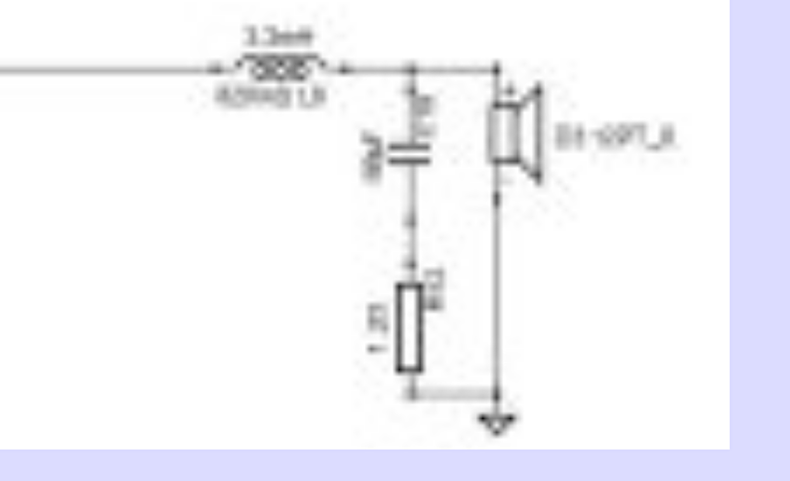

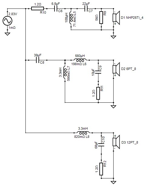

thanks @picowallspeaker - I still had to upscale the large image to see (my vision is blurry). Is it ok I use Dayton laminated steel 3.5mH /0.39 ohm DCR inductors in place or he 3.3mH in the sim? - I doubt a problem distortion wise (?)
Also, how critical is the 100uH's DCR in the tweeter circuit? (I think Eayton's 100uH 18ga coil is aorund 0.14 ohm DCR)

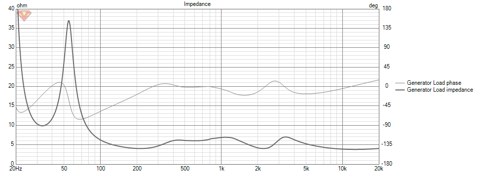

mmmh, same reasoning goes with the 3.3 mH coils, the one for LP ( series connection) for the woofer and the one in parallel in the HP for the midrange. Generally the shunting coils use a smaller section, so a higher gauge, but it depends on the power used.
So I was expeting a higher resistance in the coil used in midrange's HP, but it's less that the one used in the woofer.
@WhiteDragon I've made budget picks for a build with the neo Dayton Ti tweeter - - for the 0.12 ohm 0.56mH coil - a Dayton Perfect Layer 0.60mH coil with 0.38 ohm DCR. (can de-wind to 0.56 if needed - assuming windings are not heavily glued together). Also, I could de-wind the 3.5mH steel core chokes to 3.3mH - if matters.
If there is a GRS dome or horn tweeter which GRS would work well ? - and would the same 0.56mH mid inductor and 3rd order tweeter highpass work ok with it?

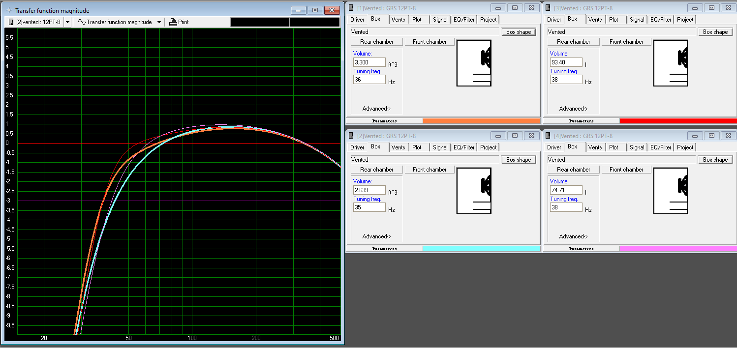

Also - how many liters would you give the GRS 2PT woofer? - where would you tube?

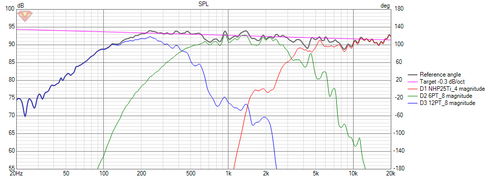

Hah knew you would ask about the horn.
Not many have frequency response data and baffle was little tight.
So used a the dome since I had files and quality is better than most would assume.
Use whatever coils fit your budget.
I usually role up the internal resistance in sim to meet smaller coils.

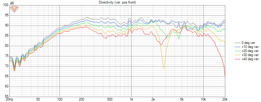

Looks like I forgot the mids/highs.
I usually always check the woofer as noticed.
I think I used a BB4 for sim ill check

I Use standard alignments, and wont tune more than 3 Hz
above a alignment.
Orange
QB3
3.3 cubic feet ( 93.4 liters) 36 Hz
red line shows 38 Hz higher tune
Blue
BB4
2.6 cubic feet ( 74.7 liters) 35 Hz
pink line shows 38 Hz higher tune

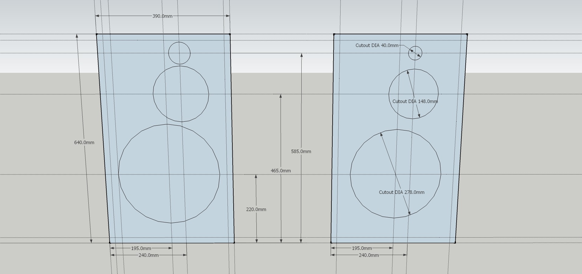

So as figured 2.6 cubic feet is feasible
tune 35 to 38 Hz
Assuming 18mm plywood (3/4)
box should be 380mm deep.
Enclosure be 2.86 cubic feet or 81 liters.
Of course larger so once mid box is in and driver/bracing
displacement net volume be 2.6 cubic feet for BB4
Same deal thumbnail, right click to enlarge
above a alignment.
Orange
QB3
Blue
BB4
![1716615568347.png 1716615568347.png](https://www.diyaudio.com/community/data/attachments/1222/1222004-7c43cd2322a0c52a458d08205c822b9a.jpg)
tune 35 to 38 Hz

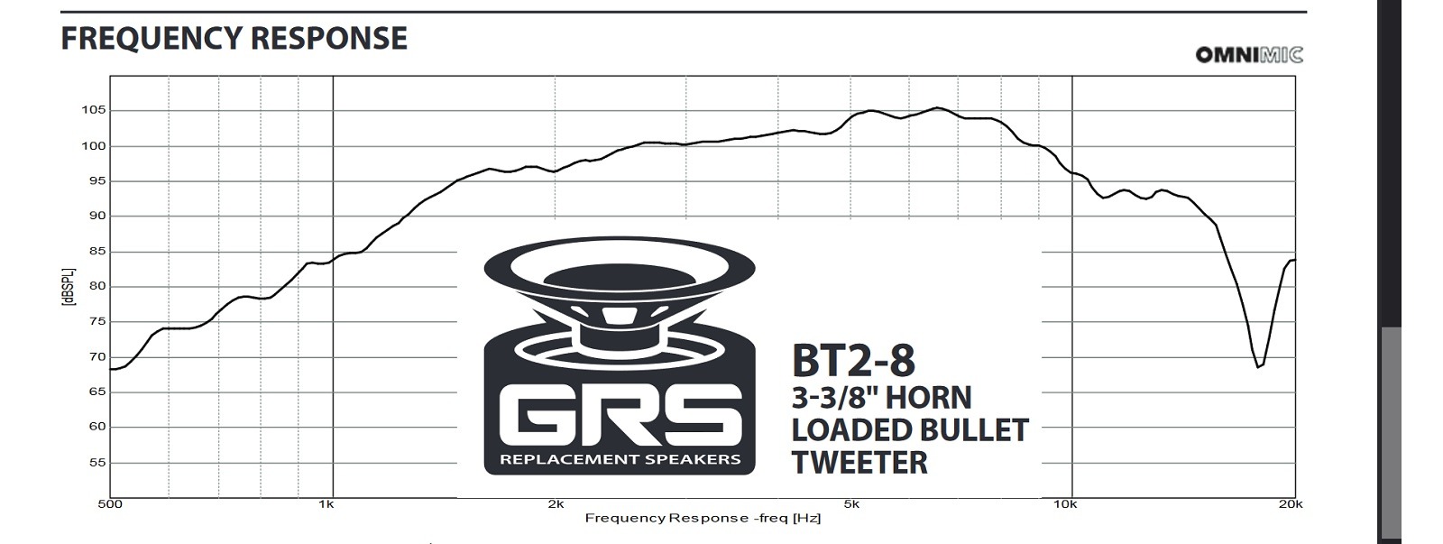

There is a few PRV horns with good data and impedance.(GRS designer dome looks pretty smooth but no data for sim) BT2 might be coerced into something usable for a geezer wit no high end octave - not pretty - but "bass players" seem to like it....

$6.98 dome tweeter GRS - not shabby - what's your estimate for a ballpark highpass to go with the 6PT-12PT project?
https://www.parts-express.com/pedocs/specs/292-462--grs-1td1-8-spec-sheet.pdf
for horns I've 1.4" neo Beyma CD on a little 8"x8" horn with Lordsansui's "smallhorn3"
ill just do a trace and work out the values, after sim the baffle.$6.98 dome tweeter GRS - not shabby - what's your estimate for a ballpark highpass to go with the 6PT-12PT project?
easy enough.

Im checking my drawings now to see if it even fits the baffle.
