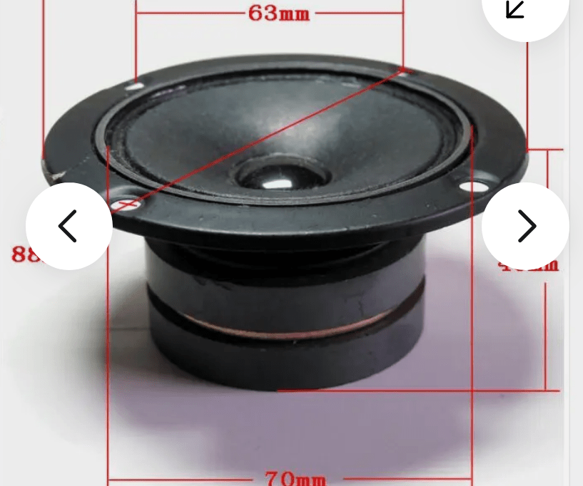

one thing I noticed while playing with several clones of the old CTS "Phenolic Ring Tweeter" was that they were unable to reproduce any semblance of a cymbal crashh -- Faital's 3FE35 fared better (might take four of them per side)

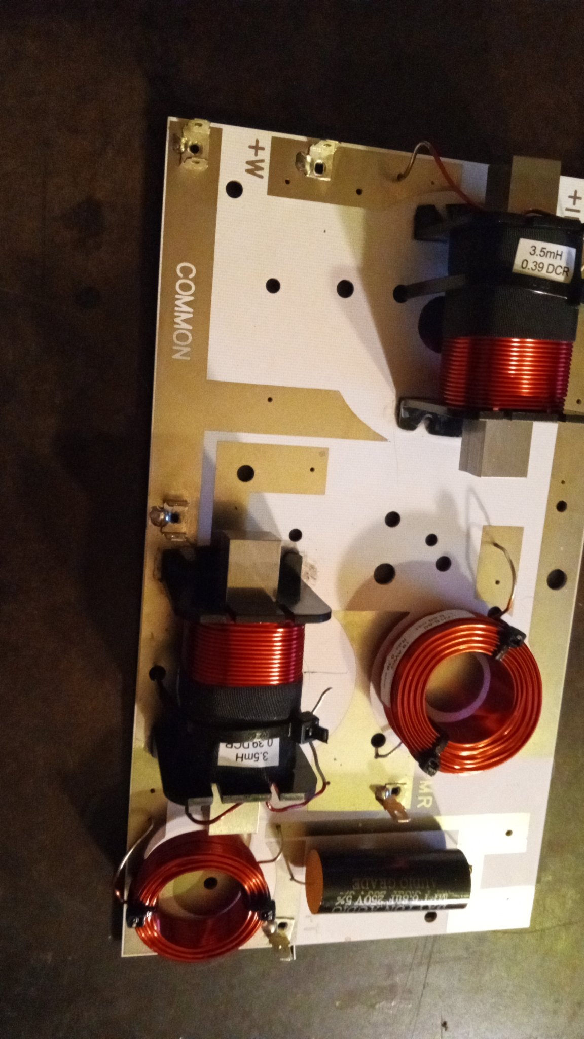

See if these are any more legible--same thing, just a little bigger and darker.FWIW I tried and tried to read the xover values - my vision is washed out - proably from decades of diabetes -this was the best I could do with GIMP and can't really see it well
THAT LOOKS GOOD - I'm sure my blood sugar is way high - FWIW I took the large file and upscaled it to read a day ago - wrote down the schematic and will order some coils, caps and whichever tweeter looks best for low dough.

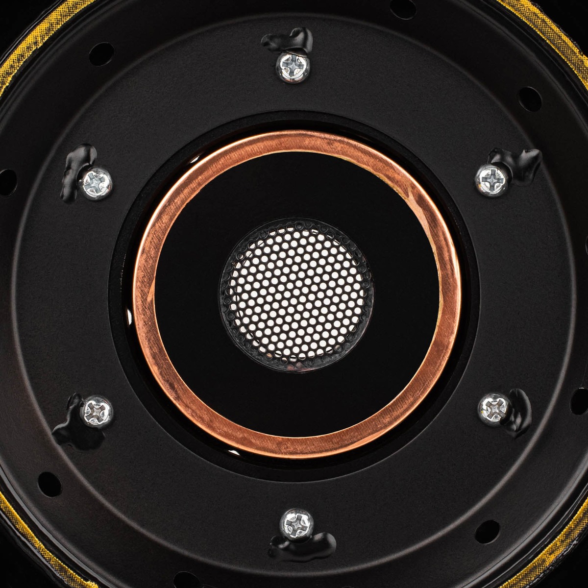

Looked at the GRS 6 and 12 pt.
I like the drivers for having copper Faraday rings on the pole piece!
I would build a speaker with their 18inch candidate one day...

storms coming - possible power outage - so ordered xover parts for one cabinet plus a tweeter - hope its workable with the schematic's highpass

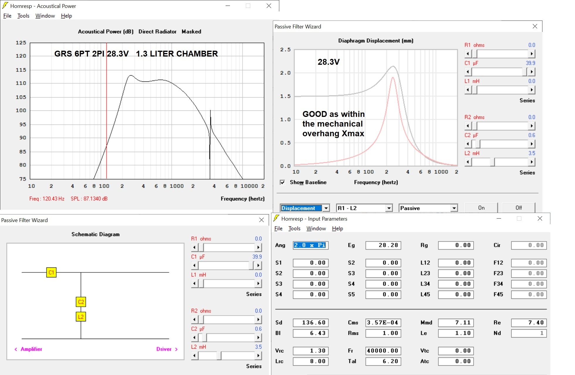

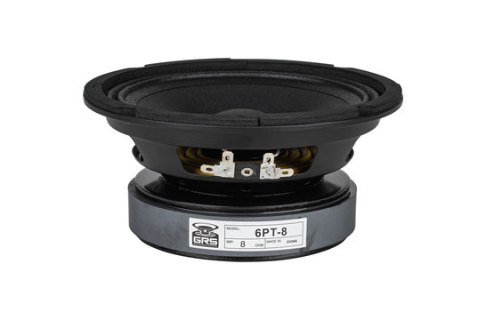

@WhiteDragon - what size should the GRS 6pt chamber be? I get 1.3 liter to keep within Xmax within 28.3 volts input.
@WhiteDragon - what volumn did you use for 6PT's chamber? It might be awhile for a cabinet but started on an xover. Maybe I can run just a baffle with proper driver locations to get a feel of things.
6PT has enough sensitivity@WhiteDragon - what volumn did you use for 6PT's chamber? It might be awhile for a cabinet but started on an xover. Maybe I can run just a baffle with proper driver locations to get a feel of things.
But has tradeoff of High Qts to do its thing.
Unfortunately requires a somewhat large volume.
But I do run some drivers on the small side for midrange.
But 1.3 liters would be pretty high Qtc
Typically I like to run .8 to .9 max Qtc for a mid
But would run the 6PT pretty close to its Vas.
Basically getting close to 1.00 Qtc
But for the form factor of this 3 way
1.1 Qtc is 6 liters
Use 9 liters to 6 liters minimum
And 3 liters would be way to small
so 1.3 liters again is way to much Q
in sim need to use filter to judge xmax
the crossover used will keep it way under
xmax at 6 liters
in the screen shot I show 3 liters
in pink and its painful to look at.
and adds to much Q
dont want Q touching the crossover set around 500 ish

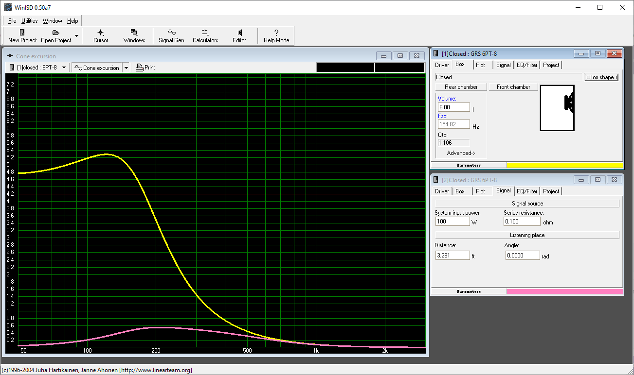

Linear excursion for a midrange
in the 4mm range is rather healthy.
With the right crossover
or just a basic high pass really
Excursion will be under 1mm
And with full thermal power.
100 watts put you close to 112 dB
think the cops will come before the
speaker goes.
Anyways.
Here is cone excursion at 100 watts in
yellow. NO crossover.
With crossover the speaker is under 1mm
and you will exceed the thermal rating
way before you hit linear limit.
PINK line is with basic 2nd order as used
in the crossover.
6 liter box is enough to keep Q out of the passband
and Xmax never exceeded at full thermal power.

Yes pretty much.one thing I noticed while playing with several clones of the old CTS "Phenolic Ring Tweeter" was that they were unable to reproduce any semblance of a cymbal crashh
Ironic with measurement of paper / phenolic tweeters
most would assume they are "harsh"
My pioneers were on a simple 1st order
and the paper was never harsh.
And exactly just lacked detail.
Roger Sound labs 3600
had a dome tweeter.

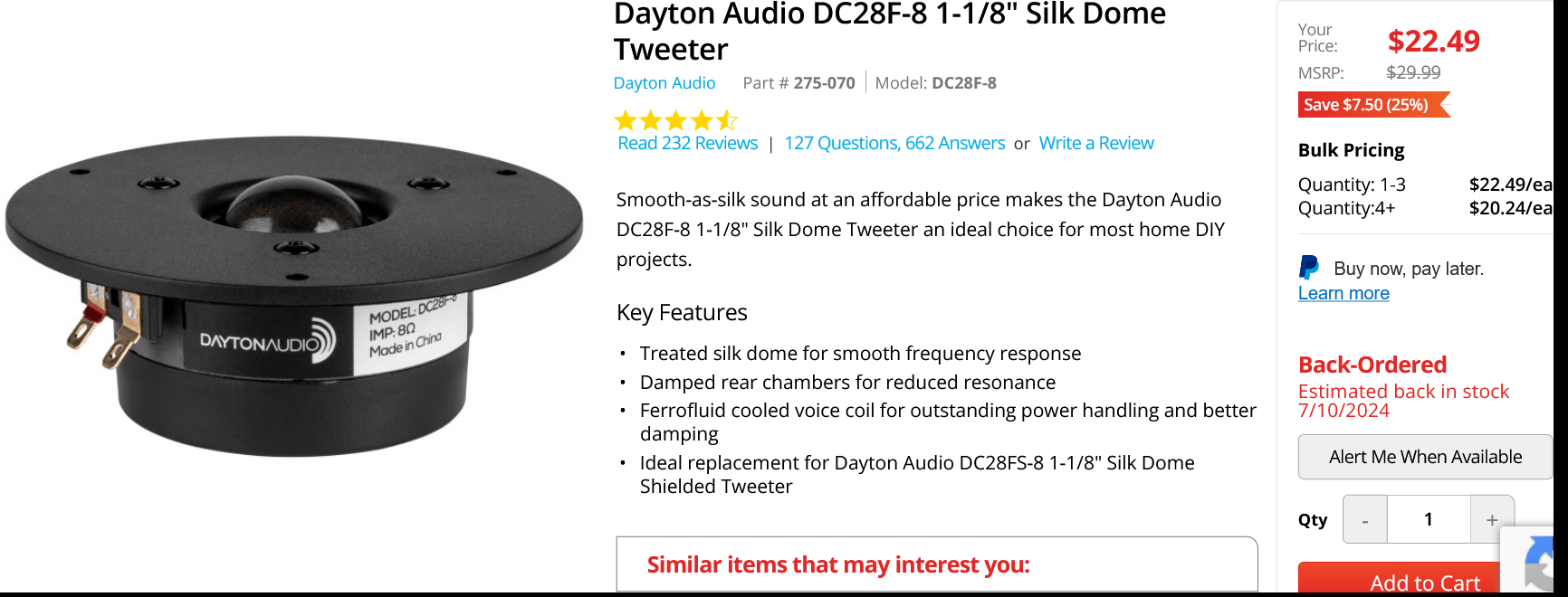

Something a basic dayton Silk would do.
Now days.
Dayton silk like the DC28F shown.
Isnt harsh on very very high crossover.
It wont cross low enough to the 6PT
my opinion.
Main issue with ceramic tweeters.
Is the magnet size.
Makes center to center spacing non ideal.
Just like the Roger Sound labs.
Sound quality is ok, in measurement
vertical actually even horizontal.
Wont be as great with RSL because tweeter
is way way to far out.
JBL did better spacing with the phenolic.
Its the physical size that cant be beat.

- I want a cost effective passive 3-way xover to mate GRS 12PT to GRS 6PT plus "whatever" tweeter
