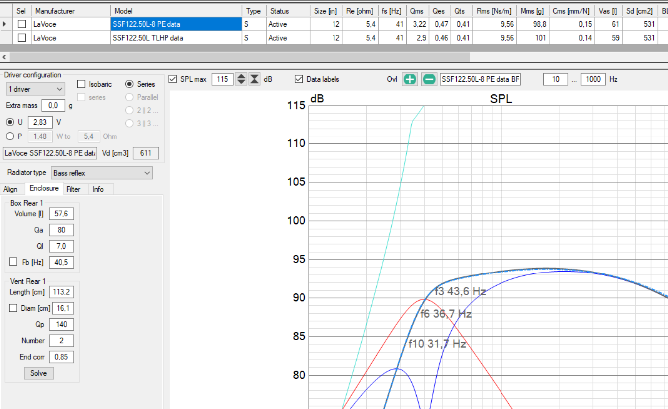

Parts Express shows Qms of 3.22 which isn't meaningfully different from 2.9 but I wondered why the difference. I checked the official LaVoce data sheet at Parts Express and it also said 3.22.
So, I went to toutlehautparleur.com and checked, and sure enough they show 2.9 and have an official LaVoce data sheet that says 2.9.
So I went to LaVoce's home page. And they show on their product page as well as an official LaVoce data sheet Qms = 5.36.

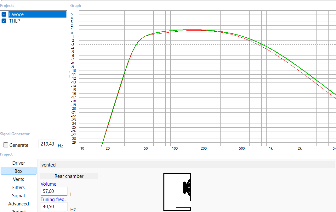

Hi, differences in Lavoce data are not meaningful in practice it seems. I took data from TLHP datasheet and also from parts express site and here they are overlaid in simulator. Difference in same box is about invisible, this image has the other driver as overlay and the other active, and the dashed line is barely visible.
Qms describes stiffness of suspension. I speculate datasheet value is likely some average arrived with test methods they use at the factory and then nicely rounded. PE data is likely measured by them, perhaps using just one driver, because it's given with one more decimal. Anyway, their test method likely differs a bit and the suspension wasn't perhaps warmed / stretched similarly. Anyway, the data seems to be close enough to be within very good tolerance it seems, because the actual response in a box (simulated) doesn't change basically at all.

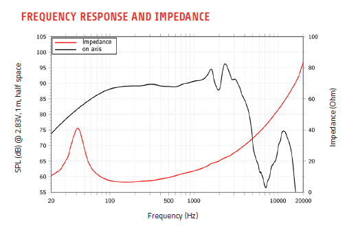

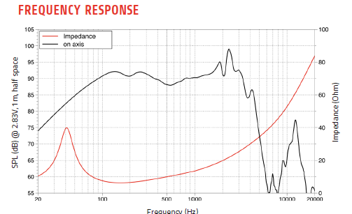

There is a little bit more differences with the datas on LAVOCE website.
But it's true there is not much differences with TS parameters
Measurements on datasheets are different even if they are saying they do it the same way with same klippel.
Old one
New one. (closer to 89db by the way ...)
Old one

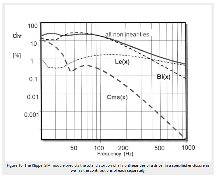

Quote below from https://audioxpress.com/article/beyond-thiele-small-dumax-and-klippel-driver-measurement-systems
For force factor, whether in the mass loaded or compliance loaded range, in order for diaphragm motion to be linear, the driving force must be linear across the desired range of movement. If the driving force produced by the voice coil/magnet structure for a given drive signal changes as the coil moves through its excursion range, the force on the coil, and therefore the diaphragm, will not be linear, resulting in distortion.
For compliance, you might think that because the driver is mass loaded above resonance, compliance nonlinearities would only matter below resonance. While they are certainly very important in this range, they can also affect the driver above resonance.
To visualize this, think of a driver above resonance with a magnetic structure having unlimited linear excursion capability. Also think of the suspension having a compliance that is totally linear throughout most of its range, but also having a “brick wall” change in compliance when it reaches a certain distance, much like having a mechanical stop on both sides of the voice coil. It is easy to visualize that, above resonance, until the “brick wall” compliance limit is reached, as drive level is increased, the mass being constant and dominant will result in linear output.
edit. here image from the above link that at least on this particular driver motor non-linearities seem to contribute order of magnitude more for most of the bandwidth indicating suspension issues are mostly on the lows. Do you have any info on audibility of these?
