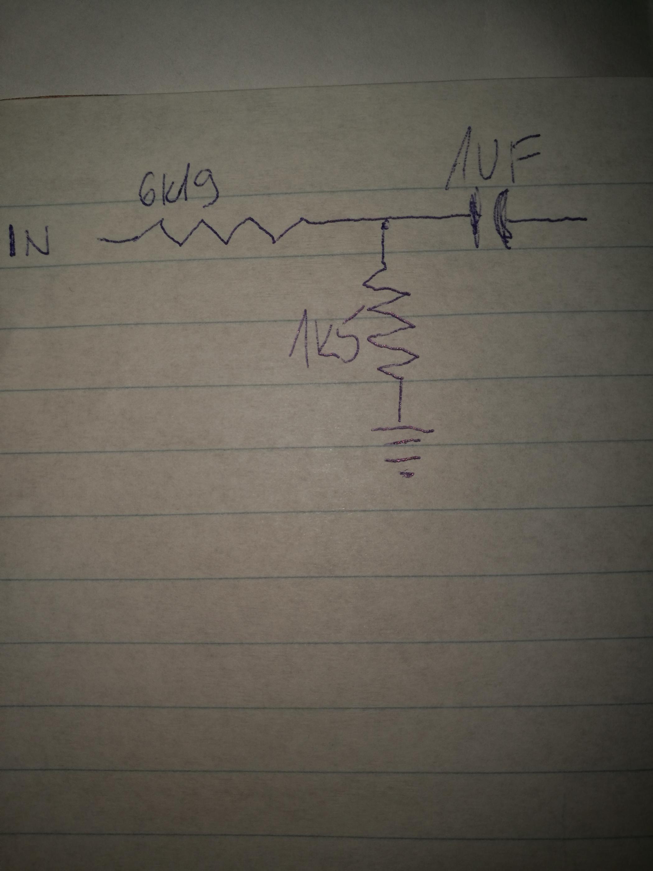

Ups..replacing r107 to 100k caused increased gain.There is no possibility to mute to 0 by pot -quietly but I can hear cd source and slight movement causes a large increase in volume
Ok. Can you explain me how to do it?Remove gain stages that are not required.
6k18 on input and 1k5 in r107 this configuration play much better

In my BoZ, someone used the third solution to reduce gain? see how it looks in the attachment. Is this also possible?

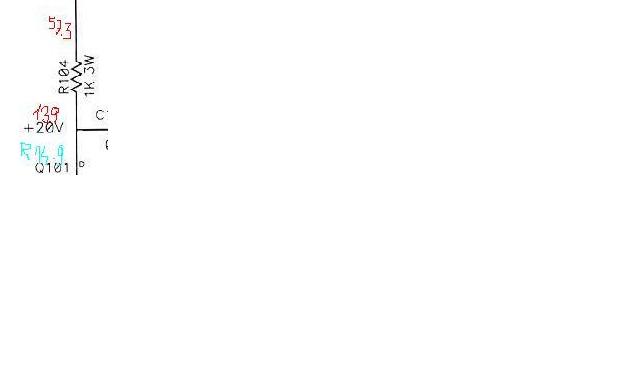

If you can look at my earlier post you will see that the measured values after the 1k / 3W resistor differ from the diagram by about 7V. Should I worry about that?

......that is the first solution: attenuating the signal at the input. that is nothing else than a voltage divider - some kind of volume pot - at the input. this does not change the gain of the boz.

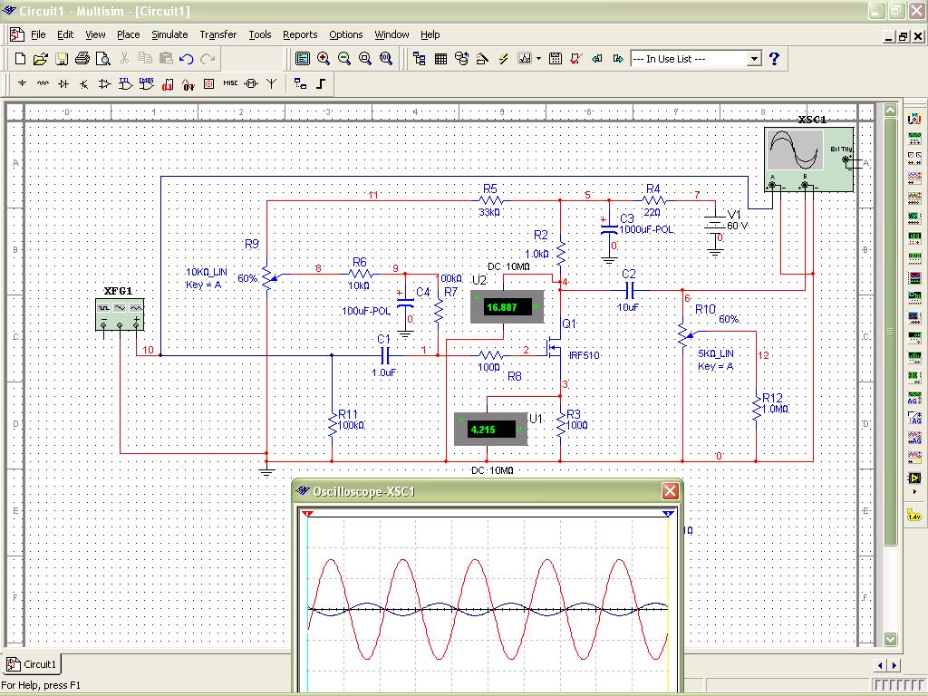

there could be a few "best solutions".

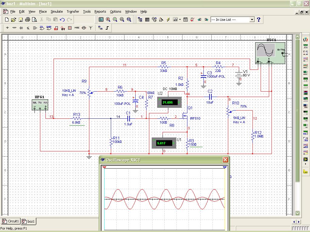

perhaps an example:
boz with gain around 5 times:
input att. res 6.8k (do not use a bigger one - or the treble can drop down...)
source res 150ohm
the 10k pot (connected via 100k to the gate of the irf510) changes the current
through the transistor and the drain volts too........
source res 150ohm
annother res......gives different volts.
have a look at the current:
original 4V/100ohm = 40mA
modified 5,6/150 = 37mA..........close to 40

yes,the 1k drain res is hot.......there are around 1,5W heat dissipation in it.
