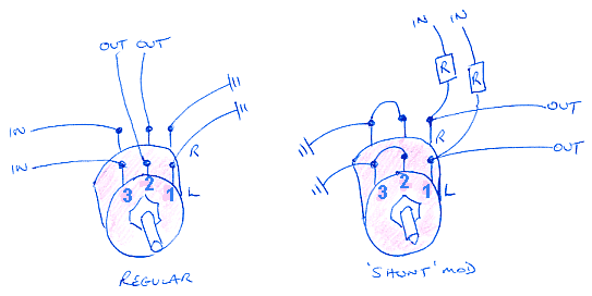

Not to argue with mighty Zen Mod BUT! 😛
Shunt mod to a pot can make quite a difference to the sound.
It allows the use of selected resistor in the audio path.
There was much discussion on the old World audio site and many tried and liked the idea.
Shunt Pot Volume Control for Better Sound and/or Gain Reduction - World-Designs-Forum
This is a volume control which uses a fixed resistor as the series part of the potential divider and a log pot as an variable resistor for the shunt part. Note that the pot is "inverted" from its normal wiring; the signal-in and earth connections are the other way around from standard.
It gives the signal an elegant hard wired path. The earth connection is made via the pot wiper. Any noise at the wiper junction with the track will be isolated/reduced by the track resistance between the wiper and signal.
(Subjective comment - the sound is noticeably clearer. A metal film resistor used as series gives a brighter more detailed sound whilst a carbon film type gives a warmer sound. Some of the pot character remains and pot/resistor combinations can be tried to taste. An Alps Blue with a metal film series resistor makes a very enjoyable control with sweet and open high frequency detail and warm bass.)
To keep a similar "feel" to the volume control law choose a series resistor approx 90% the value of the pot track, so 91k with a 100k pot, 47k with a 50k pot, or 18k with a 20k pot. (Only small wattage resistors are needed, eg 1/4W or 1/2W will be fine.)

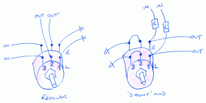

Colin,
your sketches are wrongly labelled.
There is no ground on either.
There is a common terminal, i.e. common to both the input and the output.
Left Diagram
Two wires bring in the signal to pins 3 & 1.
Two wires take out the signal from pins 2 & 1.
Left Diagram
Perhaps
if you want to be pedantic about it.
but most people understand them as drawn!

The problem is that "most" mistake what that gnd symbol means. And try to use a single wire conenction either in, or out, or both and take the gnd to somewhere else.Perhaps
The vol pot needs a two wire input and needs a two wire output. The gnd is not a ground.
