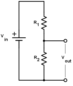

Speaking instead of voltage dividers ... i had in mind the one attached
Very basic ... two resistors with maybe one of the two replaced by a 10 turn trimmer to have a precise control on the setting
The one in the schematic looks more complex to me. Is there a particular reason for that complexity ? i see maybe a RC filter ?

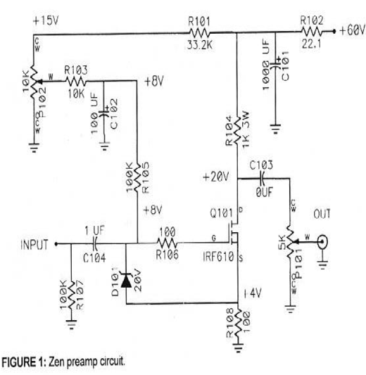

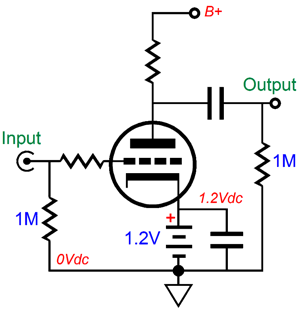

For instance ... can i use a battery to provide 9V instead of 8V in front of the Mosfet ? like for tubes ?
It seems to me that people have moved on from this design without a reason
Is the schematic proposed the best possible for a single mosfet line stage ?
If so ... issue closed of course
The 8V is not something you set as a target, but rather just a nominal value
you might measure when the mosfet is biased up to 40mA by adjusting P102.
Take two random IRF610 and you'll likely see two different values.

The 8V is not something you set as a target, but rather just a nominal value you might measure when the mosfet is biased up to 40mA by adjusting P102.

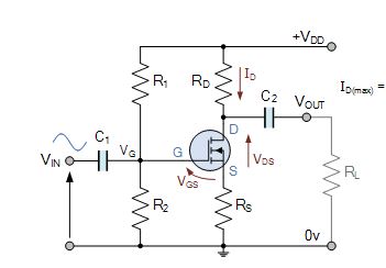

I was just wondering about alternative schematics like the one attached Will it work just the same ? that is much easier
I see. I played some years ago with a prototype i must still have somewhere I had a disastrous move during which many things were lost and now they are stored aways badly.I built a Boz and had a couple of issues. I tried a couple 5K pots for

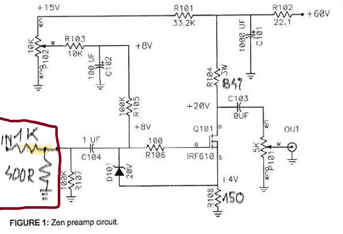

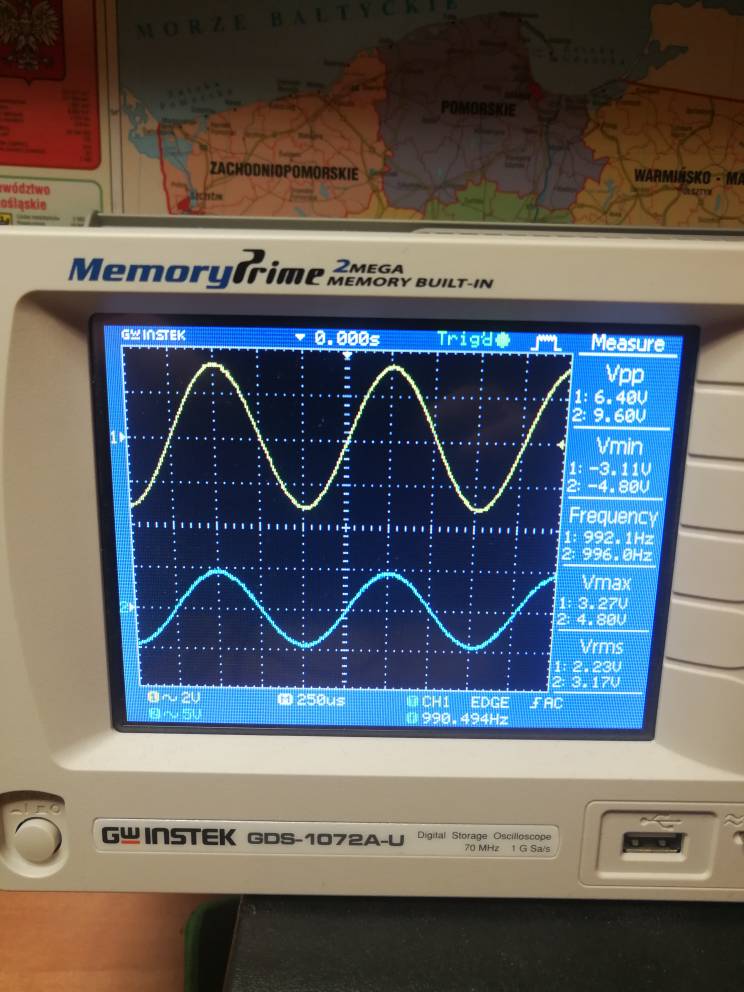

I have a question about the input attenuator and I'm asking for advice.
Gain, despite the changes in the R104 / R108 resistors, was too big so, on the advice of my friends from another forum, I made a 1k / 400R attenuator at the output. However, it is only needed for the CD input, so I made it at the input (see picture).
Is that a good solution?

voltage divider 1k+400ohms gives you an imput impedance around 1,3xxx kohms..................way too low for hifi gear.
use multiples of these, e.g. 4,7 times ,
so 4,7k instead of 1k and 1,8k for 400 ohms.
aside this you can increase the 150 ohm source res to 180 ohms or so what
and trim the drain volts again.......this lowers the voltage gain a little bit.

As I wrote, only the CD input needs attenuation so I will not interfere with the circuit anymore. I am happy how BoZ sounds and what the waveforms look like. Of course, I will change this voltage divider on the input as you advised.
Maybe 10k/4k3 will be better?
This is the 1k / 400r gain on the oscilloscope
