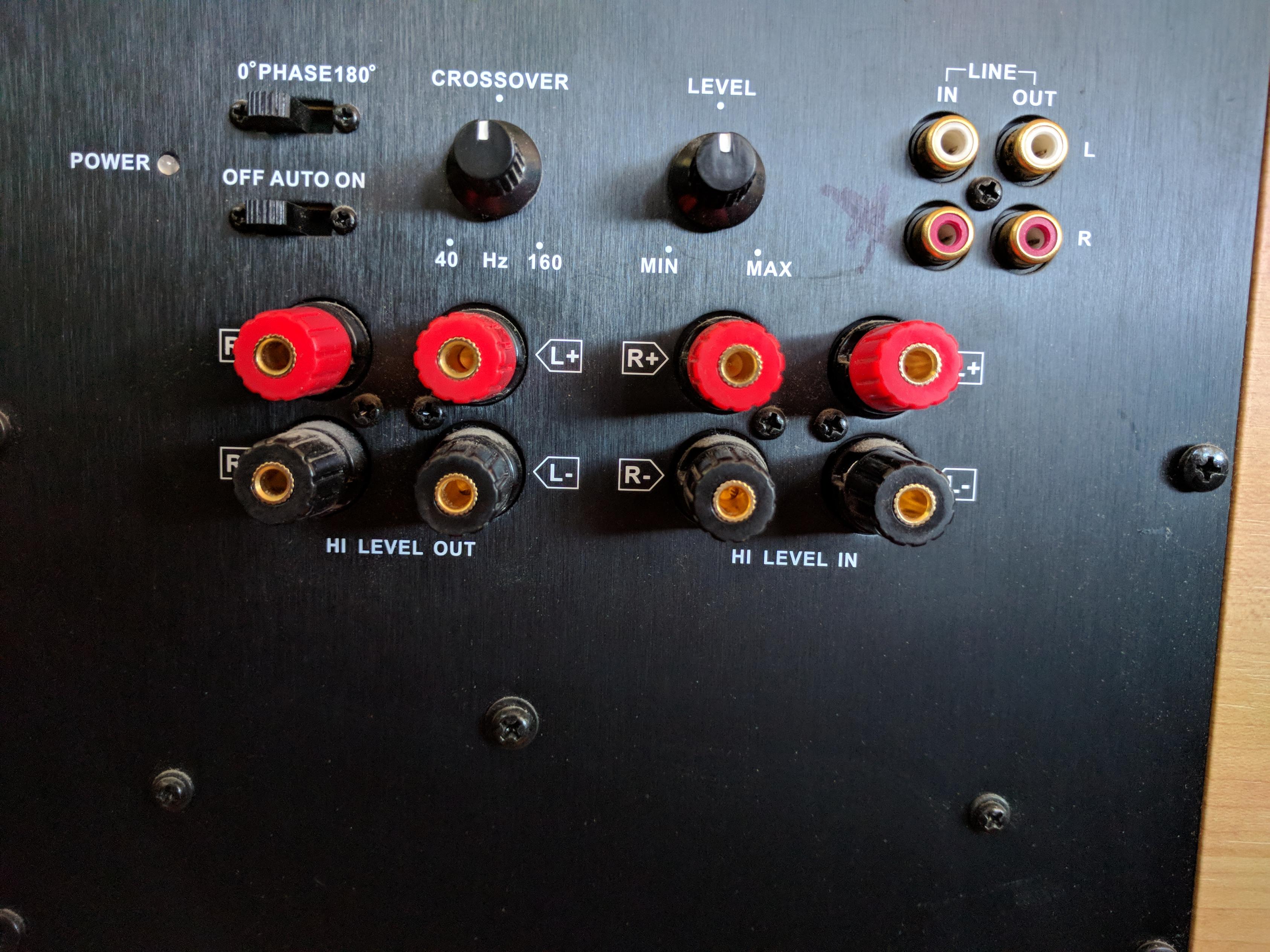

I picked up the Sansui Sub for US$84.
First time Sub user.
Do I run the speaker cables from the Amp to the Sub High Level In posts, and then from Sub High Level Out posts to the Karlsonators?

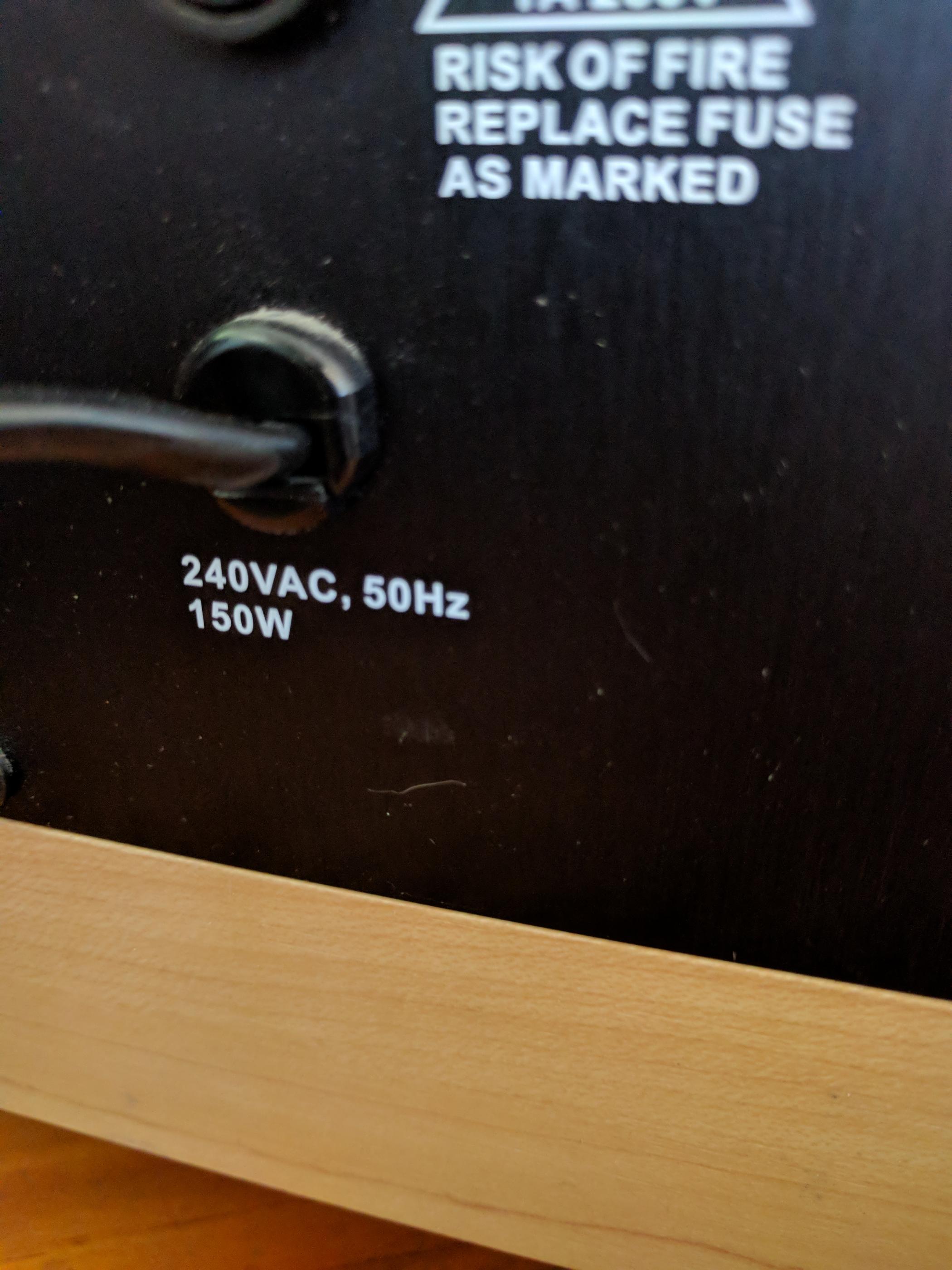

The powered Sansui Sub looks like it has a healthy onboard power supply.

That’s a great deal. Did you make sure it works before buying?
Yes. Connect your amp’s output to the “Input” and your speakers to the “Output” on the sub. They are just pass throughs with a high impedance tap for the sub’s amp.
