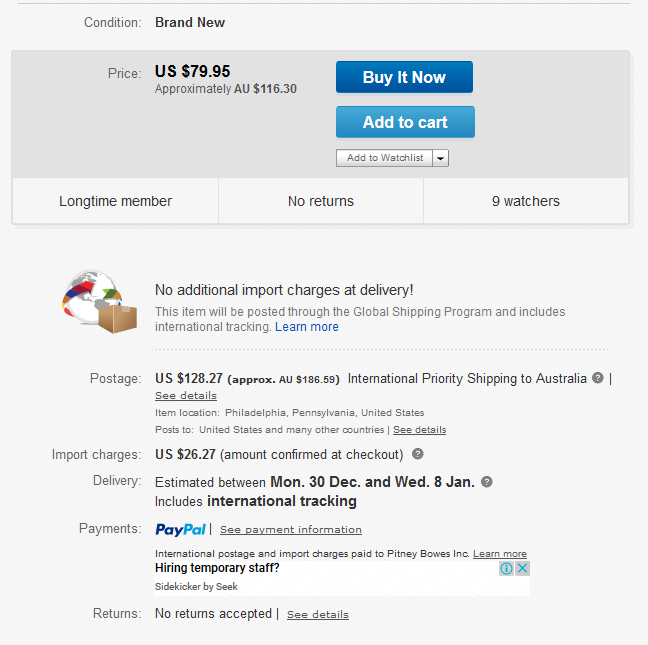

Oh well, sorry - that’s what the screen told me shipping was. Did sound rather low. But there must be other brands of HT subs you can get locally in Oz?
This one says $220AUSD and free standard shipping. Is it true?
Polk Audio PSW10 10in Powered Subwoofer Single Black | eBay
It says "May not post to Australia". Generally shipping from the US is crazy expensive to Aus. It is not uncommon for even small things to be minimum $50 US to be shipped.
