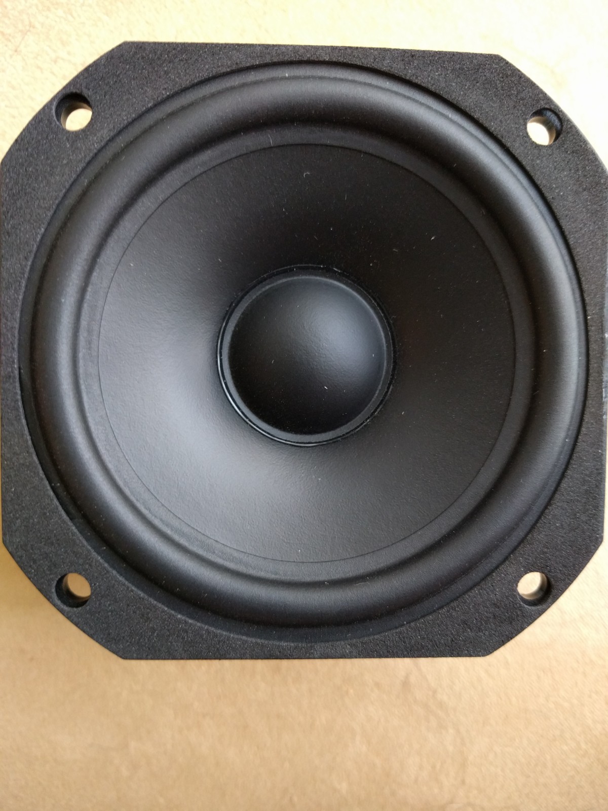

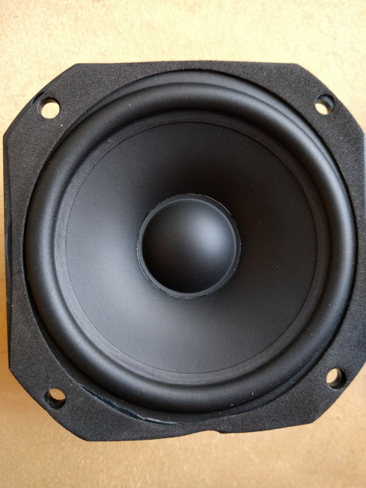

Hi X.
I've started collecting for the Karlsonater project.
The 4 x TC9FD18-8's arrived today.
One of the drivers appears to be off centre in relation to its mounting plate.
In one photo attached the speaker cone is mounted fairly evenly to its mounting plate.
On the other the speaker cone is affixed off centre.
Notice on one edge the foam surround is right up against the mounting plate, while on the other edge there is wide gap.
Should I be worried about this driver?
Will it affect performance?
thanks
