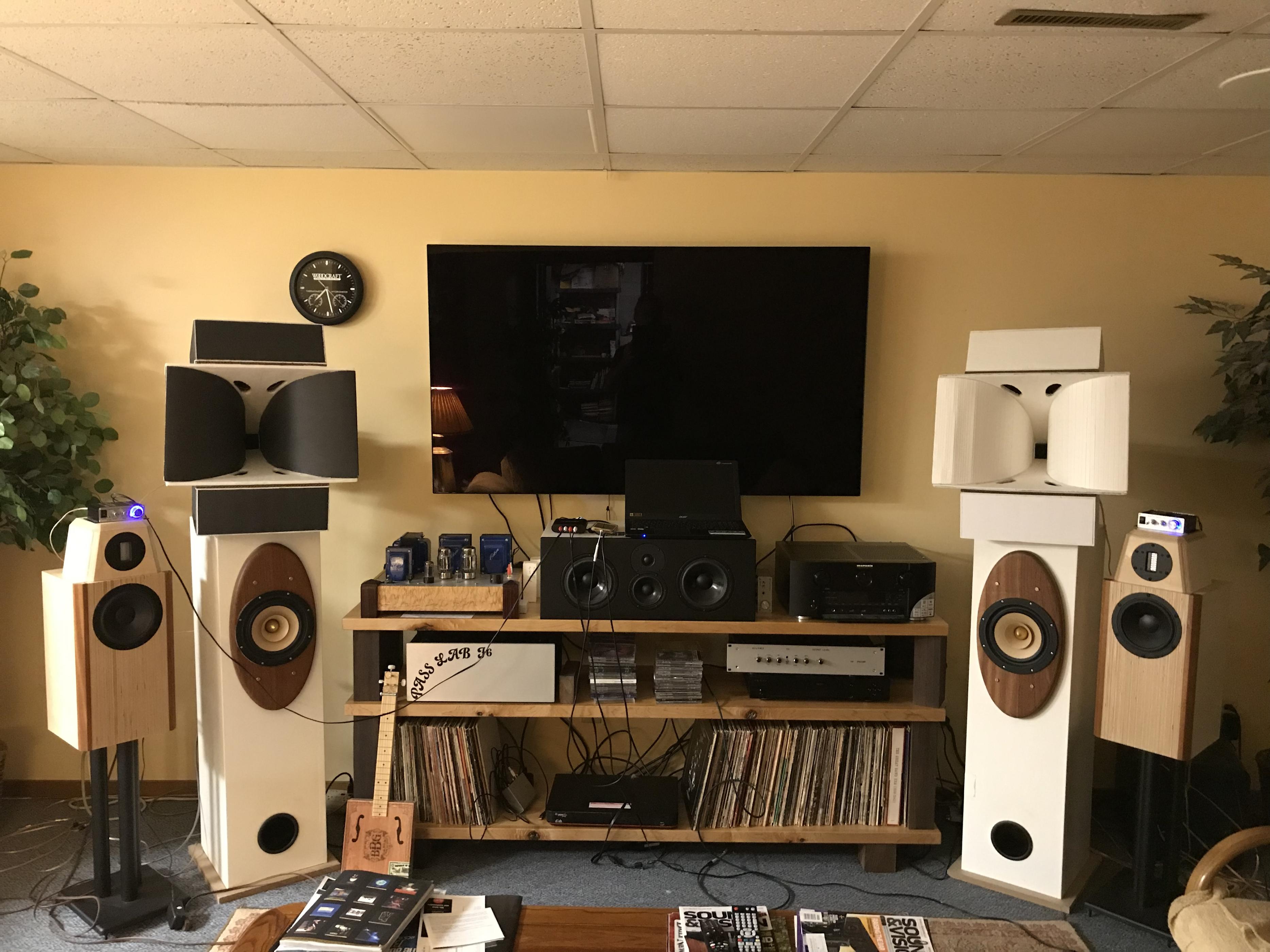

XRK, the AMT speaker from post 102 makes me want to buy a pair of Heil AMTs🙂 I cannot find BC 6ND44, only 6NDL44. But I would guess there are many 6"-8" speakers that would work well in this design, am I right? I have a pair of 8PE21 waiting for use. My adventures with Patrick Bateman's UICW definitely make me want another Unity/Synergy style speaker. What was the crossover frequency to the bass horn and do you remember the mouth dimensions? I also wonder if the Beyma TPL-150 would work as well. There are not many AMTs available in Europe. The good news is that Heil actually ships to my country, although I will end up paying double due to shipping and customs/VAT.
More info here on design with crossover frequencies. Sorry it was 6MDN44. Although many 5in to 6in midrange drivers works here. I just used it because I had it on hand plus it is sensitive.
https://www.diyaudio.com/forums/multi-way/345123-unity-synergy-horn-closed-vs-6.html#post6026633
The XO w Heil was low around 700Hz. TPL150H works great too but XO around 2k.
I pulled the trigger and ordered a pair of AMTs from ESS. The postage is killing the great price on them and there will be VAT and customs added, but I think these will be worth the investment. From the description in the other thread, I tried to replicate the design but I miserably failed to get identical dimensions. However, as I see it, I can make the horn any size as long as it fits the intended place and when I know the exact dimensions of the throat, I could not find that anywhere on the net. I will go for a 3D printed throat to make a smooth transition possible and most probably have the panels cut from 15 mm plywood once I figure out the dimensions properly. Also, one 8PE21 will be put on each horn first since this is what I already have, it should work easily above 200 Hz and match the ribbon up.
I think the AMT would also work for a naked open baffle experiment with a 12" - so I will make a stand, too. Unfortunately I have no room for open baffles, but I will at least try if I like that or not🙂
You won’t regret it. Heil AMT’s are probably the best sounding tweeters I have heard, at any price. They are also very flexible on how you use them. OB, or just sitting on top of a sealed or reflex box is good too. Or in a horn as I did. I have tried them many ways and it is superb in any case.

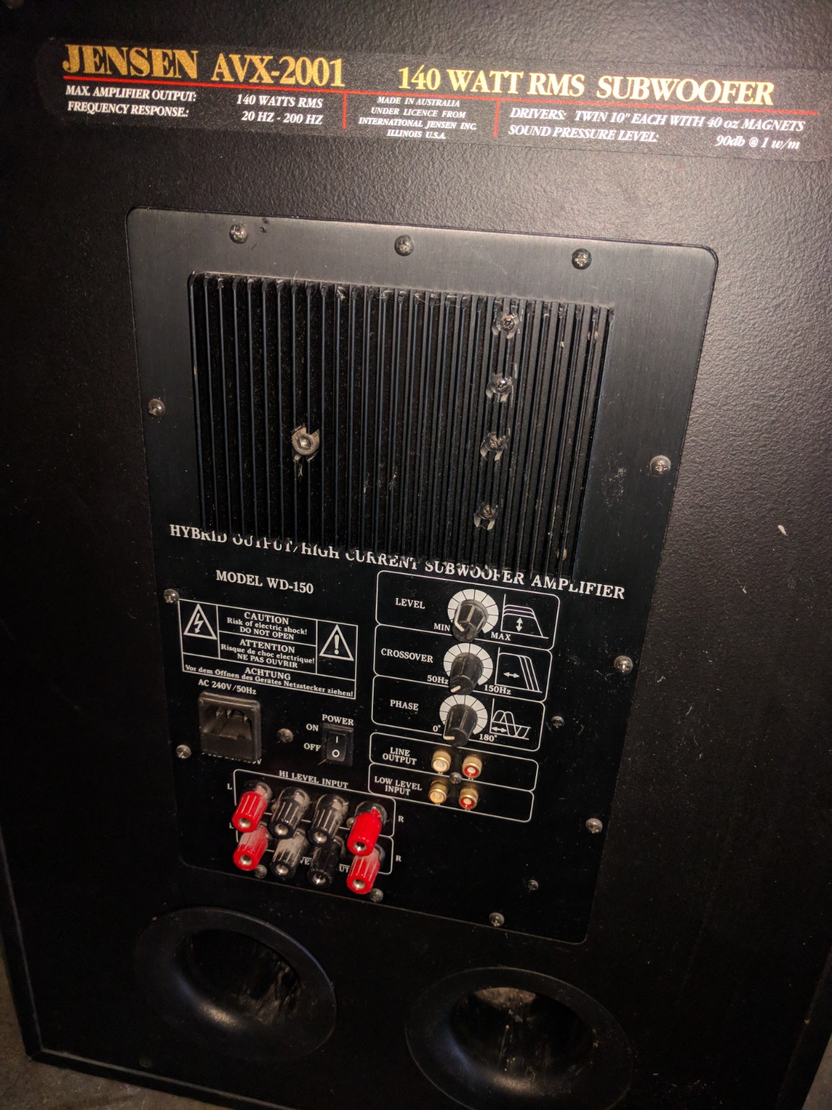

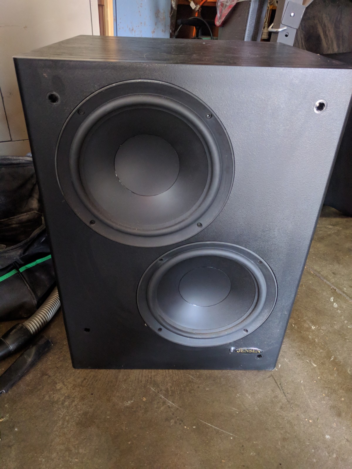

Hi X.
Picked up this Jensen AVX 2001 Subwoofer from the trash and treasure market today for $20.
2 x 10" front firing drivers with large vented magnets/four layer voice coils.
Driver Sensitivity: 91dB
Power: 140W RMS
Freq Response: 20Hz - 200Hz.
Auto On/Off power switch with light and thermal protection.
Level, Phase & Crossover Frequency Controls.
R&L Line Level inputs & outputs
Hi(Speaker) Level inputs & outputs
Enclosure: Bass Reflex
Haven't had a chance to test it.
Will this suit my Karlsonator project?
