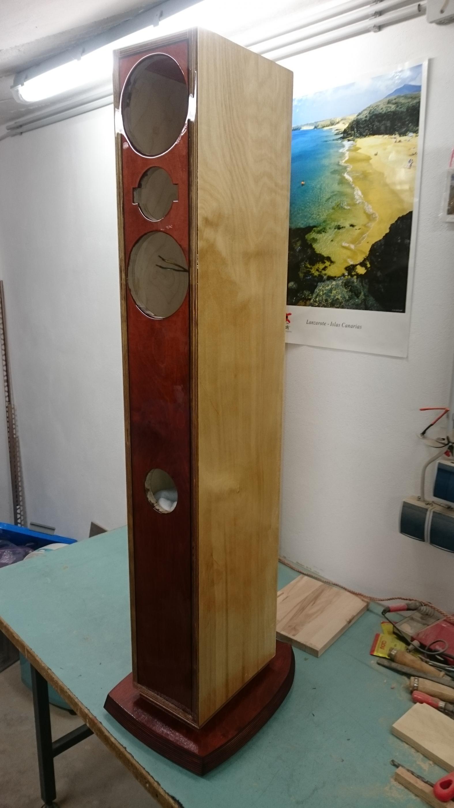

I have build this one. Breathtacking
dont know.
But worth its Money ->Yes. My have a better Paintjob.
440€ + Cabinet.
The only better speakers i`ve heard till now, are dynaudio`s 5000€ for a Pair. 🙄
Mine are running on an Aleph J or F5 works Pretty good
440€ + Cabinet.
