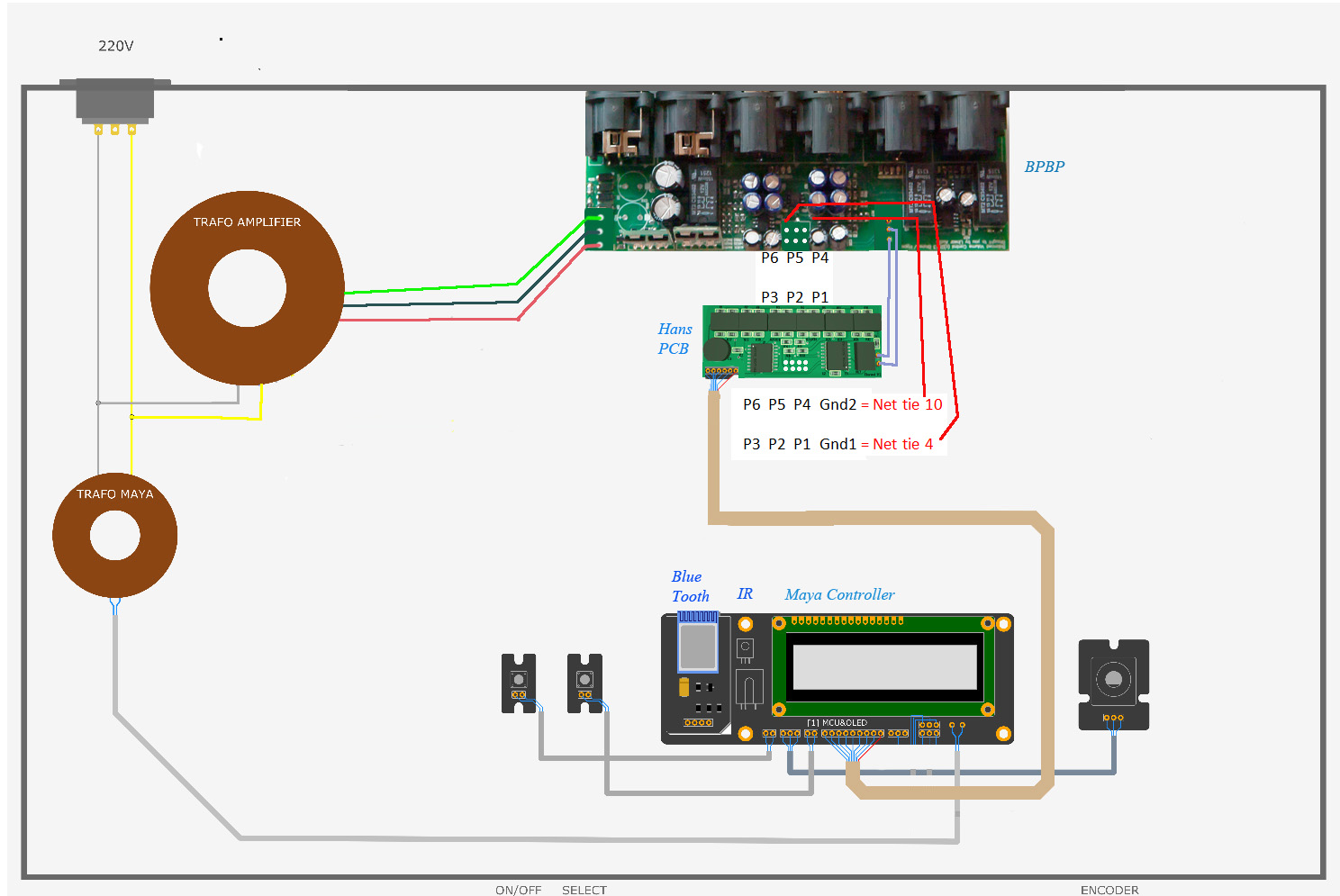

To remove all misunderstandings, hereby a graphical representation of Maya + BPBP
Hans
What components need to be mounted on your board Hans? I see 1 SMD resistor, the through-hole connectors and relays.. do I see a couple of SOIC chips to put on too?
EDIT - oops, those green squares are all SMD resistors, not connector blocks (not sure why I thought they would be.. in fact I neglected to think about that at all).
If so, how's the pitch on those - easy (relatively speaking) to solder each pin or should it involve drag soldering or hot air gun?
Tempted to get a few of your PCBs even without the Maya (but could go for one Maya to see what it's like). Should help the GB to buy more of the PCBs, one for each of the BPPBP boards I have.
Let's make it clear to people that they can use this Maya GB to simply obtain your board too without the Maya (assuming that's ok..?). Others like Billshruv can get six of your boards and use the Maya to control all six for multichannel.

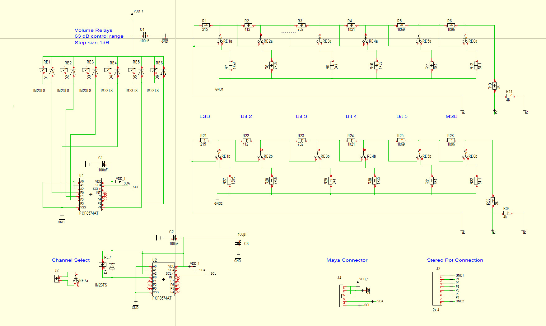

See the circuit diagram below for the used components. Resistors are 0805 SMD's, Diodes are RS1D, Relays are IM23TS.What components need to be mounted on your board Hans? I see 1 SMD resistor, the through-hole connectors and relays.. do I see a couple of SOIC chips to put on too?

Control range is always 63dB in 1dB steps, that should be more than adequate for every situation.
The volume control board, with the resistor values R14 and R34 as shown in the circuit diagram, has a control range going from -57dB to +6dB.
By changing R14 and R34 you can shift the 63dB range upwards or downwards, f.i. from -63dB to 0dB (R14/R34 = 2K) or from -51dB to +12dB (R14/R34 = 8K)
Hans

That is a feature that comes standard with Maya, but be aware that the BPBP has only two inputs, so A/B is channel1 vs channel2.2) Stored levels for each input (for A/B comparison of sources, for use with older, non-line level sources etc
Both impressions are wrong.I get the impression that 1) is possible if one could set different I2C serial addresses on your board but 2) isn't really possible unless the ladder/relay scheme was exactly the same as Maya's own attenuation boards.
1) is only possible with 2 current and unmodified Maya controllers, and
2) has nothing to do with the relay boards.
Maya CPU uses the I2C bus to select a channel, and to set the volume for that channel.
The controller only sees the PCF chips, and cannot see what type of ladder is used.
It can see though how many relay boards are used.
Remembering the volume per channel is a software feature within the CPU and is not a hardware function.
Switching between channels thus means for the CPU also restoring to the latest volume setting for that channel.
Hans
