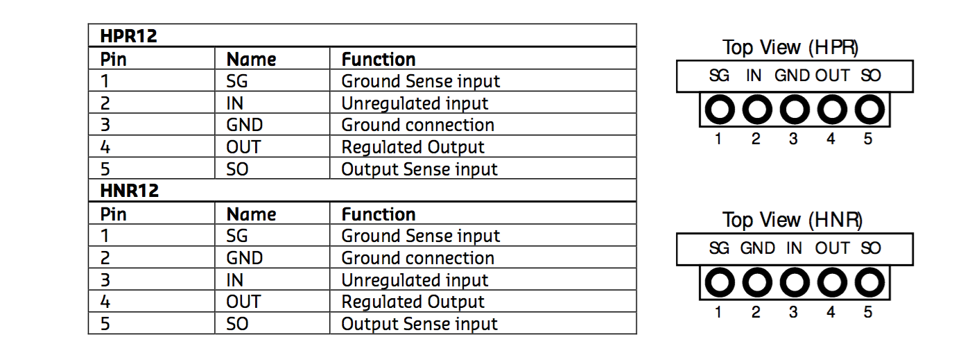

The HPR and HNR regulators only fit the PCB, if the black face is towards the adjacent smoothing capacitors.
There is no labelling on the regs.
Is this the correct orientation for the Putzeys' regulators?
Yes, it is.
This is how they should be mounted
Hans
P.S. Braca was just replying to the same question, now you have double proof.

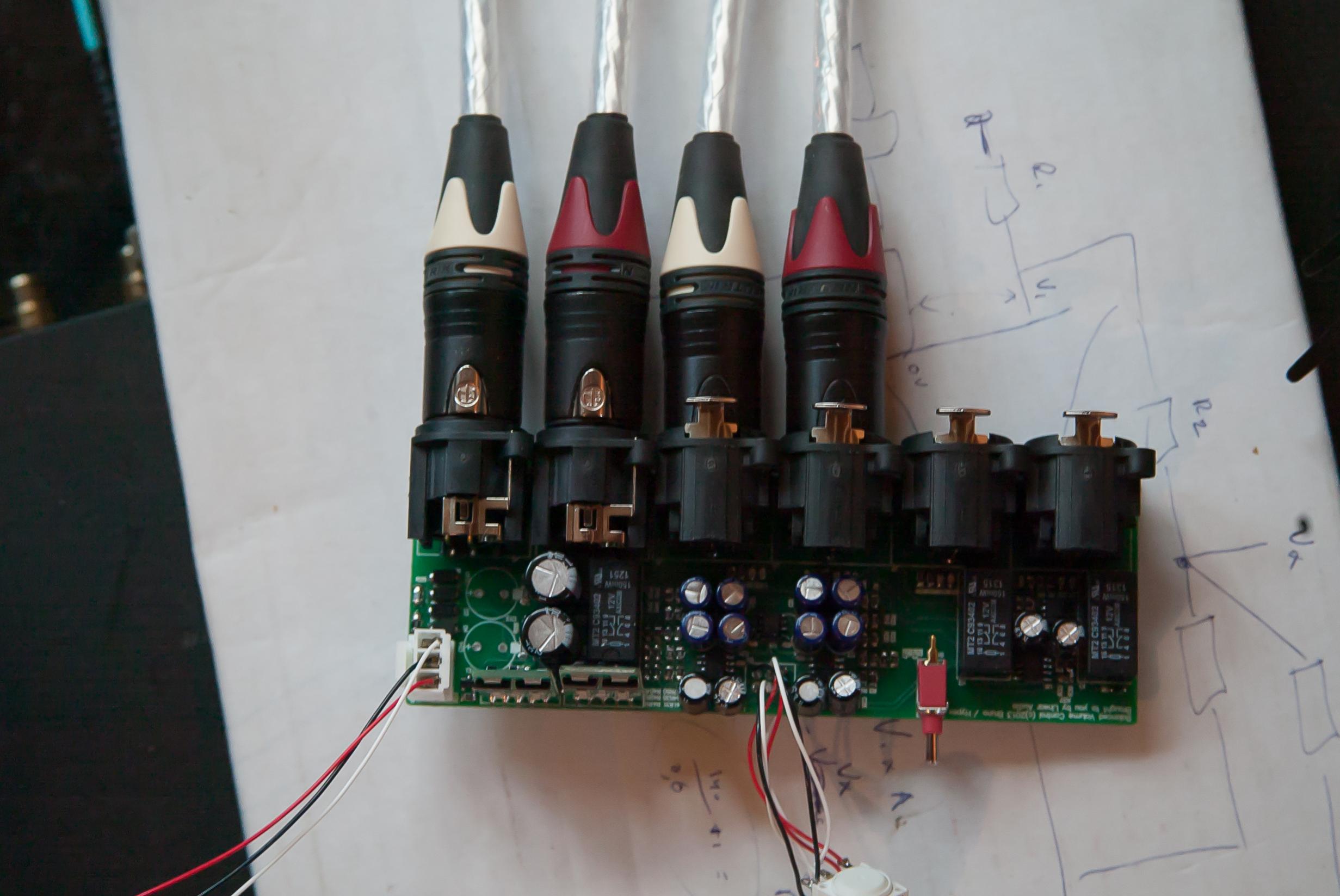

I measured a voltage offset at the XLR inputs. That offset swaps when the input relays are activated.
I have not tried adding an actual XLR cable with a true source resistance attached.
Is the offset at the inputs normal?
Will it disappear when an active source is connected?
If the source is not active, will the offset return?
