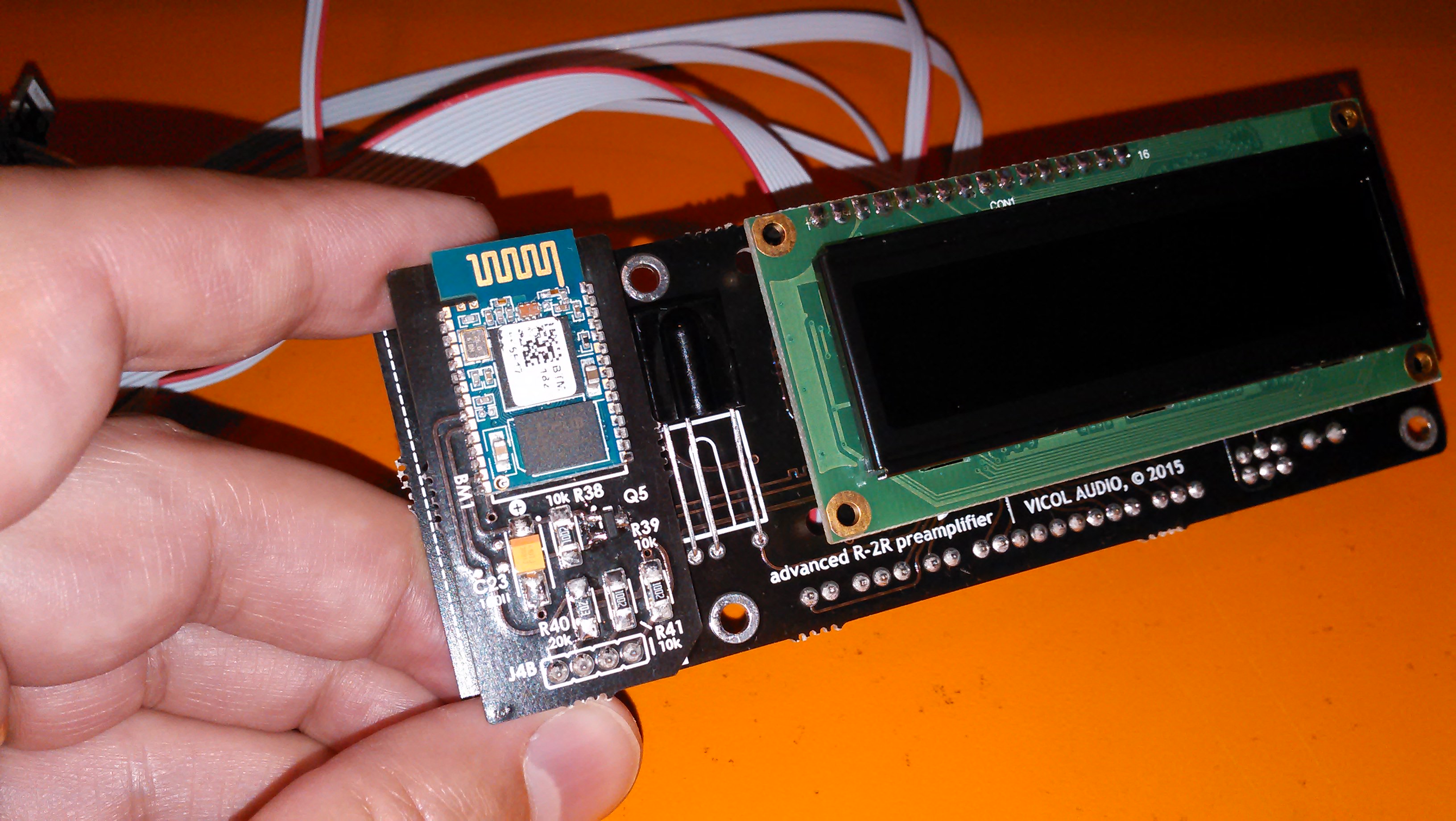

Looking around, I found a very interesting alternative for the BPPBP.
The solution is based on the Vicol Maya R-2R solution.
The name R-2R in this respect is a bit misleading because they are steering a 6 bit logarithmic attenuator enabling 64 steps of 1 dB each (and not a R-2R ladder network).
However, their attenuator setup is different, but the CPU part which is located on a separate board, interfaces with open collectors to six volume relays and the selection of four input channels.
The CPU board includes an learning infrared interface for a RC5 remote controller or a NEC (Apple) remote controller.
But it can also be equiped with a Bluetooth interface, to enable the remote control from your Android GSM.
But a rotary encoder is also be attached to change volume and for control functions.
Last but not least, it also has a display, either LCD or OLED.
All you could wish is there, even including the option to install new software releases.
All that is missing is a simple and small relay board having 2* 14 resistors plus 6 relays, to replace the pot.
You will get a control range of 63 dB with a 1 dB stepsize.
This new Relay board can have the same mini size of the existing manual relay board that has 16 steps of 2 dB.
If there is any interest in this combined solution, I will be happy to design this relay board and make the Gerbers available for free.

Additionally, I just got the following price information from Tibi, based on 100 PCB's.
Price will be 140euro for each unit with bluetooth module and OLED display, or 110 euro without bluetooth module and with LCD display. There is a different firmware for OLED than LCD.
And one correction to my previous posting: the relay board is not steered over open collectors, but over an I2C interface. One digital chip will therefore be needed for the volume control and one for channel selection.
Hans
