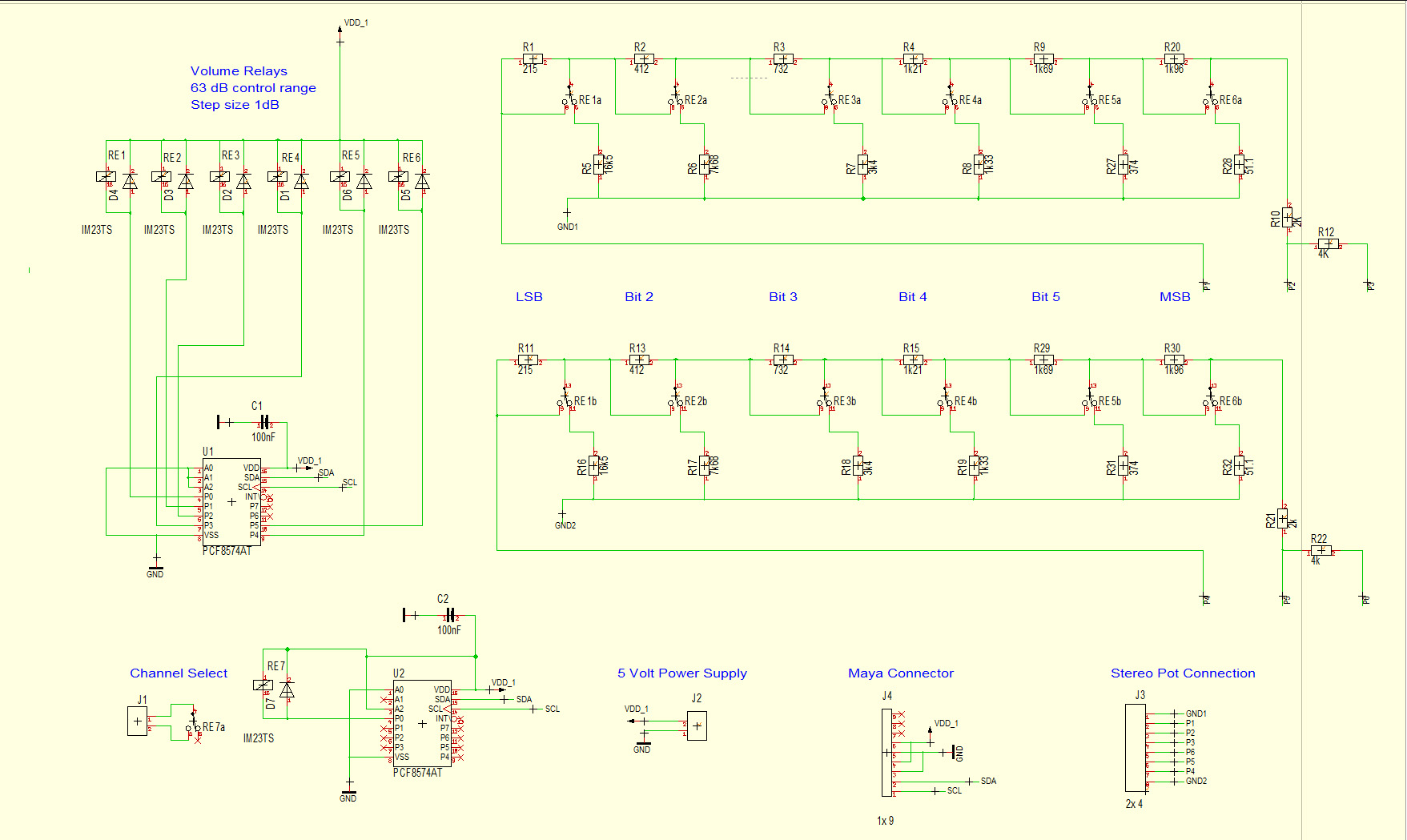

This is the concept circuit diagram to replace the analogue pot for a digital one.
Steering is performed from a MAYA CPU based remote controller with OLED display.
I have included one relay RE7, to replace switch S1 on the BPPBP, to enable switching between the two input channels through the remote control.
Is there anybody who would need a balance control, because this might be possible to be added in three steps as follows: L/R, +1dB/0dB, 0dB/0dB, 0dB/+1dB.
On the other hand, it will make the PCB bigger because of 2 extra relays. I have personally never felt the need for a balance control.
Hans

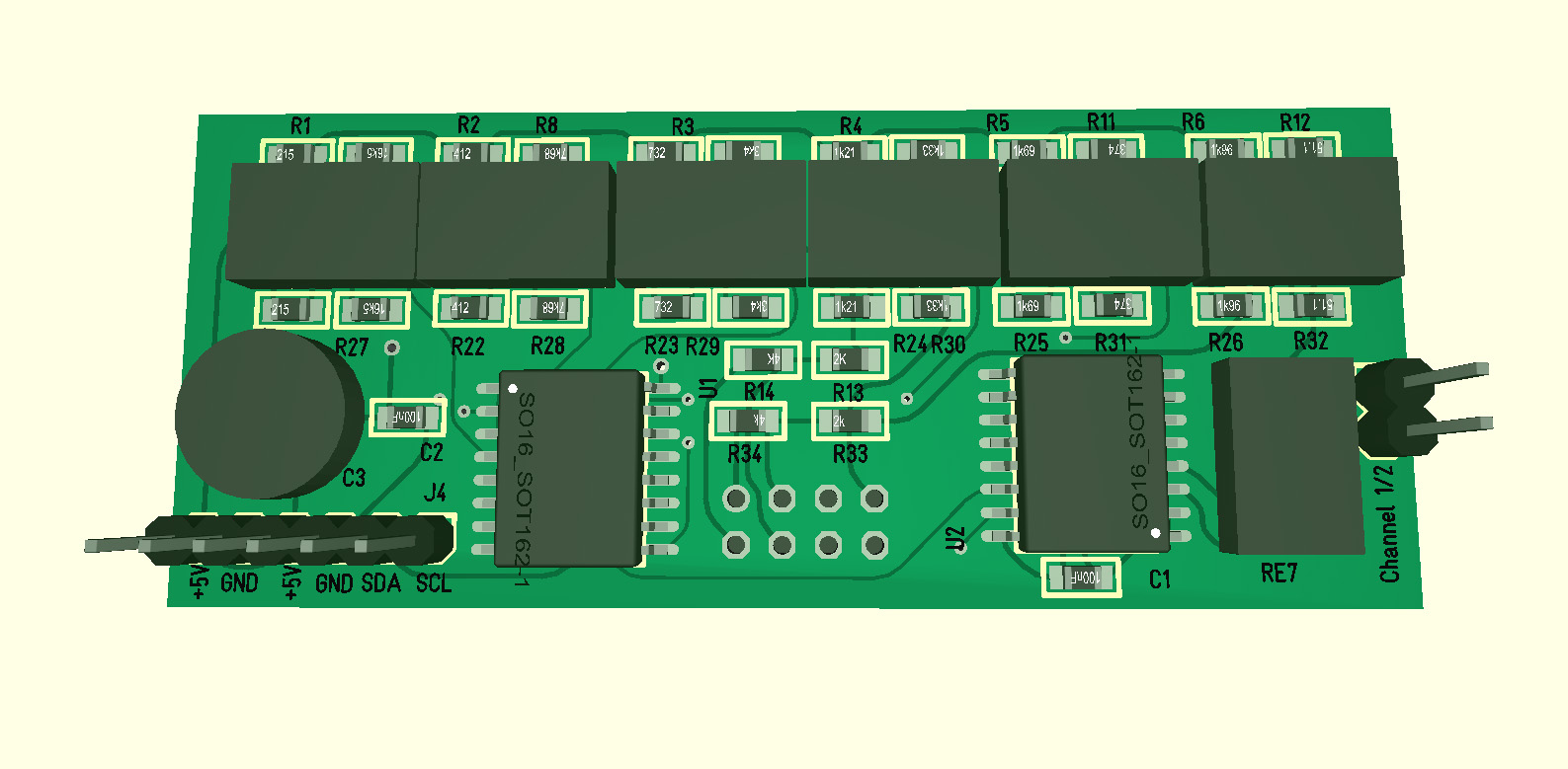

I have finalised the PCB design.
Dimension is 68 x 28 mm.
Flat cable from MAYA can be directly connected. This includes the 5V Power Supply.
On the back side of the PCB the connector should be positioned to replace the analoque pot.
The extra 2 pins on this connector called GND1 and GND2 are to be connected to the + inputs of the resp. output Op-Amp.
Connector J2 should be used to replace S1 on the BPPBP to enable switching between the two input channels with the remote.
The Gerbers are available for free.
I won't go into PCB production, but will support whoever needs it.
I skipped the balance option, because it will need a software update.
Hans
