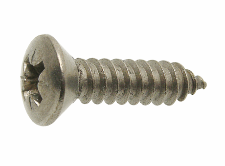

I thought I'll be really clever and use Google first, to try to find out for my self (DIY) what a blank parker is !
I failed.
Please tell me what a "blank parker" is
What are "Countersunk parkers"?
I'm guessing machine screws, though what a blank one is ?

Sorry for the confusion.
A blank Parker is not covered by paint or any sort of electro-plating.
So it is naked Stainless steel, that's what I meant with blank.
And a countersunk stainless steel parker is here.
