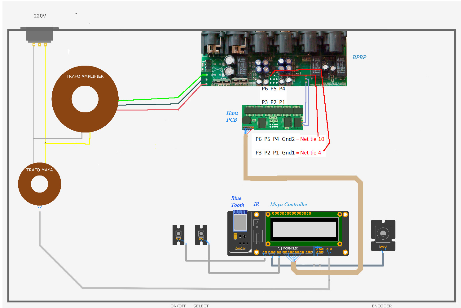

The PCB is the ready assembled with smds from the Group Buy.There must be something horribly wrong.

I only added the big components.
I did have to tap into the two (left and right) "net-ties" for the 4th connection for the attenuator. It has a ground in addition to the three pot tappings.
Hmmm to ground you say? But then the balancing-concept of the BPBP is not fully intact any more.
As I read the description you should connect the 'gnd' end of the attenuator to the op-amp input side GND1-> P1 and GND2 ->P4 ....
Hans, what is the correct way to connect it?
The right channel "net-tie" is connected to the right channel +IN pin.
The left channel "net-tie" is connected to the left channel +IN pin.
Look at the PCB, you can see those connections. They are adjacent to each other, the trace is tiny in length.
The two "net-ties" are separated by a very big plane distance. That is equivalent to a non zero impedance.
