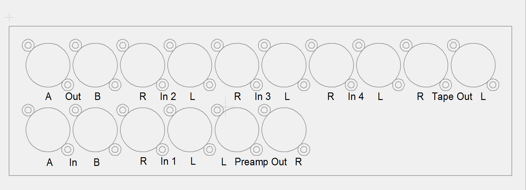

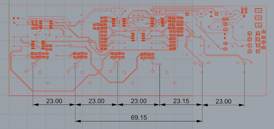

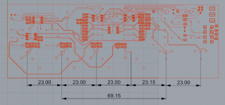

Has anyone shared a Front Panel Designer layout for this board? I read this and associated threads quickly but didn't find anything. I know it shouldn't be hard to do, but I can't figure out the center to center spacing until I get the boards in hand.
Thanks for any help.
I'll be doing a layout soon, but in Fusion 360 probably.
I just checked the XLR spacing the other day from Gerbers - it is 23mm center to center for all (well, one seemed a fraction more according to CAD, but thats really minor).

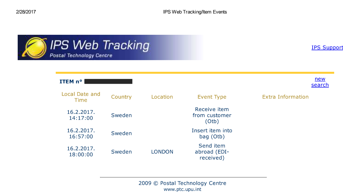

Hi Xavier,
It seems that my shipment is lost somewhere on the way from London to ???
I contacted a local mailing service and this was their (translated) response:
"Regarding your request, we want to inform you that the said consignment is not arrived in Croatia.
Therefore, please contact the sender, about the possibility of starting the inquiry process."
Therefore, I would be grateful if you could look at what happens to my parcel.
