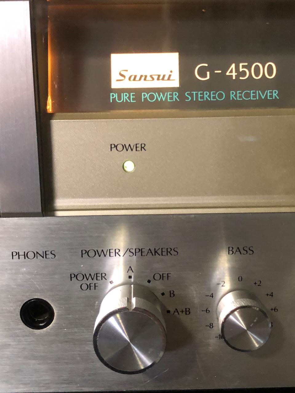

NEED HELP finding a rotary power switch.
Hi All,
I need to find a rotary switch the will switch Mains AC power and low voltage. It would be something similar to this one used in the Sansui receiver.
What I want to do is to replace the power switch that comes with the A9 amp with a 3 position rotary switch so I can have the following options:
Position 1: Mains power OFF
Position 2: Mains power ON and normal bias (500 ohms Rk for original designed plate current)
Position 3: Mains power ON and higher bias (300 ohms Rk for higher plate current)
The switch should work the similar way Sansui uses it to switch power and speakers.
The photos are only for reference. The switch does not have to be like the one in the picture but it's important to have the Mains switch section separate from the low voltage switch section.
Thanks for the help.
fdlima

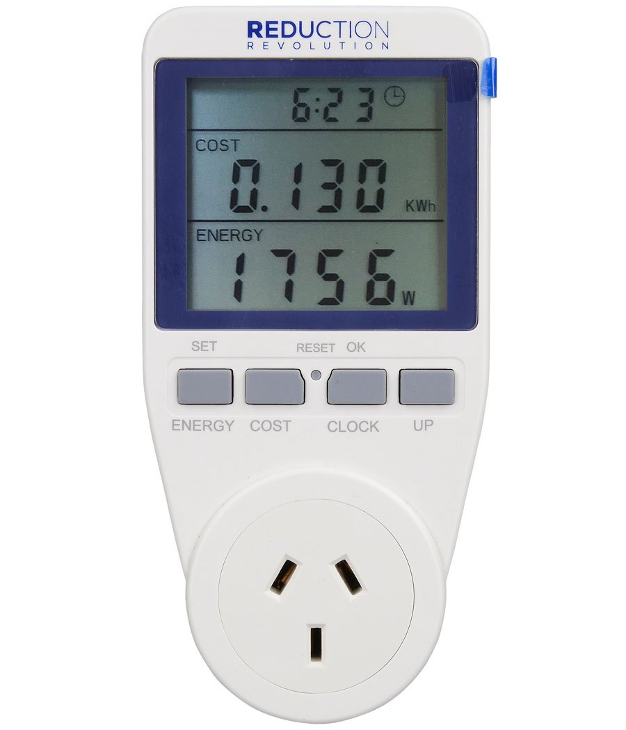

the EL34 Pin 1/8 resistor : Plate current: %plate dissipation :gross AMP power comsuption are as following:
470ohm:46.67ma:60.12%:83.9 watt
435ohm:50.53ma:66.09%:90.2 watt
277ohm:64.70ma:75.9%:101.9 watt
How did you calculate the gross amp power consumption?
Thanks, I just ordered one on Amazon.
For that price, it's a good gadget to have.
P3 P4400 Kill A Watt Electricity Usage Monitor - Low Temperature Alarms - Amazon.com
