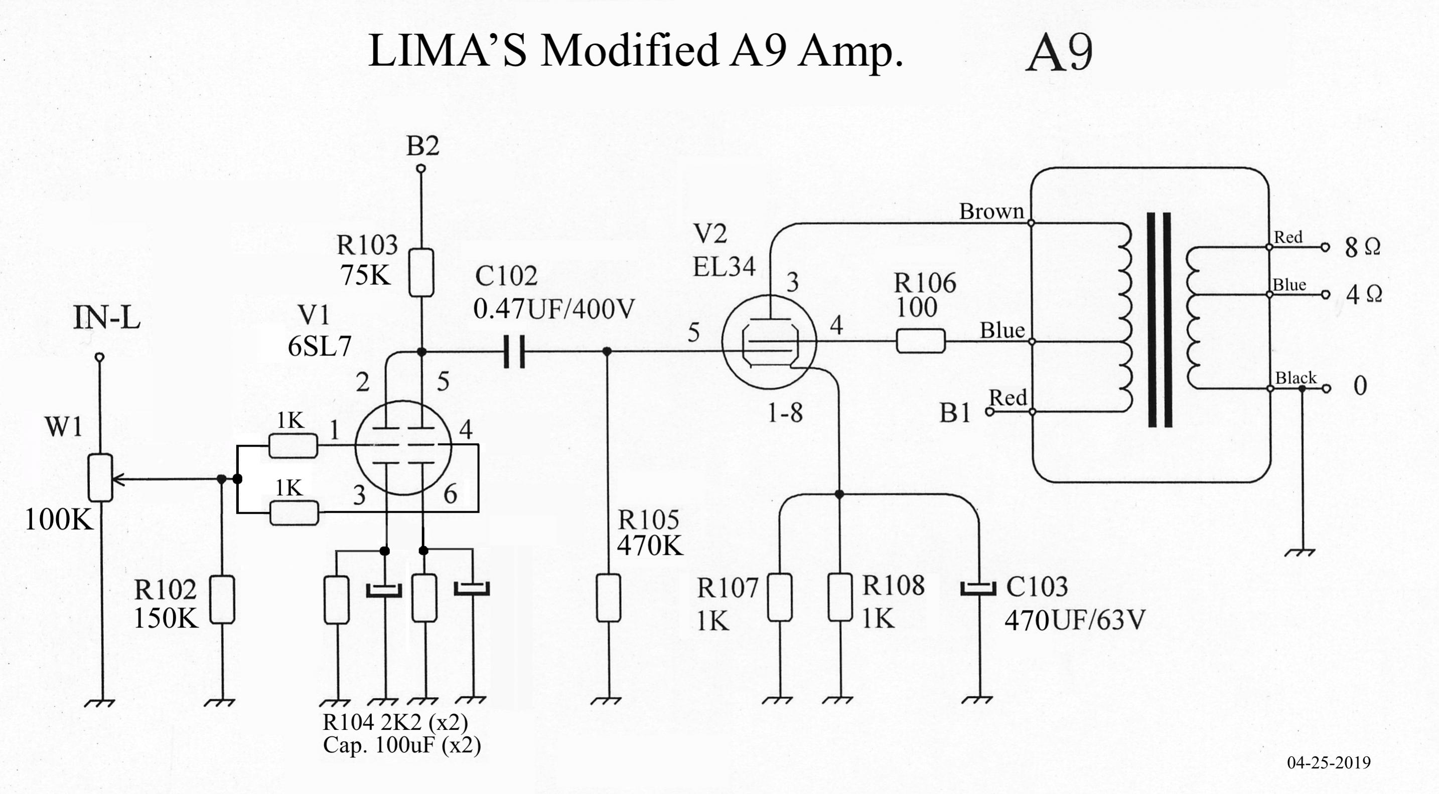

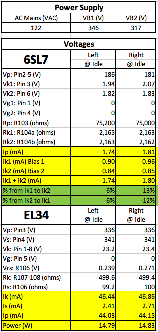

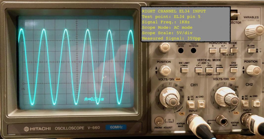

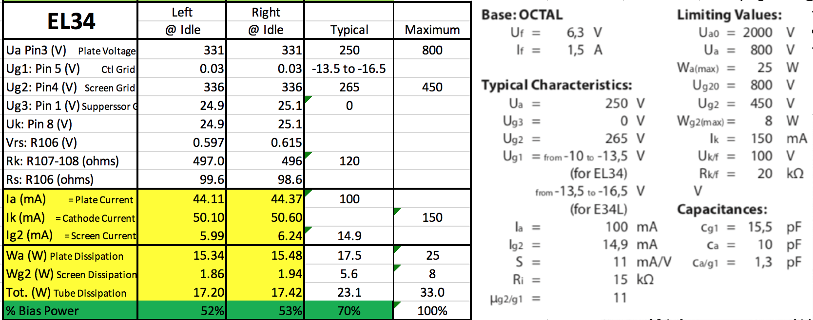

I've done new measurements and the results are much better now. I have not changed the circuit so I guess I did measure wrong the output of EL34 last time.
Please see the modified diagram for my A9, the wave form pictures and the voltage table (White cells=measured, yellow cells=calculated), and please double check my calculations below:

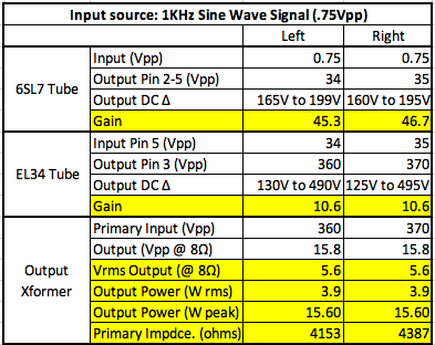

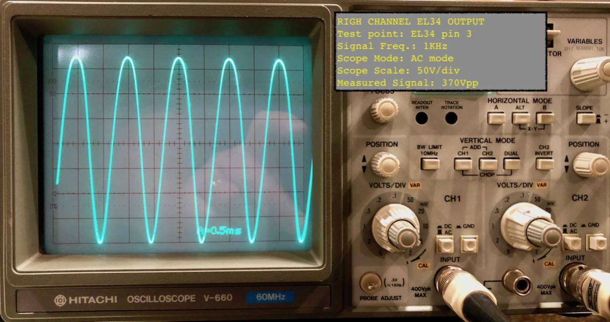

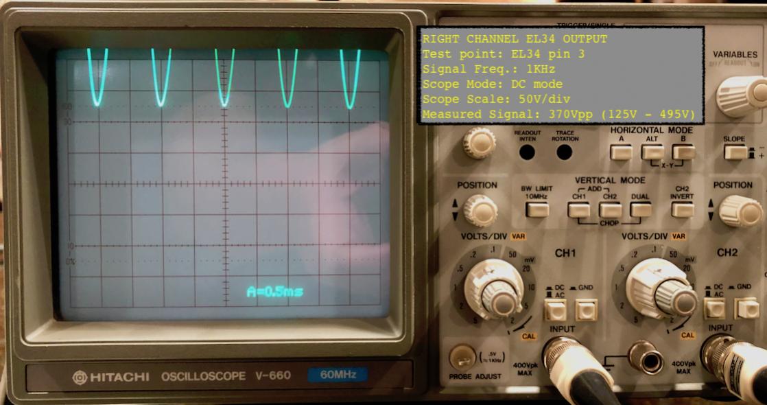

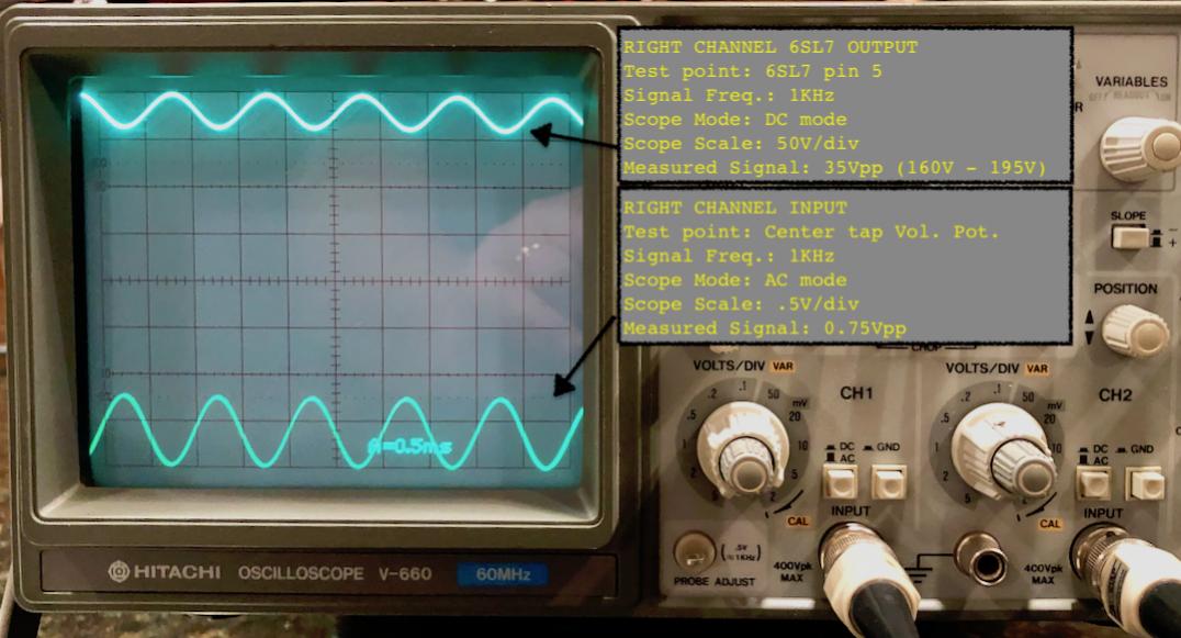

New EL34 measurements:
Input (pin 5): 35V peak to peak = 17.5V peak
Output (pin 3): 370V peak to peak = 185V peak
So EL34 gain is 10.6 (which is close to the EL34 specs of u = 11)
Question: The output voltage swing is from 125V to 495V. Is this correct to go up to 495V? This is much above the B1 voltage

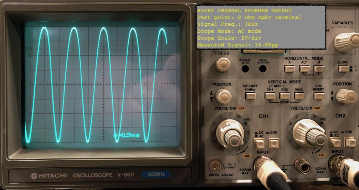

Output of transform (at 8 ohm terminal):
Output: 15.8 peak to peak = 7.9V peak
P = ((V peak) squared) / (R x 2)
P = (7.9V peak squared) / (8 x 2)
P = 3.9 Watts rms
P = 15.6 Watts peak
Question: Is this the expected output power for EL34?
Is the advertised power for this amp is in Wrms or Wpeak?
I don't have a way to measure the transformer primary impedance so I used this formula to calculate it... assuming no loss:
R = ((V peak) squared) / (P x 2) << Isolating R in this formula:
R = (185V peak squared) / (3.9 x 2)
R = 4,387 Ohms << Does this number seem right to you?
Thanks and I'm looking forward to your comments.

Frank,
The EL34 peak plate voltage of 495 is OK. That is when there is very little current in the plate. The plate is rated for up to 800V. In Ultra Linear, the screen voltage increases above B+ by 40% of the increase of the plate voltage. 495V - 185V = 310V. The B+ is near 310V, and 0.4 x 185V = 74V. The peak screen peak voltage is about 310 + 74V = 384V, and the EL34 screen is rated at 450V.
In triode mode (but not the UL you are in), the voltage gain is u x plate load/(plate load + plate resistance). The plate resistance is perhaps 1400 Ohms. 11 x 4,387/(4,387 + 1,400) = 11 4,387/5787 = 8.33 (EL34 gain)
In UL mode, the effective gain is about 2 to 3 x u, and the plate resistance is about 2 to 3 x the triode plate resistance. You got an EL34 gain of 10.6. That seems reasonable.
You are correct in calculating 3.9 Watts rms.
Peak voltage is 1.414 x rms voltage.
Peak current is 1.414 x rms current.
But the peak power is 1.414 x 1.414 times rms power (2 x). That is 7.8 Watts (not 15.6 Watts).
The manufacturer rates the amplifier power according to whatever the marketing group decides to call it. I suspect if you drive the amp very hard into clipping, you might get 15 Watts of extremely distorted power (almost a square wave).
Another way to calculate the output transformer primary impedance is:
185V/7.9V = turns ratio of 23.4.
Impedance ratio is the square of the turns ratio
(23.4)squared = 547.6
547.6 x 8 Ohms = 4,380 Ohms
And this assumes a lossless transformer.
I hope that helps.

pelanj,
Post # 6 schematic has the input tube grid pin 4 open (no connection). Needs to be tied to pin 1. See if you can put grid stoppers at pins 1 and 4, and from there to the rest of the input circuit.

The plate current in my amp is 44mA. Should I increase it to get a better sound? if yes, how much should it be increased?
Have you calculated the EL34 plate dissipation (in Watts)?
You sure? That seems quite low for this amp.

the EL34 Pin 1/8 resistor : Plate current: %plate dissipation :gross AMP power comsuption are as following:
470ohm:46.67ma:60.12%:83.9 watt
435ohm:50.53ma:66.09%:90.2 watt
277ohm:64.70ma:75.9%:101.9 watt
my main purpose of dong this is to find out how it is possible to replace EL34 with KT88, most people 's opinion , after I googled, they think it's necessary to adjust the bias. By my own calculation, without changing the bias resistor value, KT88 will consistently drop 3-4% bias point compared to EL34. in the real world measurement, for example KT88: 435ohm:68.8ma:57.5%:107 watt.
the causes of the theoretical number and real world results , I guess , the tubes quality are different, my stock Shuguang tube, by measuring, Left and right channel bias point can have 4% difference! matched pair Psvane tubes are better, (within 1%). I use u=11 (EL34) and U=8 (for KT88), no doubt in realworld this is not always the case.
my conclusion is, definitely you can safely replace EL34 with KT88 (in the Boyuu kit) I can see most people recommend bias the tube at 90% for class A amp, but lots of people were very happy with 60% and they reckon the sound was the best! I tend to agree with this , bias at around 60% of max plate dissipation for both EL34 and KT88 you will have the satisfactory results! Only concern is the power supply transformer, according to my new kit description, it was supposed be a 200watt transformer. I think it's safe to for my AMP to run a gross 106watt.

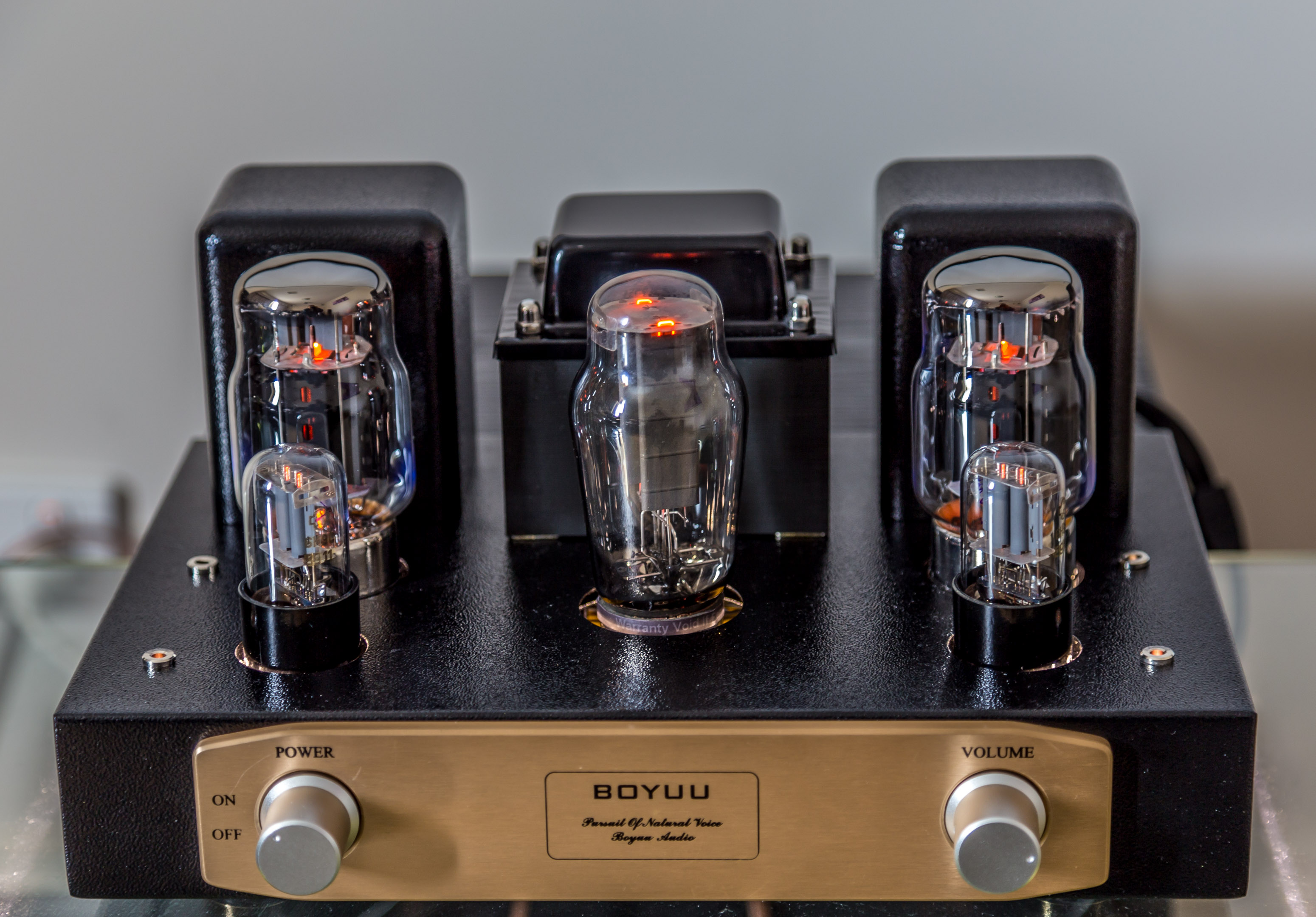

I am very excited after I finished this project. This is the first amplifier I have built since more than 30 years ago.
I guess it must be true love of tube sound. Recently I somehow picked up this old hobby, and realised so much new technologies available! I purchased a class D amp 50watt with bluetooth! it's a DIY kit , but I only needed to put it into the plastic enclousure, I will not claim that was a amp I built. It's so convenient and easy to use, and the sound is loud enough to drive the desktop speakers, but the quality of the sound can't compare with the tube. It's a learning curve, I spent some time in last 3 months to go through Morgan Jones' valve amplifiers, and a lot of online youtube and this forum. This is the great place to learn stuff!
I bought this A9 kit from local ebay seller with surprisingly low price AUD276. I checked and tested everything before starting. Even using low voltage AC to test and estimate the output of the transformer. But what I could not check was the tubes, the 5Z3P turned out to be DOA. I had to wait the longest 2-3 weeks in my life before my order from China arrived. (remember, I am new to tubes and I didn't know i can order a 5U4G locally to save delivery time).
So I probably checked my work dozens of times. Actually, you really can't make any mistakes, after you measured every resistor, capacitor before hand, and each channel you only need to solder 6 resistors and 1 capacitor, what's your excuses to make any mistakes? So I plugged in and hooked it up with a pair of the more disposable speakers. The amp worked straight away, no hum at all. I was glad with this boring result but I am very impressed with the sound after it burned in a bit. Then I worked out to change to KT88/UK , very nice sound! Thanks everyone here for all the advice on this project! It's so therapeutic process for someone at my age.

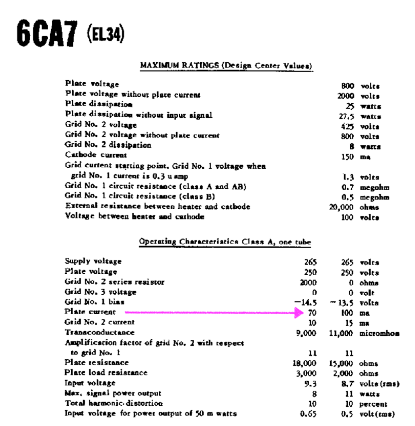

Just for curiosity, what plate current did you end up using for your tube? Because I've seen many posts on the internet recommending 70mA for the EL34 in class A amp, including in the specs in this link http://www.tubezone.net/pdf/6ca7.pdf
Thank you Fdlima, for sharing and understanding the joy of achieving this project! The short answer to your question is, I am using the 435 ohm bias resistor (Rc, cathode resistor, the one from EL34 Pin 1 and 8 to ground), when I am using 5z3p rectifier tube, I would get B+ about 338 Volt ( I removed 39 ohm R301), plate current 50.53ma , Cathode current 51.3ma. bias @ 66.09% of max plate dissipation.
When I first built this Amp, everything was same as the schematic shows, (only for convenience Rc=470ohm, not 500ohm), I had the 39 ohm R301 in line to supply B+. So I got B+ 330 volt, R load, which is the DC resistance of the transformer, I measured before started everything, was 204 and 205 ohm for L and R channel. I assume those values will not change (in fact B+ would change all the time! Unexpectedly). I have to do the theoretical calculation here, so ignore it for now and we can change it if we get another real value when circumstances change.
EL 34 , u =11, u is the amplification factor,
-Vg= (0.68* plate voltage)/u
The voltage drop on R load is : 0.07 (70ma, your target plate current) *205ohm=14.35 volt
The plate voltage=330-14.35=315.65 volt, so -Vg=19.51 volt.
Rc (the bias resistor) roughly =-Vg/0.07=278 ohm
I also measured the screen current from pin4/g2 was about 1-2ma, will contribute to Cathode current, so it should be 0.072, some people say the screen current contribute 5% of cathode current, it’s a bit higher than I measured. I don’t take this into consideration anyway.
So now at 70mA , with plate voltage 315v, percentage of bias to the max plate dissipation (25watt) is: 88.38% , this is pretty close to the recommended 90%! You can even increase it to 71.4mA to make it 90%.
Now we can see, the plate current increased from 46mA to 70mA, the Amp total power consumption increased from 83w to 102w(at least), almost 20 watt more, how much change in the sound? I really don’t know, not much, some will say it’s warmer??? I don’t know how to justified the power consumption increased 25%.
When I tested in real time, Rc was 277 ohm, my B+ dropped to 301 volt! –Vg only 18.4 volt, B+ to Pin3 voltage drop was 13.4 volt, so I got bias current 65mA, bias point @ 75%. In the end, I understand the original schematic set at 46mA, and everyone is happy. I would increase a little bit since I had nothing to do and tried to use KT 88 instead.

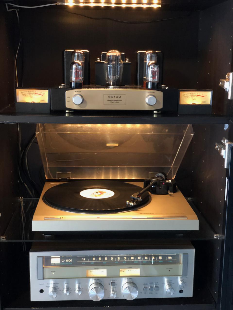

I'm using all analogue equipment so I don't need to worry about DAC quality 🙂.
I'm using a Pioneer turntable and a Sansui receiver. Both from the 80's. The receiver has pre-amp out so I leave my tube amp in max volume and I control volume, bass/treble, loudness and inputs through the receiver. It works pretty good.
