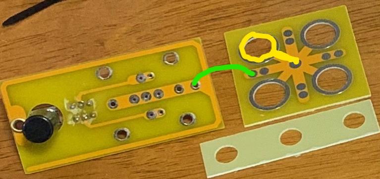

- I was a bit paranoid about having only a single ground for the signal connections, and then only one connection of that to the chassis ground.
That’s absolutely true. As I have never experienced any hum noise since I first built this tube amp, I will share what I have done , which I think it’s important. In the picture one, I drew one mental piece there. There are 4 of those, I soldered all 4 together in the centre of the board (the middle of the cross). And I connected this board to the other one (on the left ) using a cable (ground). This will make sure there is no loose contact.
I would drill a hole in the middle of the cross, if I would build this a second time. And using a sparing resistor arm put in the hole and solder all the 4 tags together. The other thoughts about this amp:

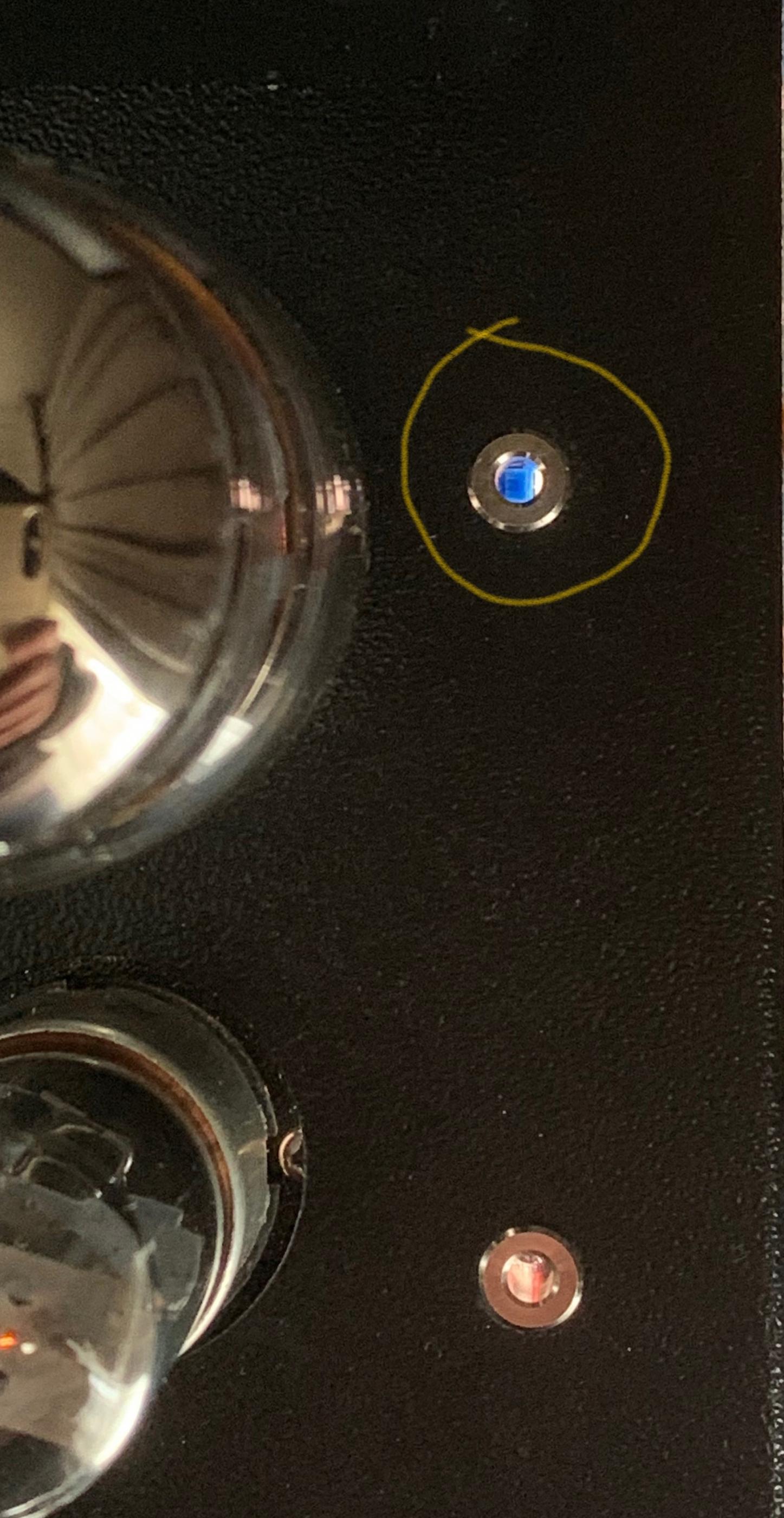

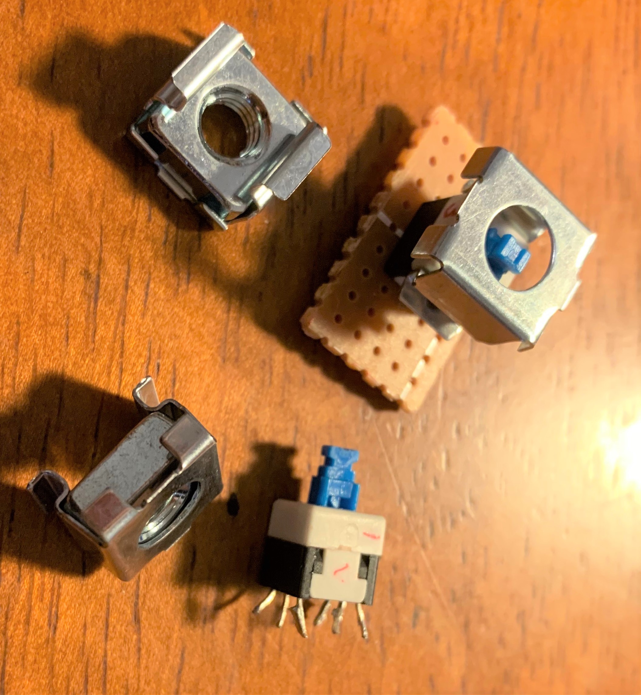

I am not good at making big holes in the steel panel to add a couple switches. In picture 2, I found this ‘M6 captive nuts’, and the ‘latching tactile push button switch’, I managed to mount it under any of the 4 holes in the tube side of the chasis. In that way I can have swtich(es) to change for UL/Triode , or different bias resistance. In picture 3 , I use a match stick to insert into the hole and push down the button to switch.
To be honest, in the end I think it’s not necessary to have switches. I like the Triode mode so much, I can’t stand UL mode. I can’t wait to switch back to Triode after I listened in UL for 10 minutes. I tried many times, interesting. Mostly I listen to jazz, triode is much better!

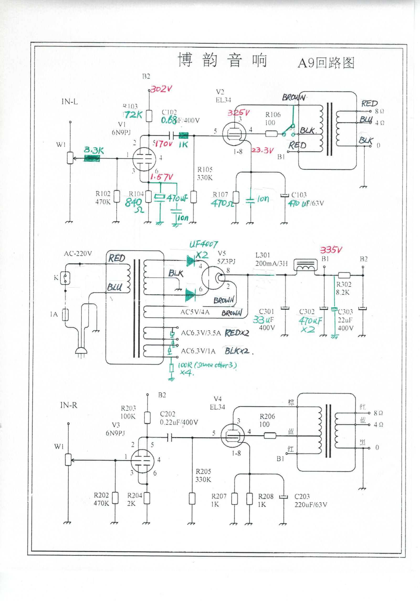

As for the bias , smaller Cathode resistor for EL34 (R107) doesn’t make the sound warmer to me , it is already warm enough for me. Anyway I use a smaller Cathode resistor for KT88 when I rolling tubes (it sounds good even R107 is 500 ohm).
I managed to increase the ripple filter capacitors (for B1), actually it is 1000uF now. I got the answers from forums that high capacity will not harm the rectifier tube as long as they are placed after the choke. Well, this’s not 100% true. The 5Z3P was sparking at the moment I turn it on!(considering the high charging current for large caps), surprisingly 5U4G doesn’t spark. I am sure sparking every time I turn on the cold amp is not healthy for the rectifier. It might be my faulty I have removed the 39 ohm (R301) for some time and it worked OK until I increased filter cap. ( I removed R301 just because I don’t like the idea for it sits there produce 5 watt of heat and doing nothing!) Well now I can see it prevents sparking, it never sparks again after I put the R301 back (only need to disconnect the short cable on top of it).
When I researched sparking issues, I found it’s good idea to put 2x diodes before the power transformer lines entering Pin 4 and Pin 6 (of 5Z3P). I did this simple modification using 2x UF4007, very good results, and I removed R301 again in the end. No more sparking. IMHO, the sound seems somehow different, and I like it. Also, before this, I can hear very faint baseline noise within 5-10 cm distance of the loud speakers, now they are dead quite . I am not sure if this has anything to do with the UF4007s I put in line .

Hi Huggygood,I don't like the R301 (39 ohm) causing B+ voltage drop 5 volt. It creates about 1-2 watt of heat inside chasis, I checked many other schematics, this resistor design is not compulsory. But again, I thinks it's a good design, very safe design for A9 as a kit.
The sparking problem was only created when i put in total 1000 uF filter cap, I really like the large cap filter that brings on lovely bass. I would rather fix the sparking issue than reduce the filter cap. Then I have 2 options, one is put R301 back, the other one is, using UF4007 before the rectifier, both work well, the latter, I don't need R301. UF4007 prevents sparking and protects the rectifier (even you don't have a sparking problem) as many users recommended. I didn't expect any sound improvement just wanted to fix the sparking, subjectively I noted the sound is 'cleaner' after I put in UF4007, I am still not quite sure to be honest.
I tried not to take big risks , only the ones within reasonable range, it's fun to try and fail. Cheers, Daniel

That 39 R resistor reduces hot switching currents, and of course the large charging currents. It doesn't affect the bass in any way. That, i suspect, is a case of confirmation bias.
Before you start "designing by ear", have a look at tube manual specifications for the tubes you are using and you will often find that something you don't see a need for actually has a very good reason to be there in the design.
The energy stored in a filter capacitor goes up as the voltage squared. 1,000 uF is massive and I greatly suspect another appearance of confirmation bias. Most older amplifiers that would deliver thundering bass had a single 47 uF capacitor with 400 ~ 450 volts on it. That 47 uF is also about the maximum recommended value allowed for most tube rectifiers. I feel 100 uF is excessive (and it is as far as rectifier tubes are concerned).
So testing various ideas is fine - as long as you stay within safe boundaries established by all the fine minds that existed before you appeared (or me for that matter).

Hi Chris,
That 39R doesn't affect bass for sure.
As I mention above, the first cap immediately after the rectifier has it’s limited , I left as it is (22uf), I would not even risk to increase to 47uf, which is about the limit for the rectifier tube. Most people agreed there is no definite capacity limit about the filter cap after the choke. It’s not uncommon people use 470uf or 680uf after the choke. I agree I should have left the 39R there for safety reasons. In single ended tube amp, the large filter cap will not ‘stiffer the bass’ as it happens in push and pull amp, but I think larger cap will affect the sound quality in the way of reducing ripper current and hum.
The rectifier tube always works in tough condition, I am sorry I didn’t make its life any easier, I might put 39 R back.
Daniel
Daniel
Hi Daniel,
No sweat. After a choke you can indeed increase the filter capacitance. However, I haven't seen really large filter capacitance help in the bass department at all unless you're at very high power - same as with a solid state amplifier. If you're running that high, chances are you are also clipping a fair amount.
Your 22uF first filter could probably be safely increased depending on the rectifier. 33uF is a commonly stocked value as well.
Your second filter capacitor can indeed help with supply hum. Another approach you can consider would be to supply your gain stages through a solid state regulator. You will probably find (hint) that this type of supply will also reduce all kinds of noise and signals in the background. That is dependent on how good that regulator is. That leaves your output tubes "open" to whatever is on the B+ voltage rails. Feedback will then decrease that noise because it is compared to a circuit that has a clean supply voltage. I have found regulators incredibly helpful to have. Any suggestion that you can hear a solid state regulator isn't accurate - as long as it works well and properly. I'd have suggested a tube regulator except they aren't quite as effective and the additional demands on the power transformer are valid concerns (budget, heat, complexity). Any argument that a regulator spoils the idea of a simple class A single output amplifier is forgetting that they were not using 470 uF supply capacitors, never mind 1,000 uF ones!
Anyway, you can try it and if it doesn't work for you, then use it for a bench supply when you are developing or testing preamp circuits. It won't be wasted.
These are only things you can think about and, hopefully, to try if you are curious at all. The higher the performance you can squeeze out of a project, the more likely it is that you will continue to enjoy it for years to come.

This is my final mod I drew the changes on it , It suits my taste and I decided to close the bottom cover and never open it again.. (in the near future)
