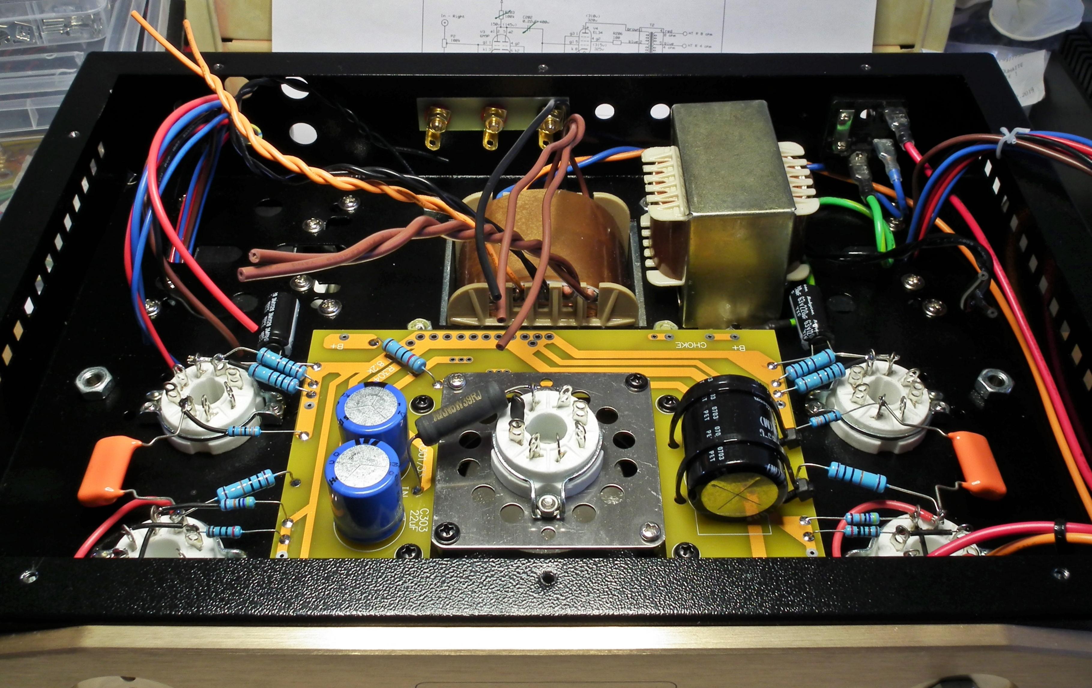

Hello everyone, I post a new image of the progress of work. If it can also help someone, it's even better. I ask for your help because I have trouble understanding where to solder the different ground points. See you soon and have a good Christmas.
Some nice clear photos here. (my amp although I didn't build it). All I have done is ground the speaker 0v terminals and add 2 resistors between the heater circuit and 0v to kill the remaining hum. Happy with it now, sounds great.

Hello trickyhicky270, thank you for your help but I couldn't access the link. I will do as you did. I'm going to connect the speaker 0v to earth.

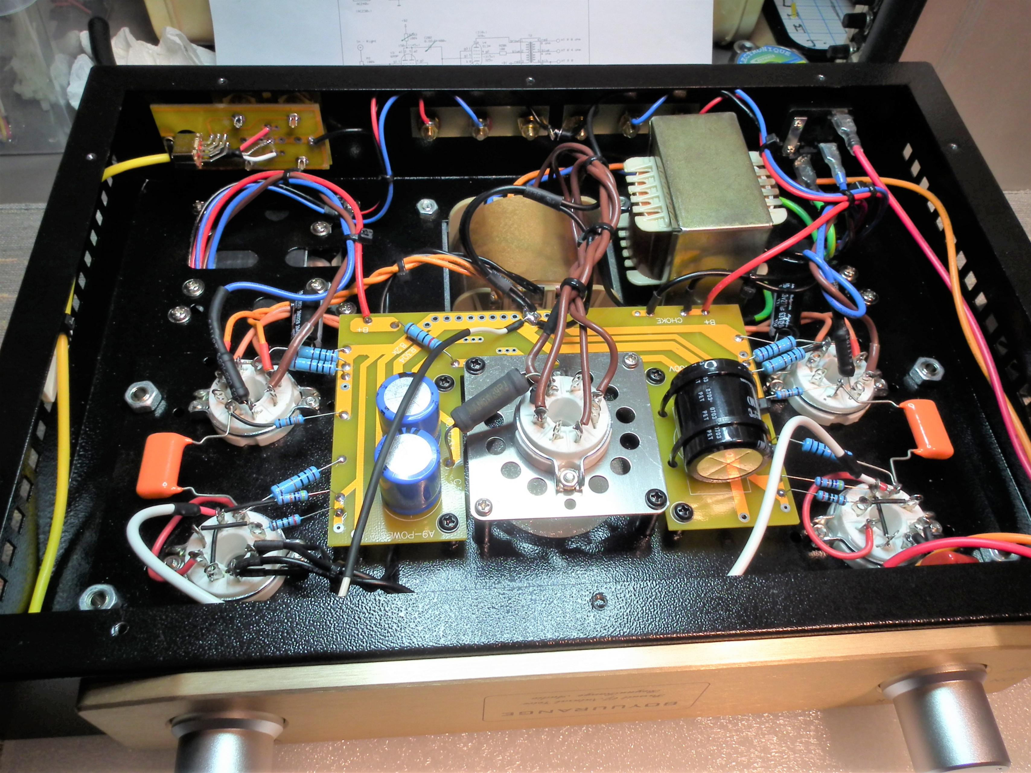

Happy New Year everyone. I finally finished assembling the Boyuu A9. The amp works well but I think I have a defective 6N9P tube because on the 1st start there was a permanent noise on the left speaker. I reversed the 6N9P and the noise went through the right speaker. Also the volume potentiometer is of poor quality because it generates noise which disappears then reappears depending on its position. I'm going to change it to one: "ALPS". See you soon.

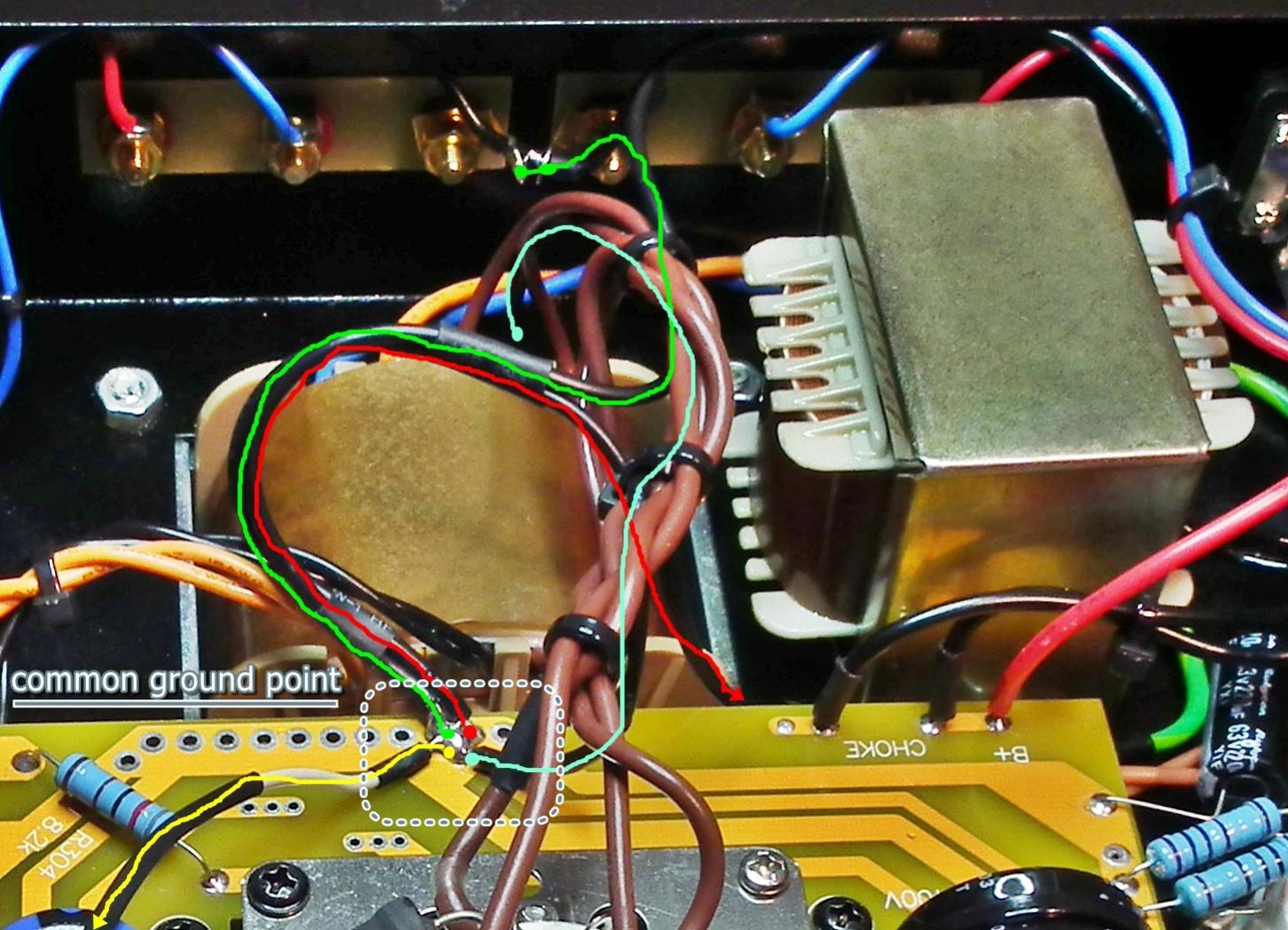

Hello Everybody,
Been following intently on this forum and have for the most part wired up this amplifier.
The one question that still remains for me is how do I ground this. I will post a picture to get some sort of clarification on what I should do next.
Thanks.

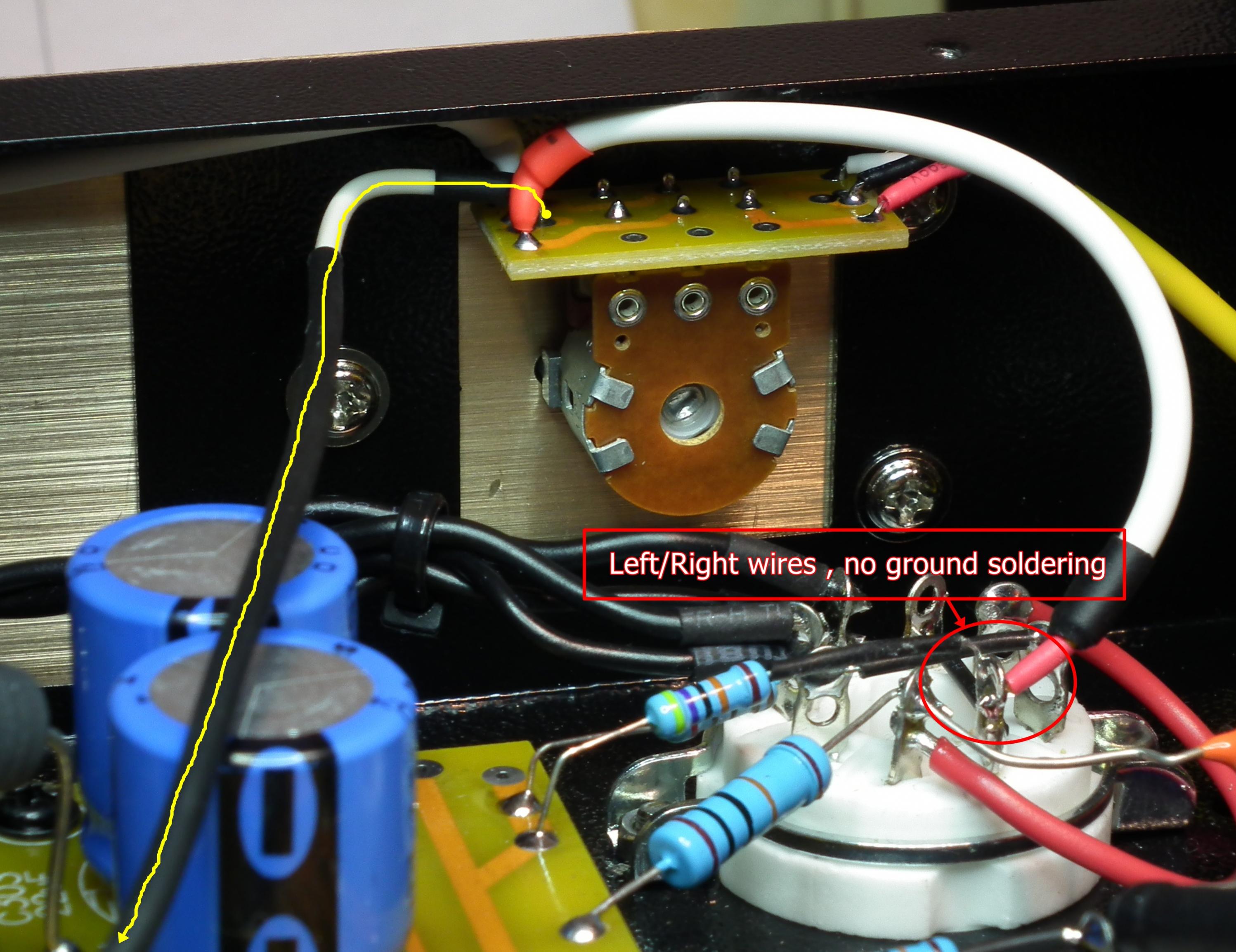

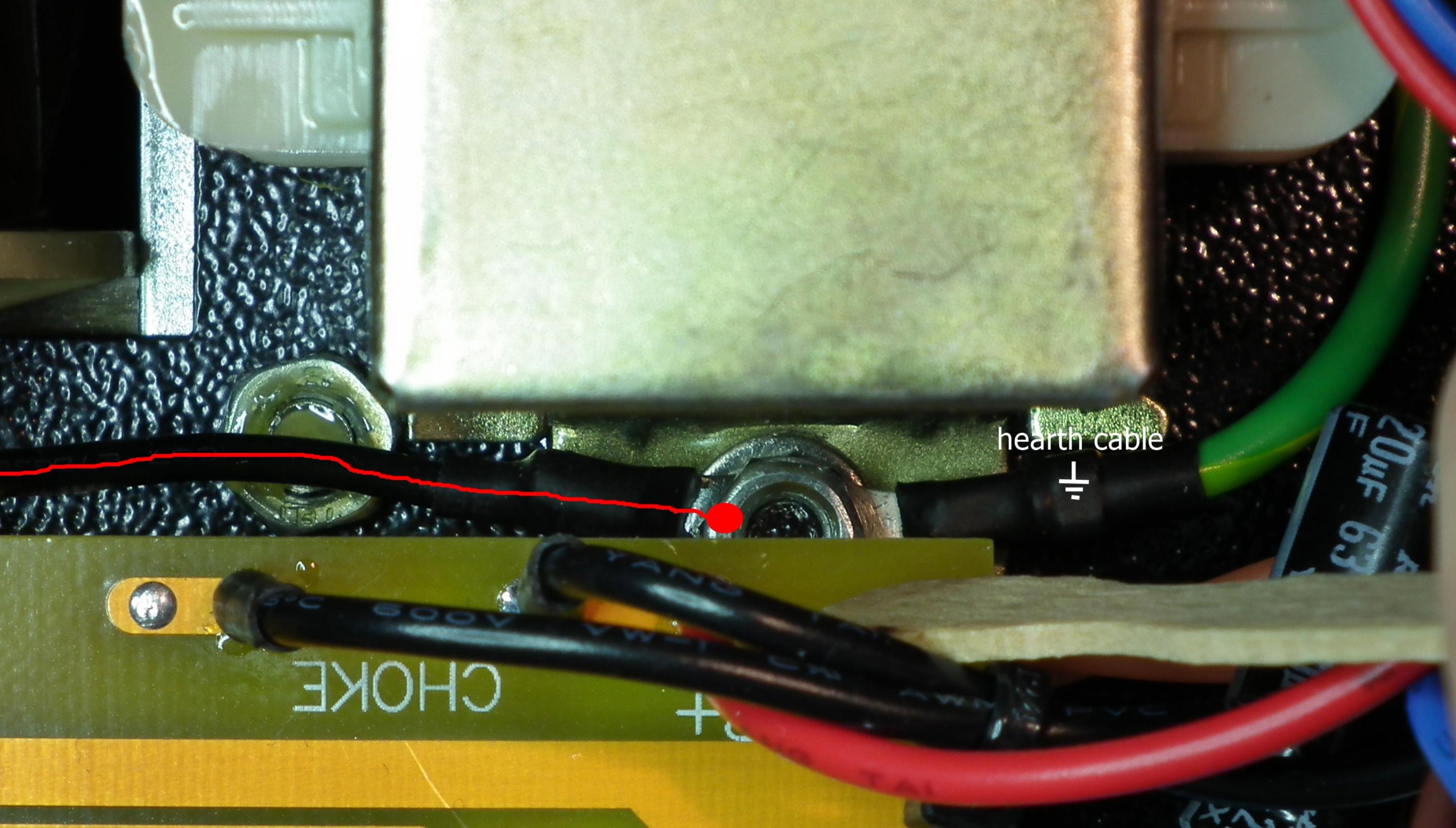

Hello, personally I wired like this:
Picture 1: green wire=speakers,blue wire=0V power transformer,red wire=to the ground,yellow wire=input audio signal.
**All wires goes to the common ground point on PCB.**
**For connection of red and yellow wires see pictures 2 and 3**.
**For an overview see picture 4.**
PS: Note that 2 connection points are missing which are explained by: "gregas" on page 46 (#458) of this thread.
I hope my comment is not too confusing.

Hi all! I have built the Boyuu EL34 A9 tube amp kit now, and have a problem with the "big tube in the middle". It does not get hot. I have checked all the soldering and double checked the position of the R301 resistor (in the circuit diagram that came with the kit it says to connect it to pin 8, but from studying the pictures it seema to be connected to pin 2). Could it be that the tube itself is bad? I have not yet measured the voltages, but enclose a thermal image.
Update: voltages measured and both the 5VAC and 315VAC is present. Measuring on the tube pins I get high resistance between pins 2 and 8 so suspect badly soldered pins. Will attempt to resolder all pins on this tube
I had the same problem, bad soldering to the heater filaments in the valve base cap. After 2 attempts at forcing solder up the legs of the valve base it is now working reliably. Check with a meter for continuity across the heater pins of the Rectifier tube or substitute a similar one.
I had a similar issue and i realized that the lines from the transformer was not on the right pins. I went back through and soldered the lines correctly to the right pins and it worked. Might just be an oversight, bound to happen.
