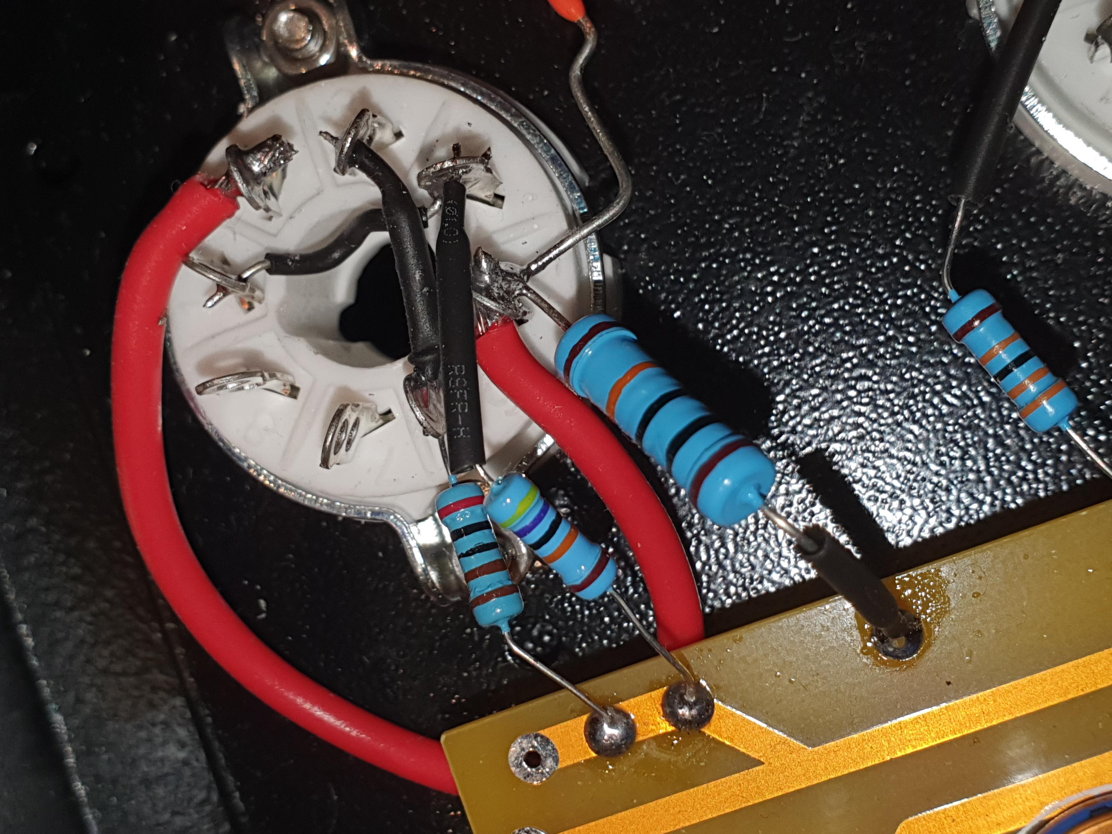

@learn can you give me some more detailed pictures of the inlay? I try to build the amplifier with your pictures. 🙂 For example I dont get the connection of the condensator and the resitors. 🙁

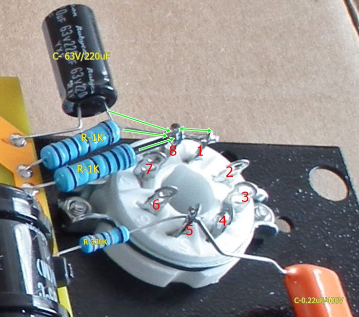

Thank you and best regards!

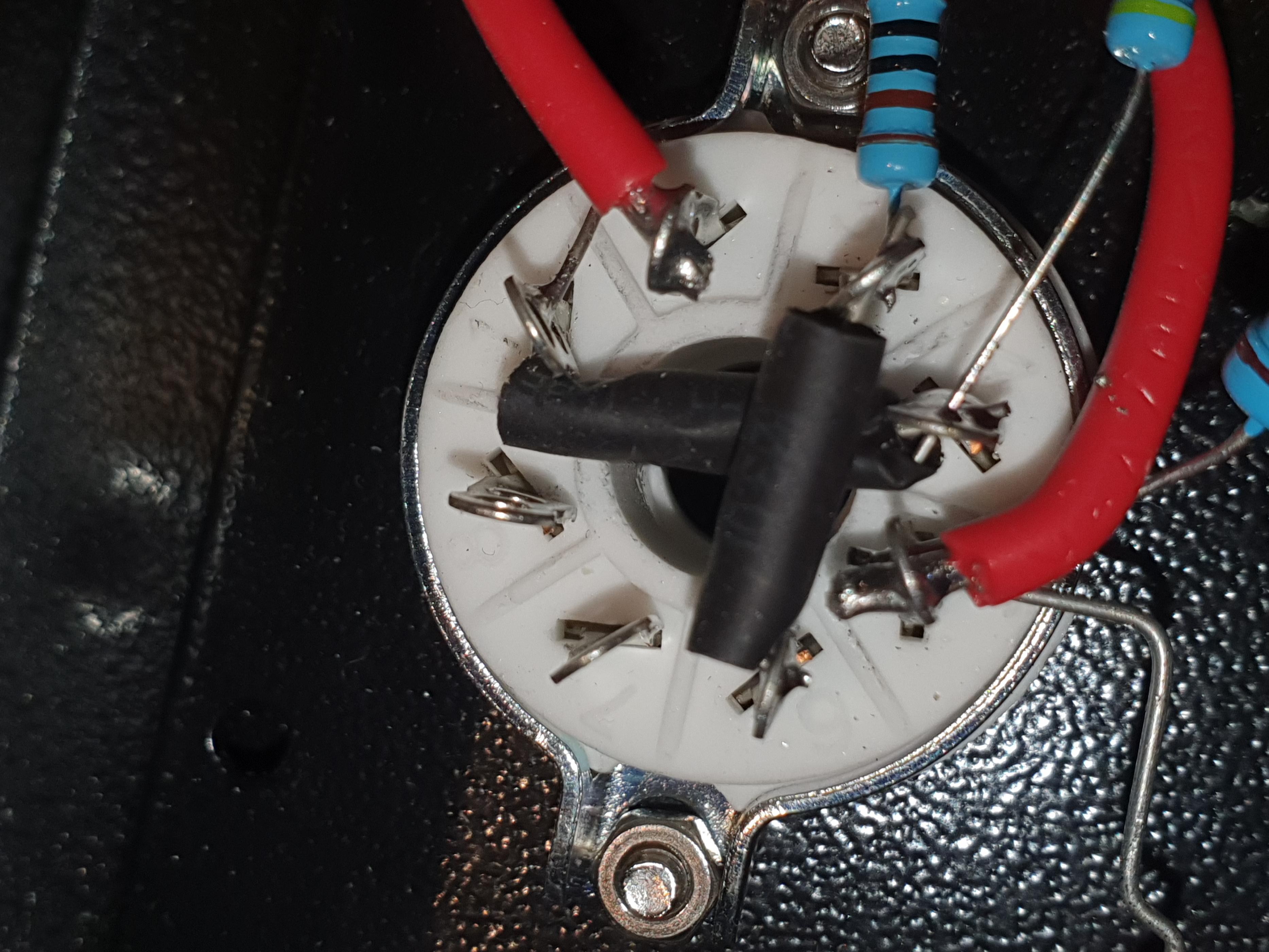

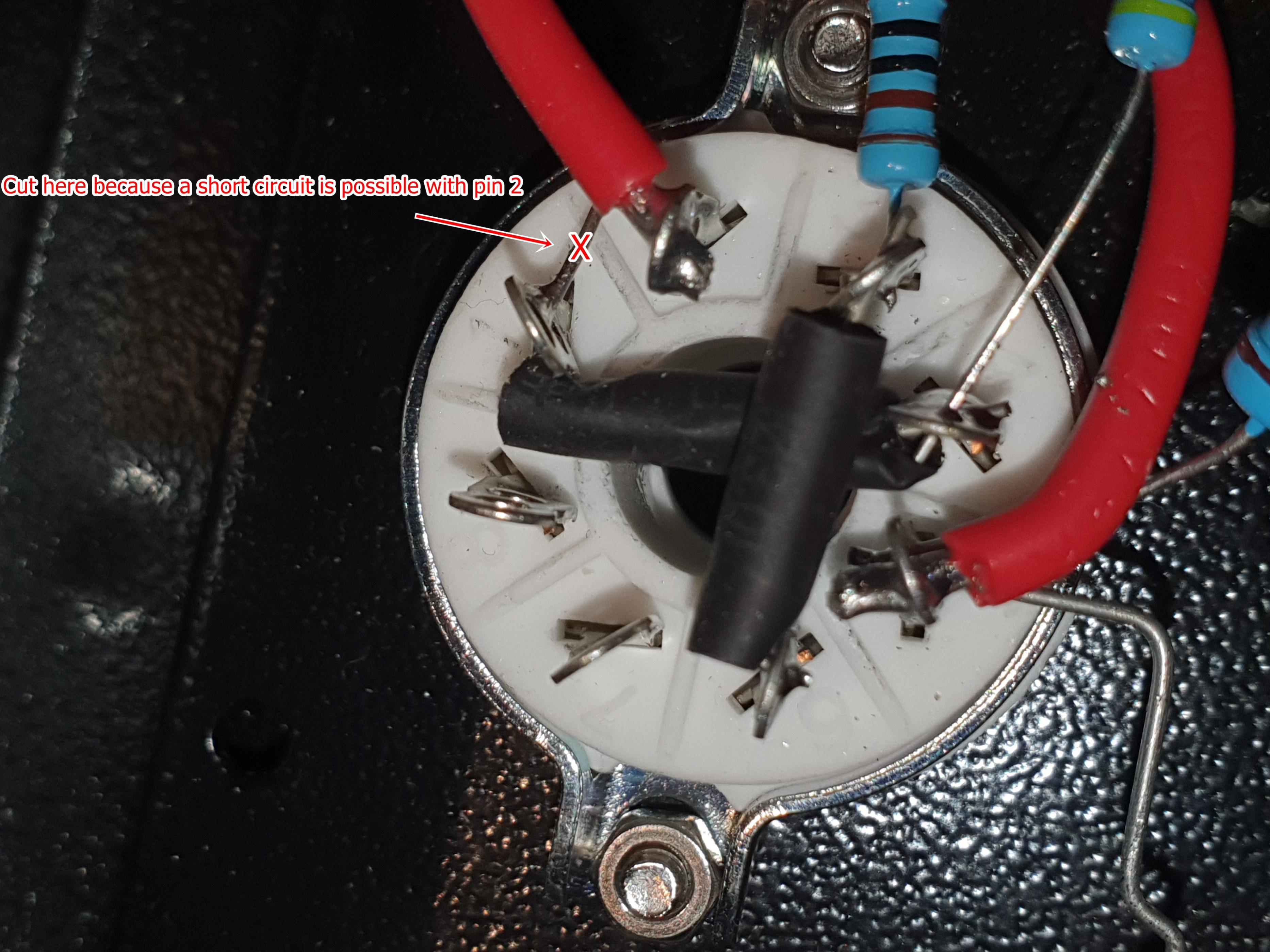

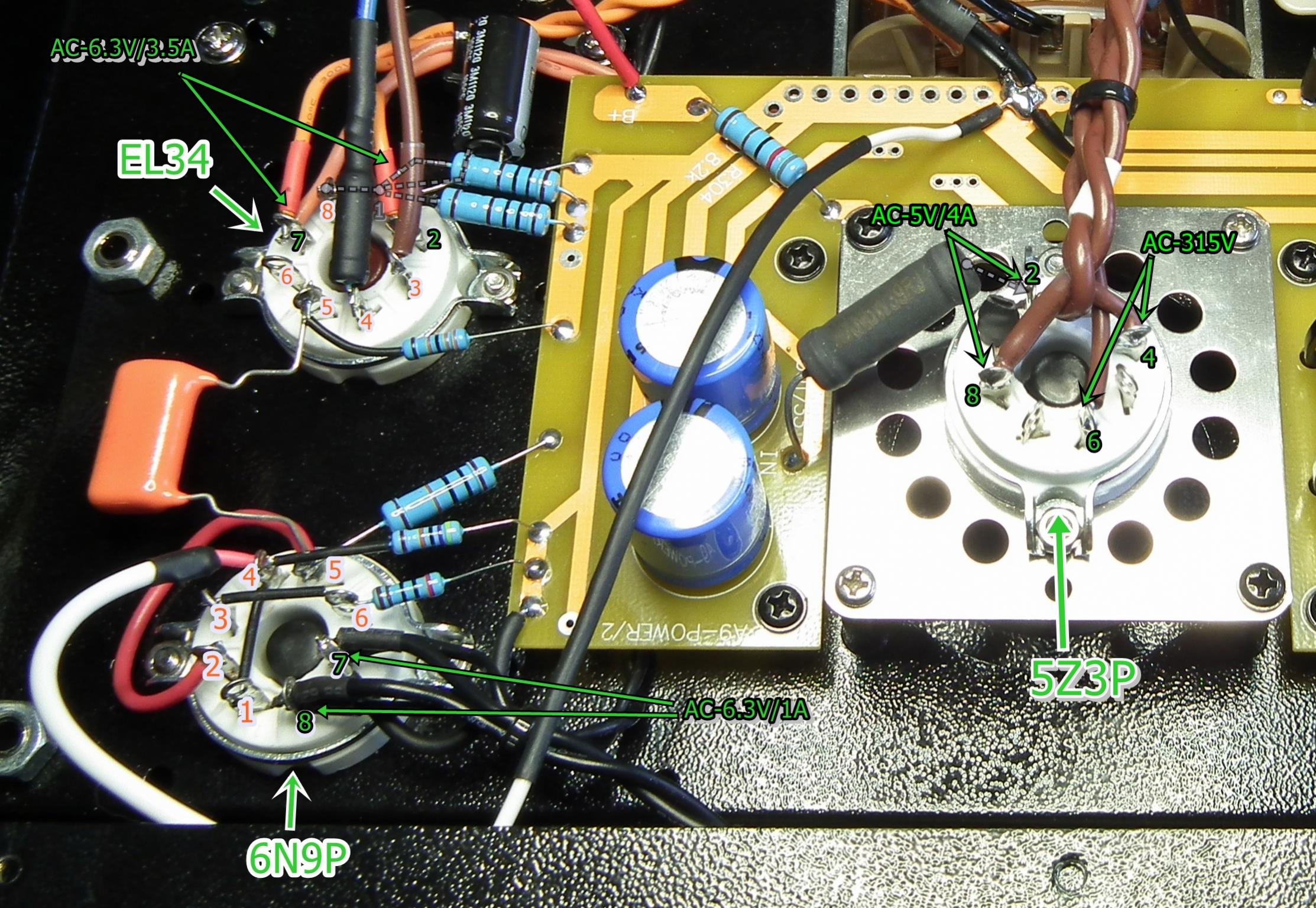

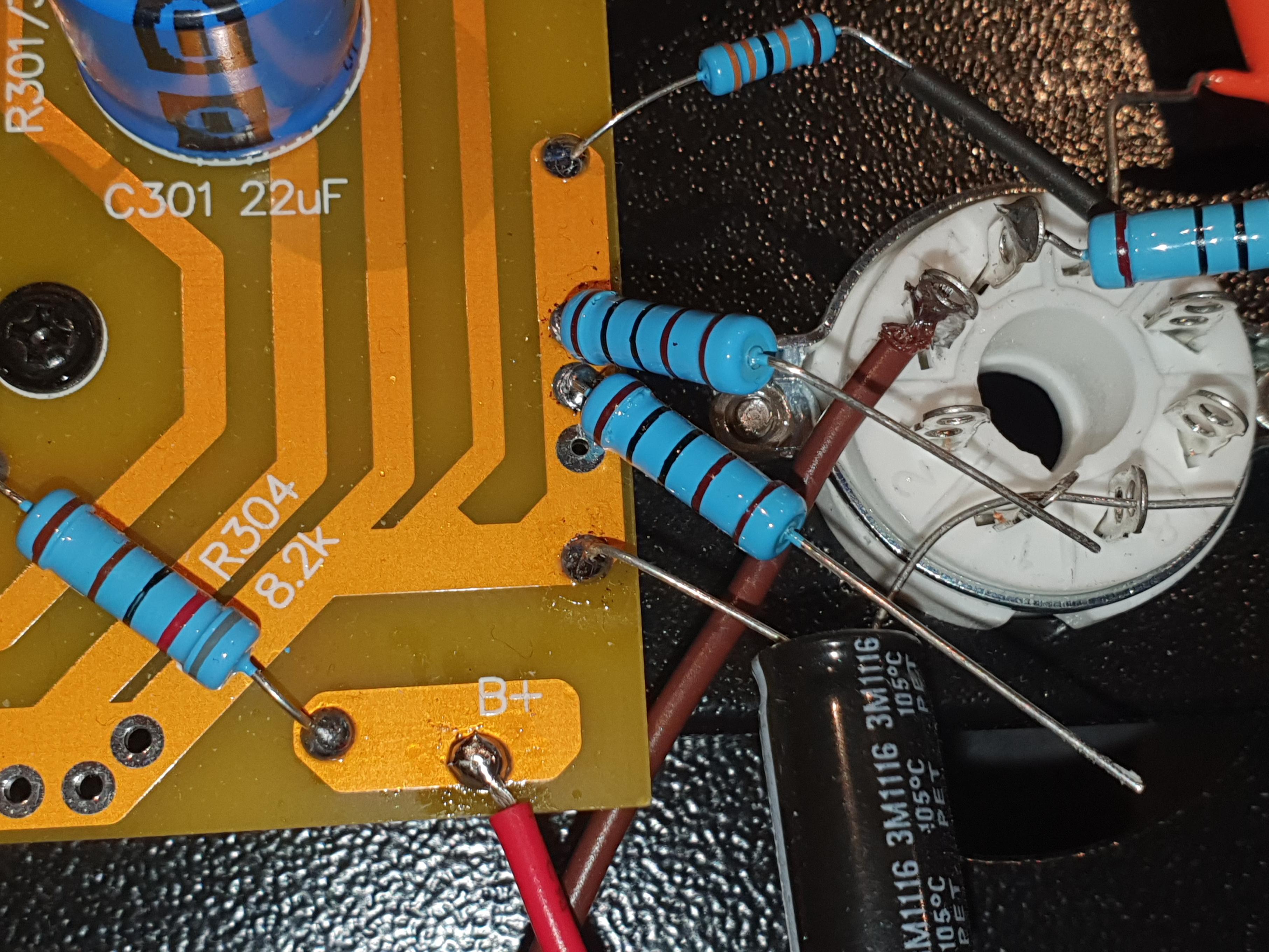

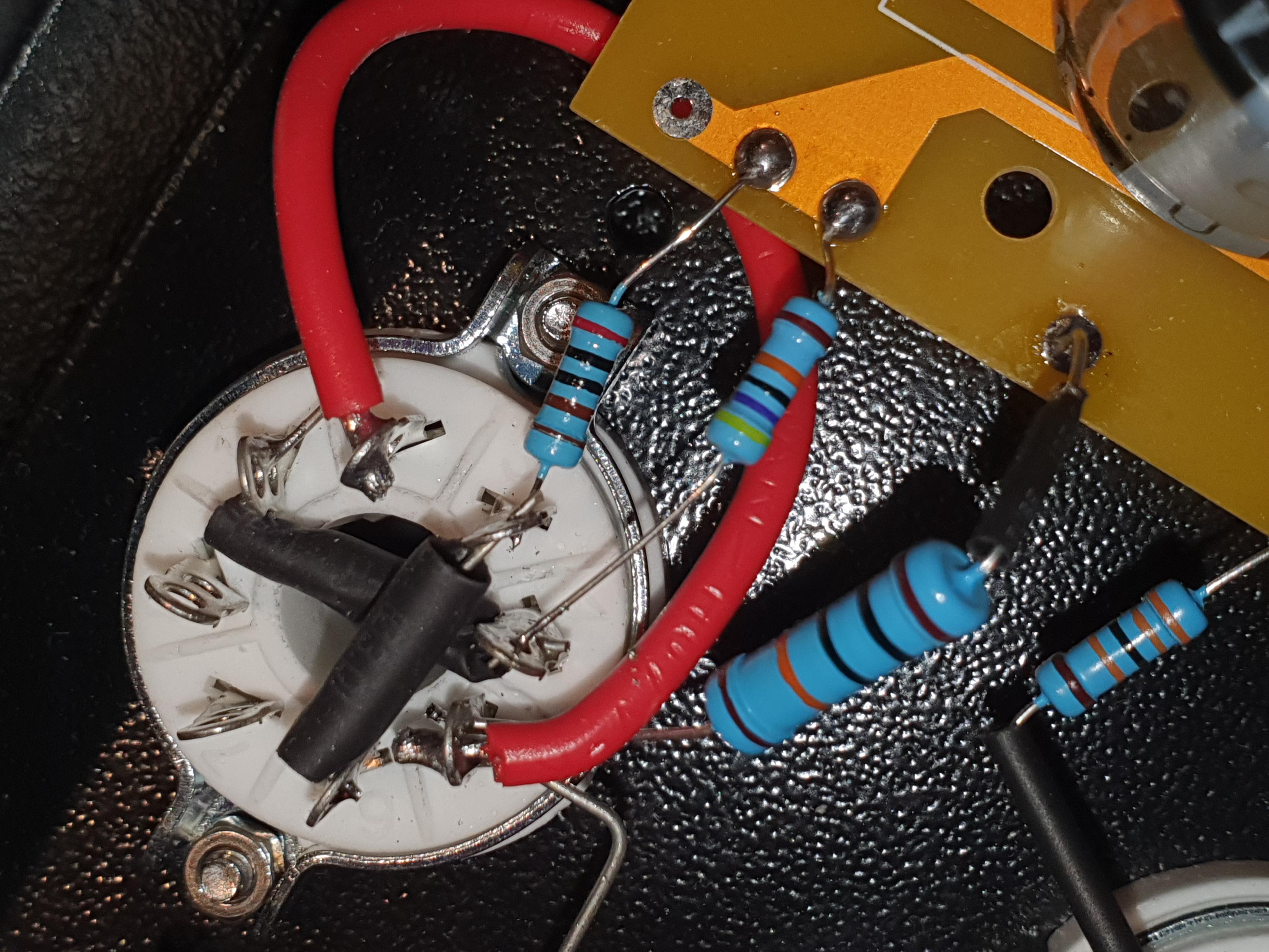

Hello 5e24ur5hio4, here is a photo (1) of the wiring of resistors and capacitor on pins 1 and 8. I also noticed that you should cut a long link between pin 1 and 2. see photo (2).😉
Heater wiring (to pins 7 and 8) should go in first.
absolutely, heating wiring to pins 7 and 8 of the (6n9p) black wires of the power transformer (6.3V-AC / 1A) and to pins 2 and 7 of the (el34) orange wires also at the output of the power transformer (6.3V -AC / 3.5A).

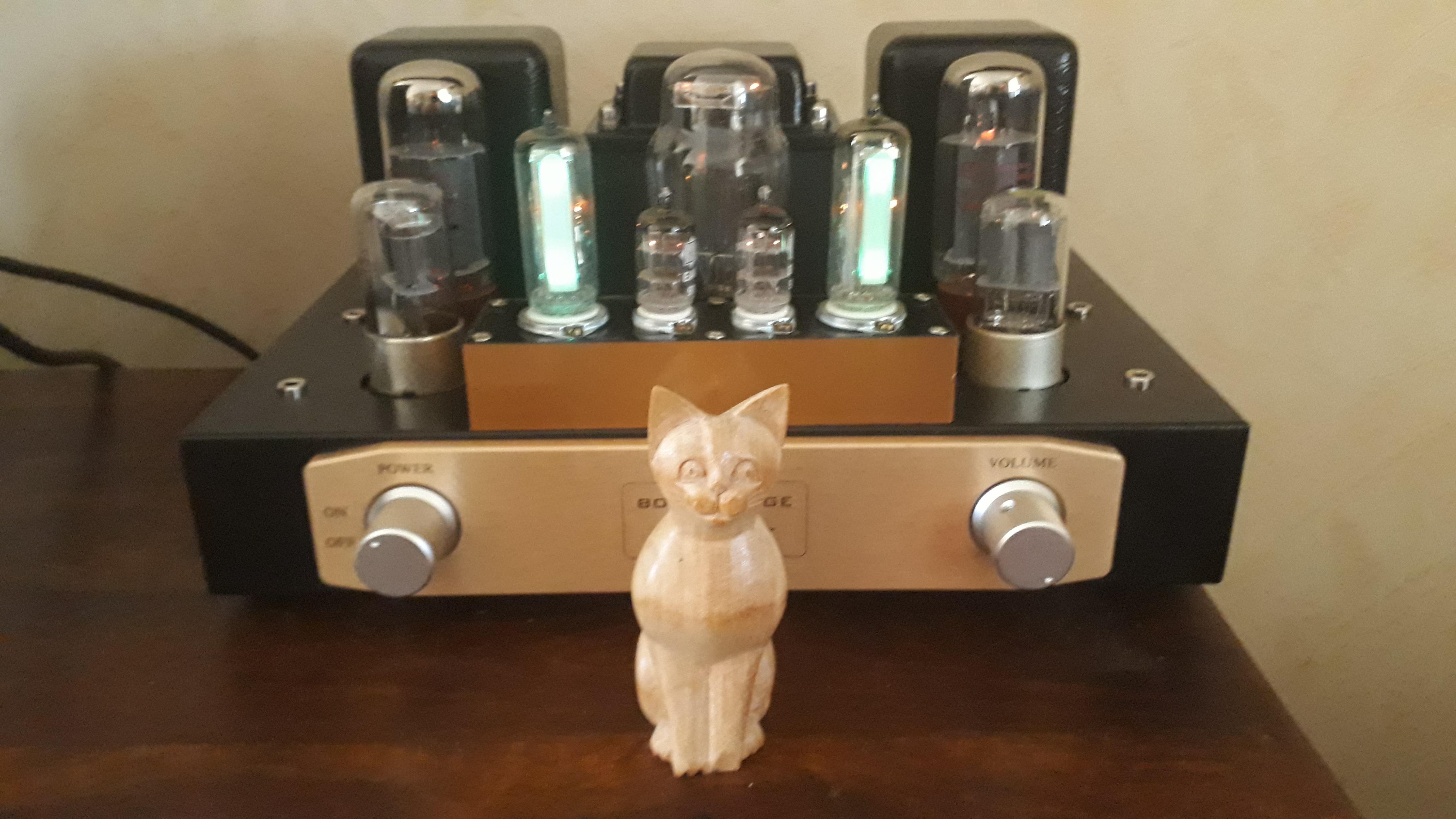

Hello,
With two resistors for symetrical grounding for each 6,3V the hum is really reduced. I measure it at -56dBu.
I also add a mod with two EM84 as a vumeter.

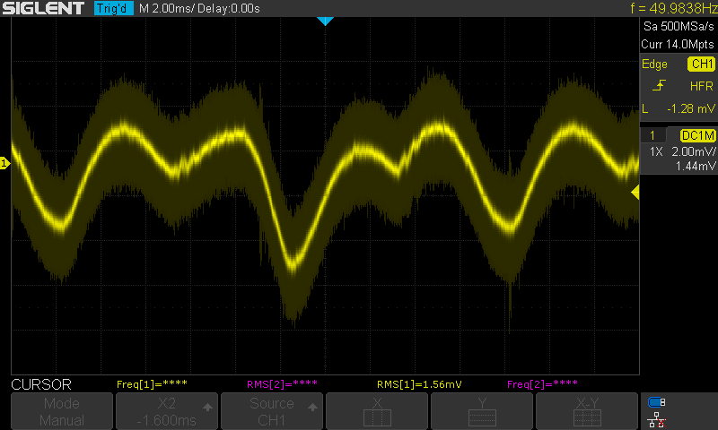

Hello,
@6A3sUMMER, I made a little mistake with the calculation. In fact the hum is measured at -53dBu below 0,7746 Vrms on a 4 ohms load. And the hum is not pure 50Hz but has good harmonics as you can see on the screenshot (don't care HF noise due to electromagnetic pollution caused by modern power suplies nearby).
@learn, I do not changed the potentiometer, the problem was not here in fact...

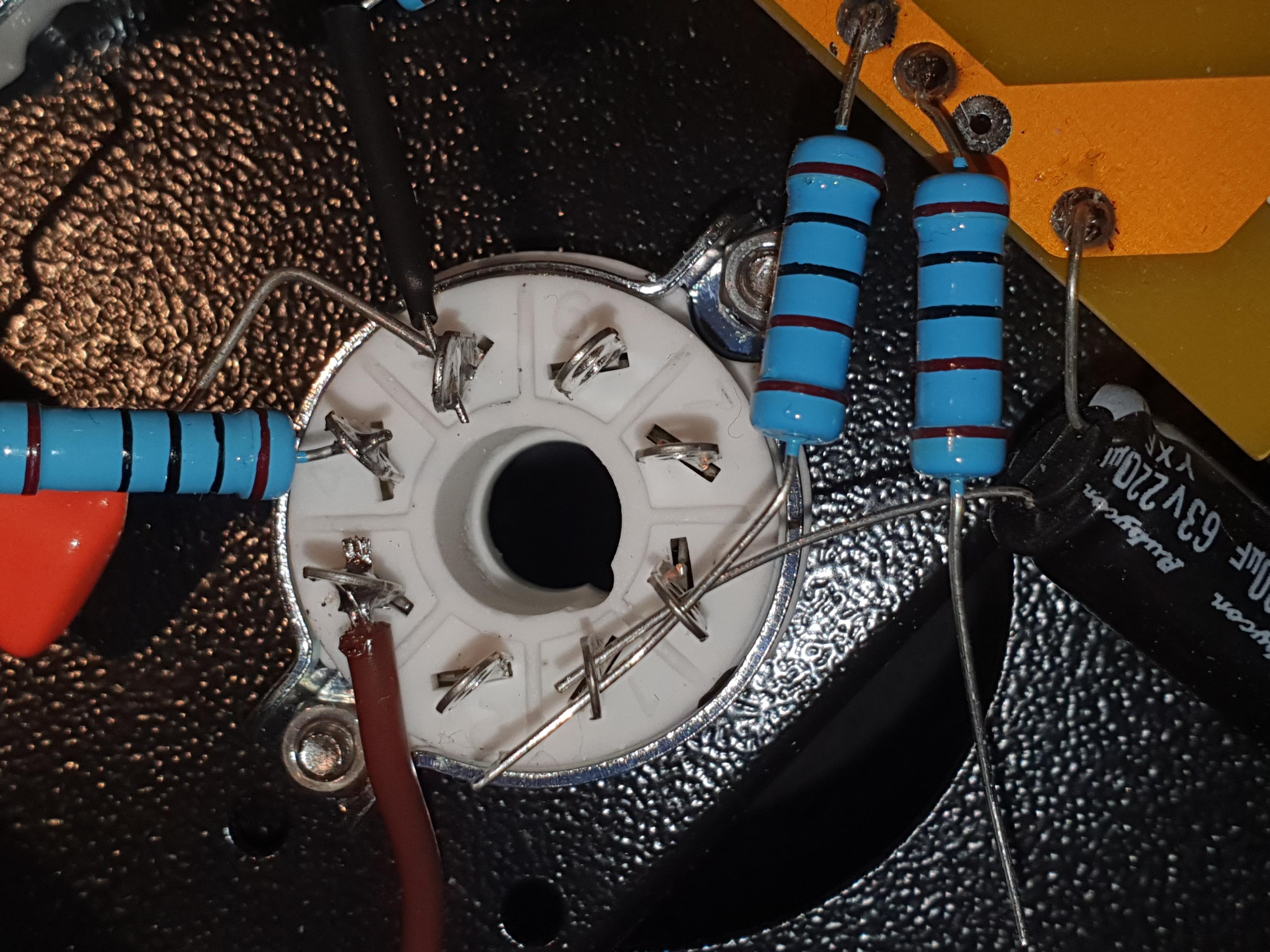

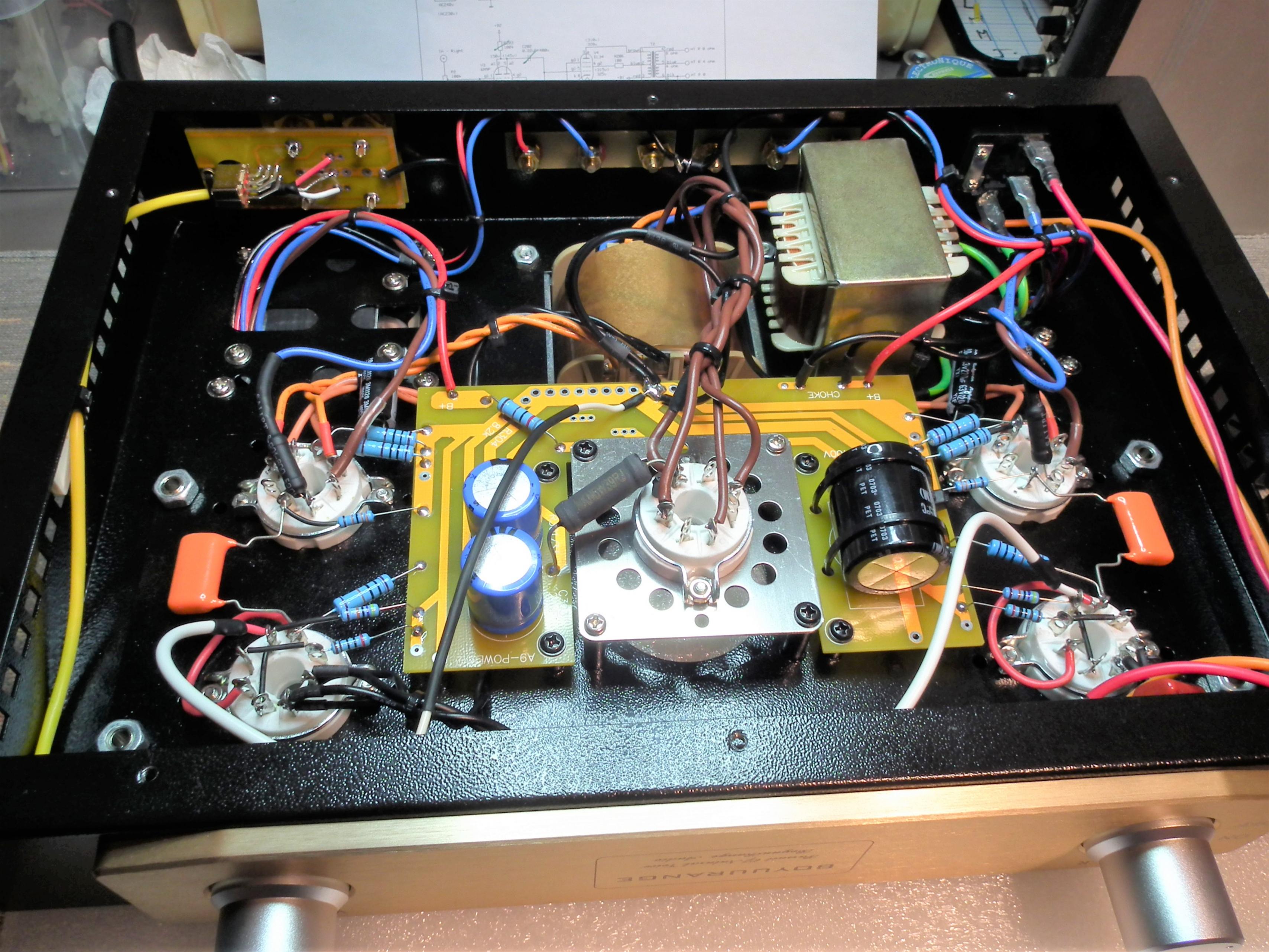

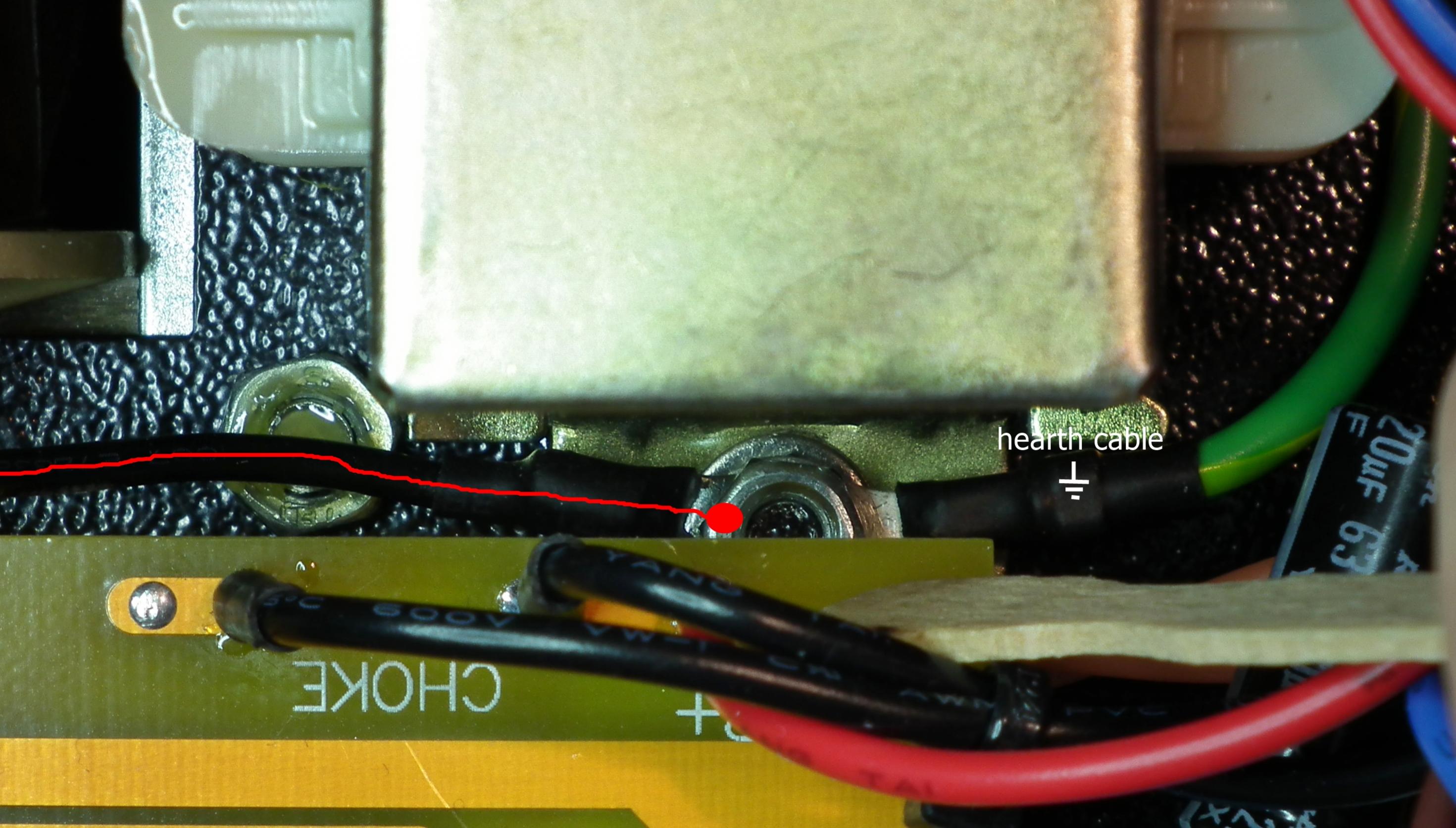

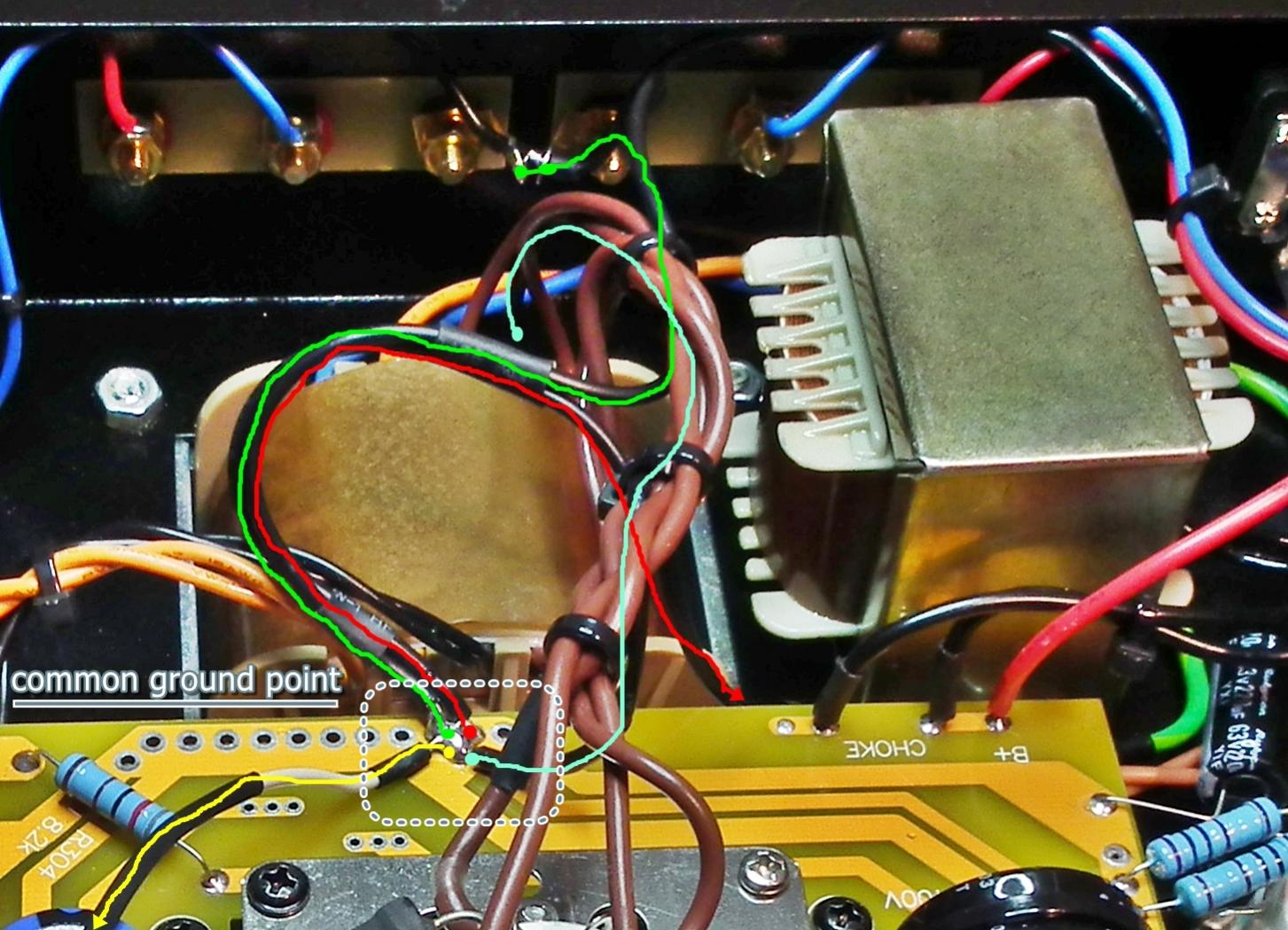

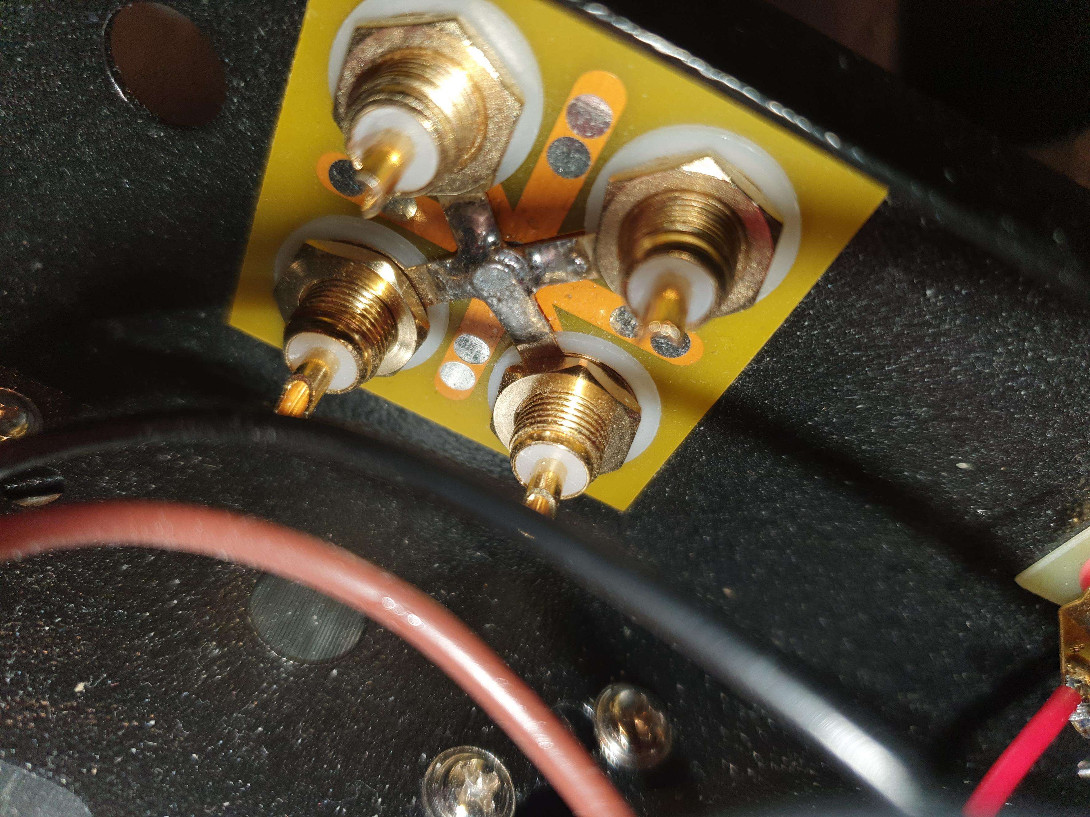

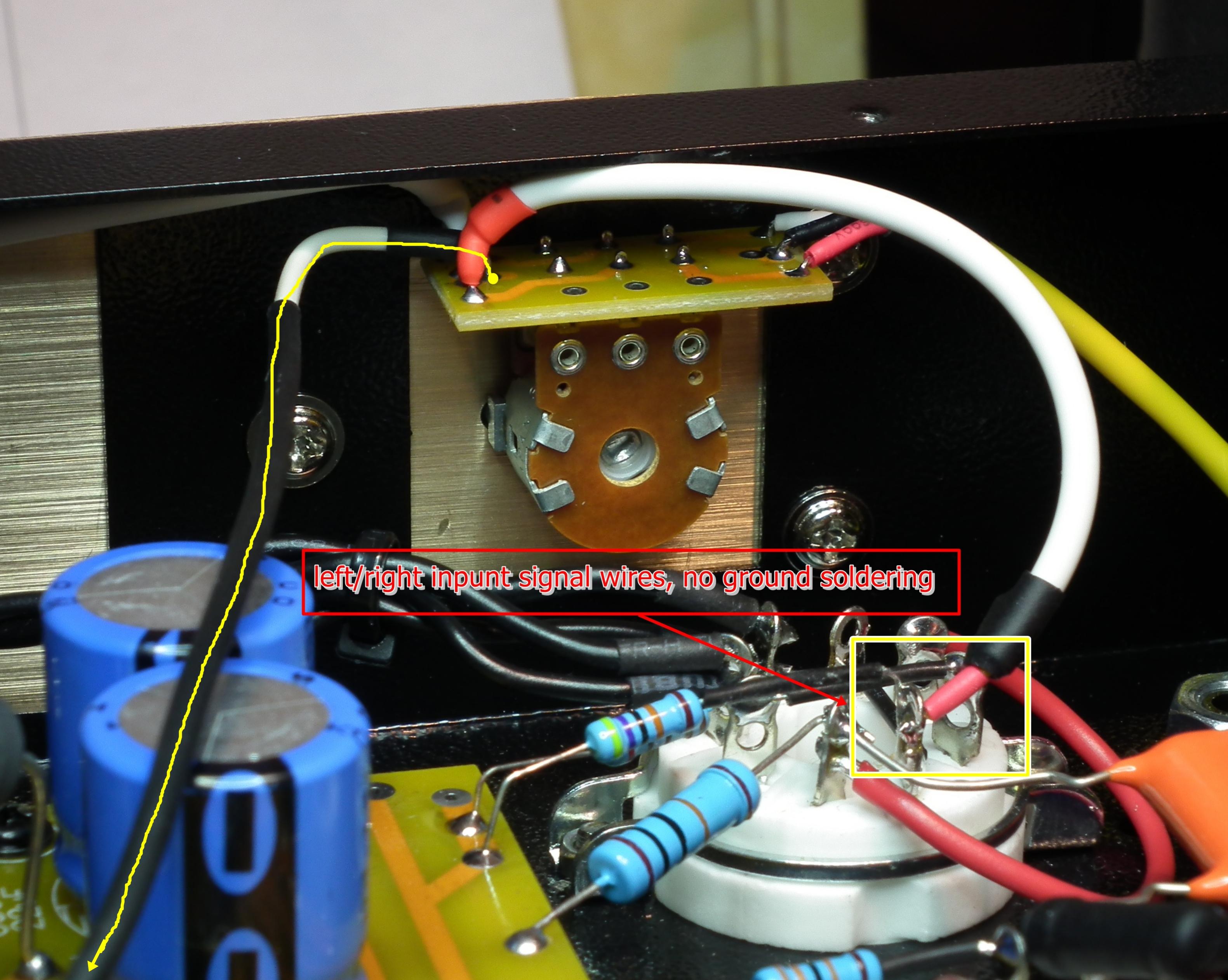

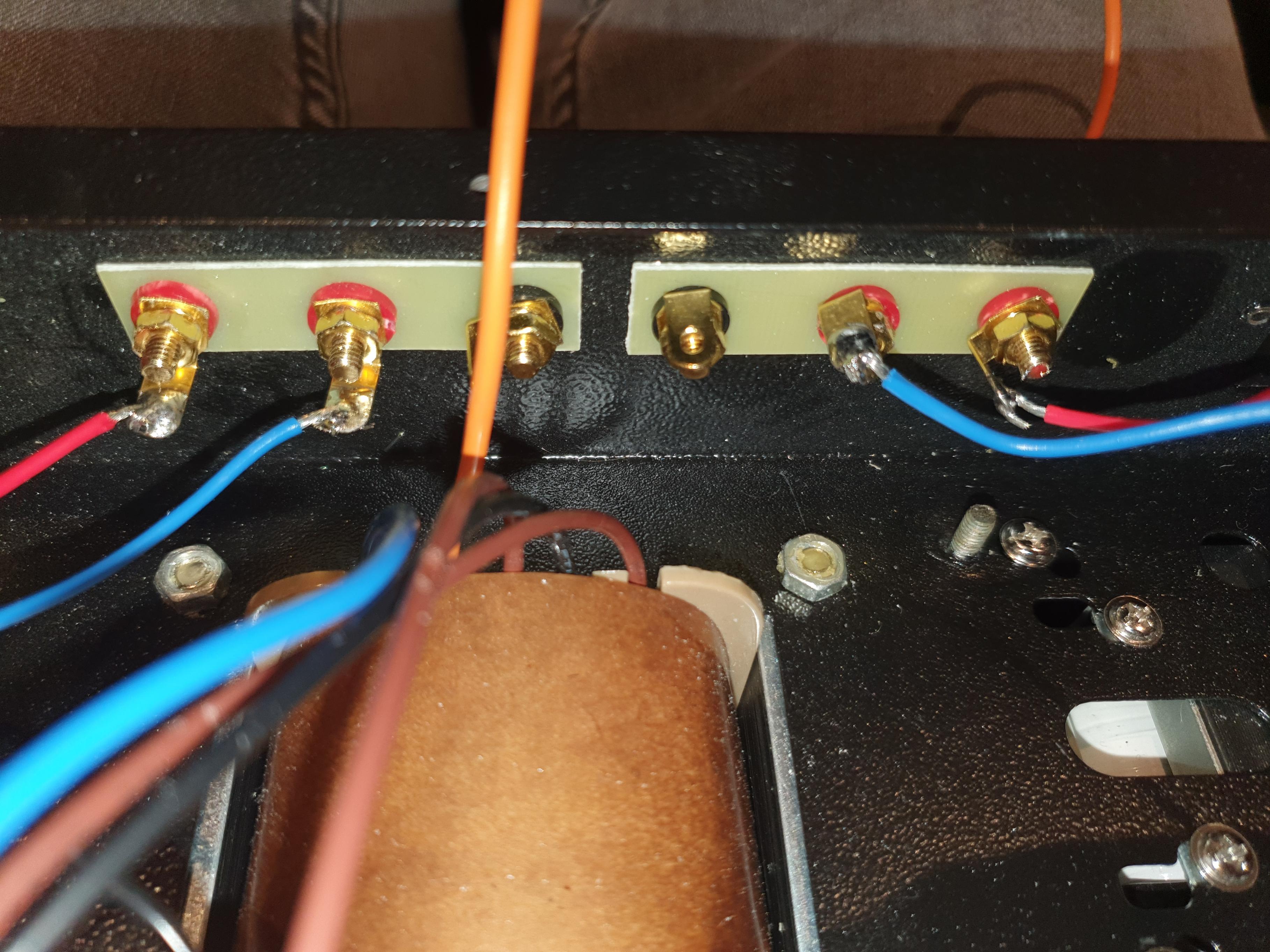

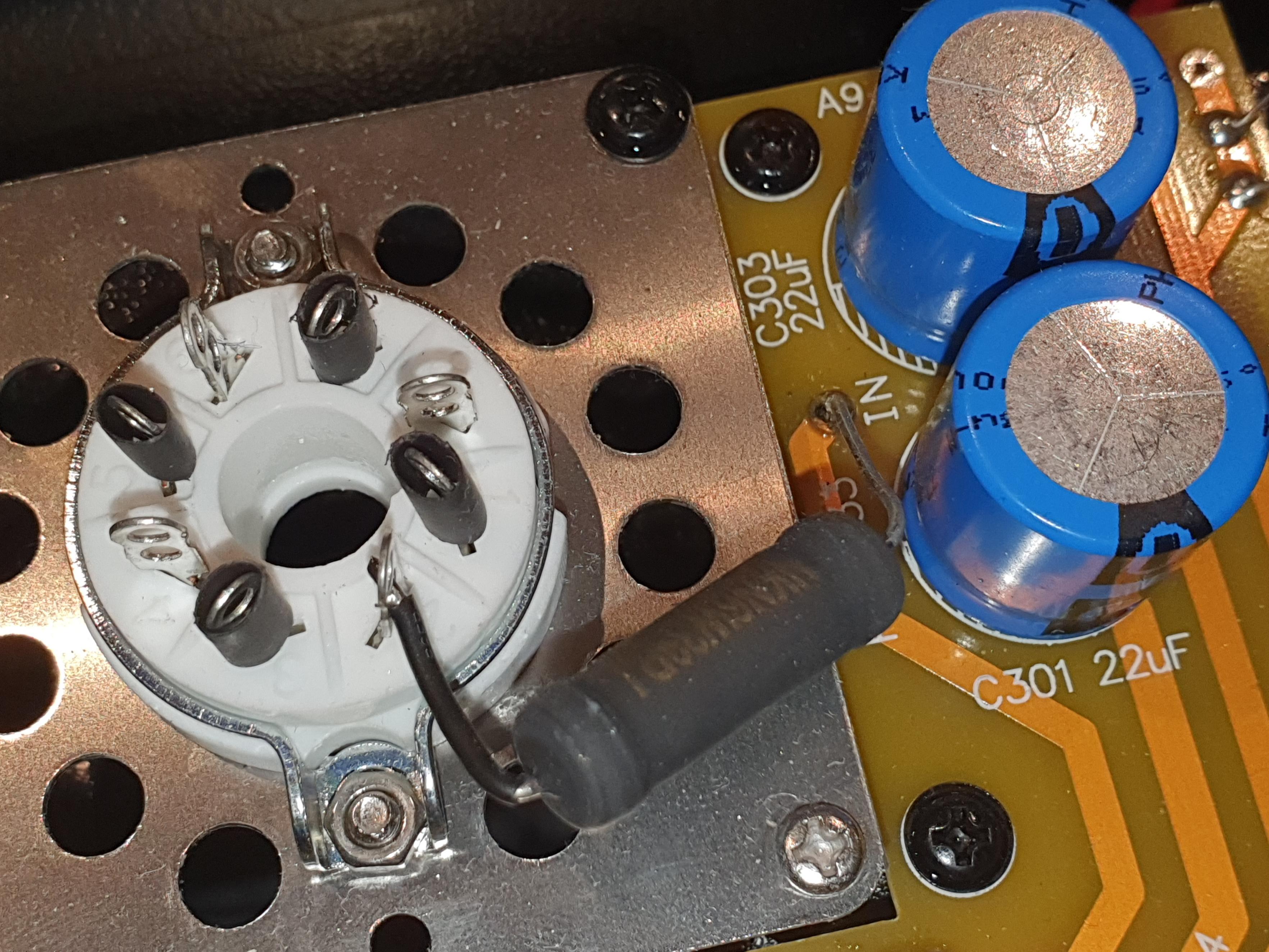

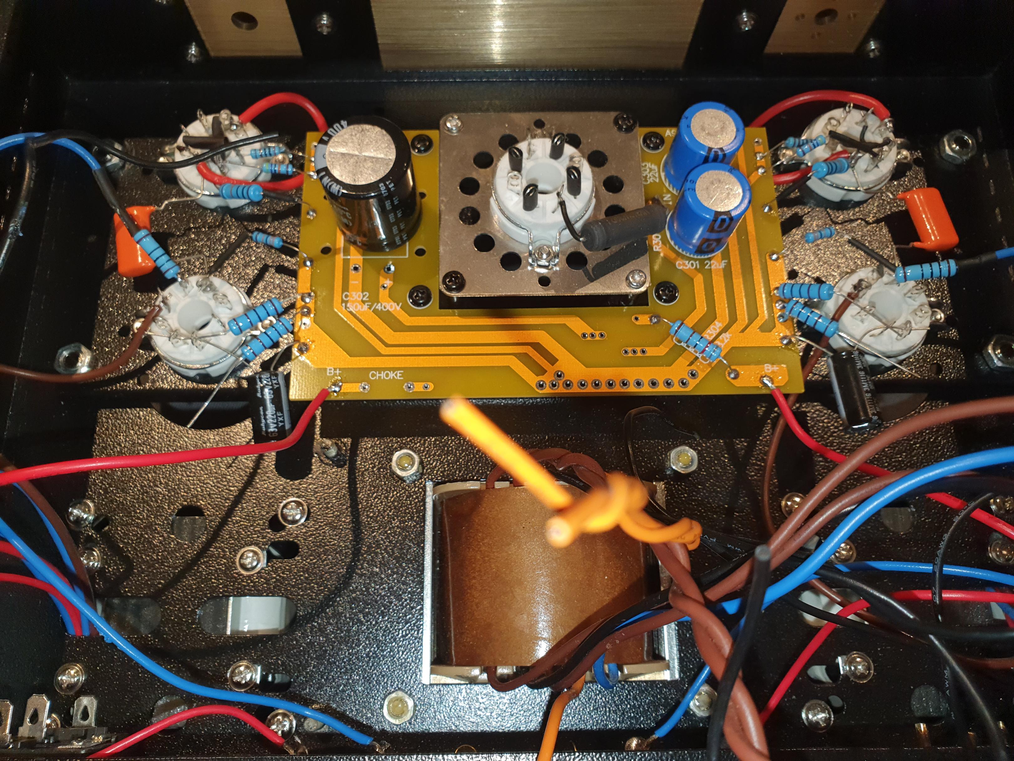

Hello, personally I wired like this:
Picture 1: marked in green=0V speakers, marked in blue=0V power transformer, marked in red=chassis ground, marked in yellow=input audio signal ground.
**All wires goes to the common ground point on PCB.**
**For connection marked red and marked yellow see pictures 2 and 3**.
**For an overview see picture 4.**
PS: Note that 2 connection points are missing which are explained by: "gregas" on page 46 (#458) of this thread.
