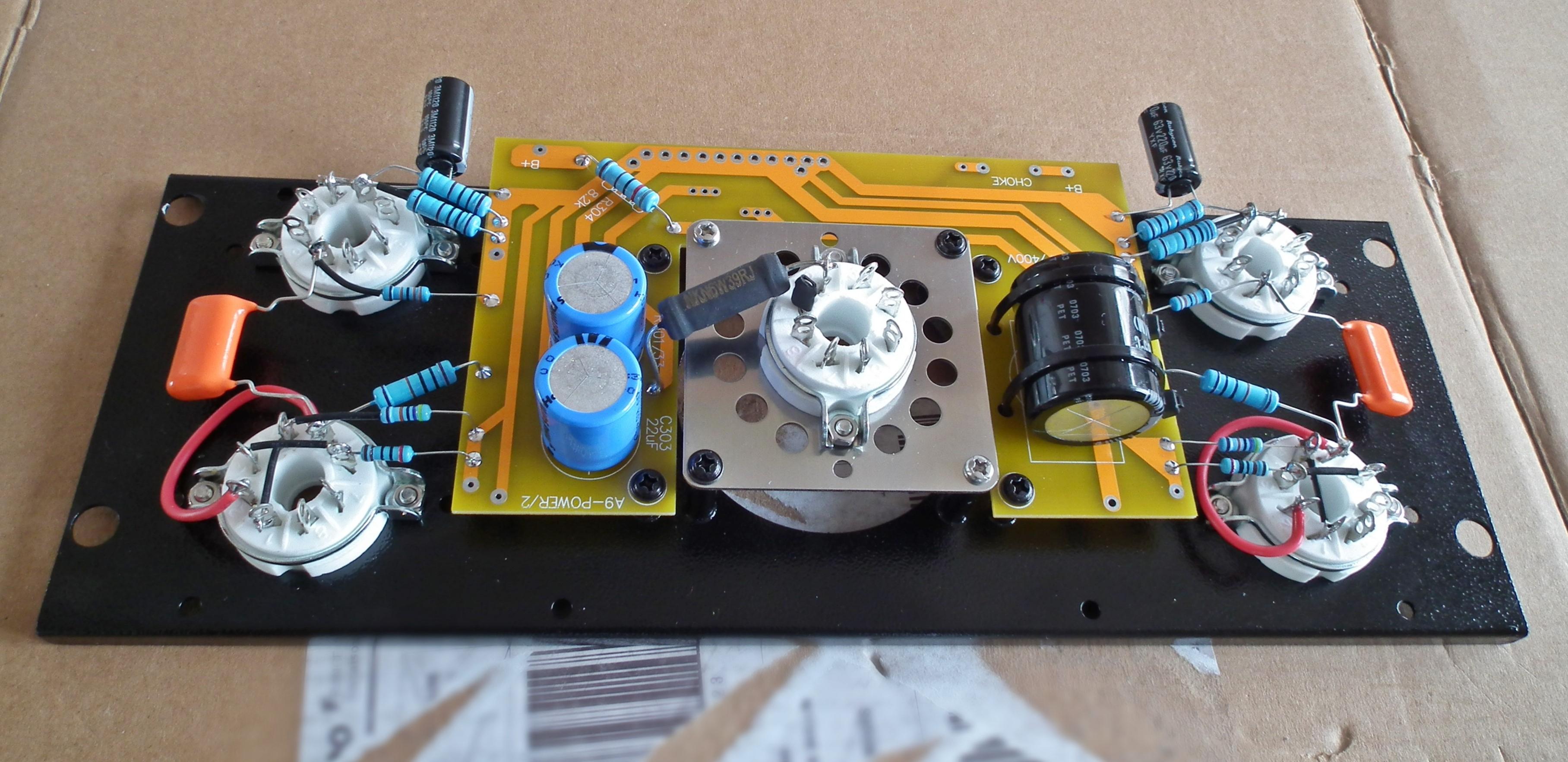

Hello everyone, I have wanted to make a tube amplifier for a long time. After browsing all the pages about: "BOYUU A9", I decided to dream from reality.
Here is what I have already assembled and soldered.
I'm sorry for my english (Google Translation).
