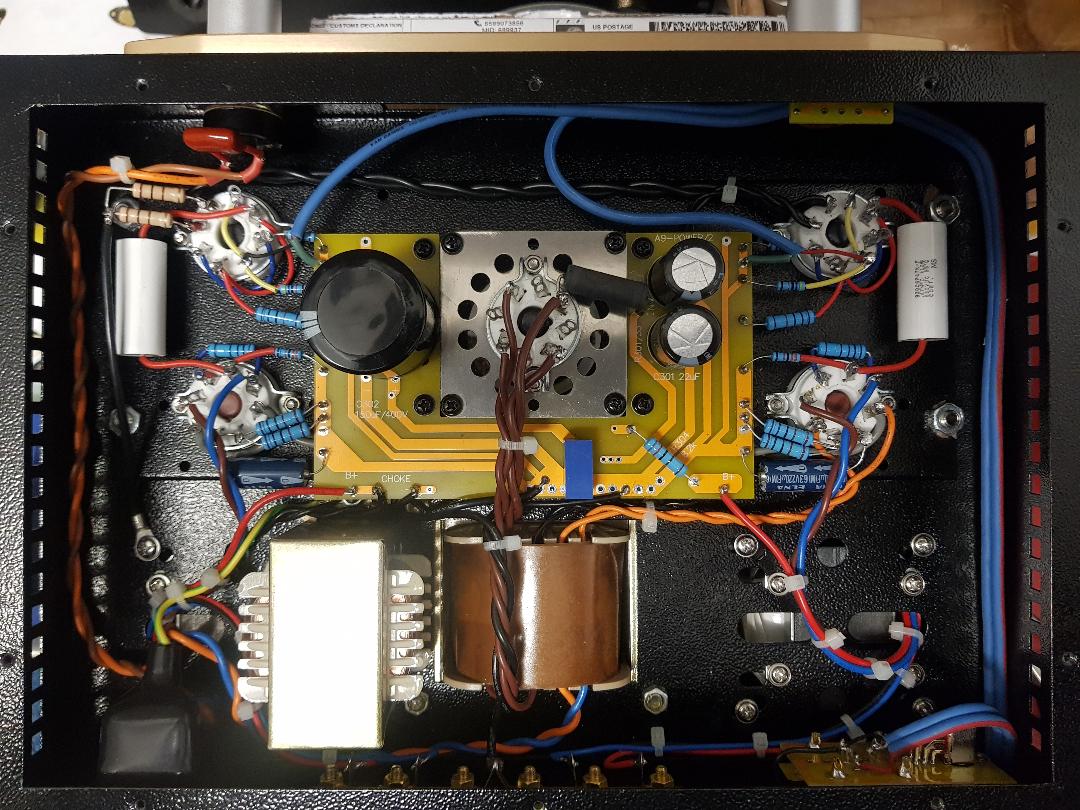

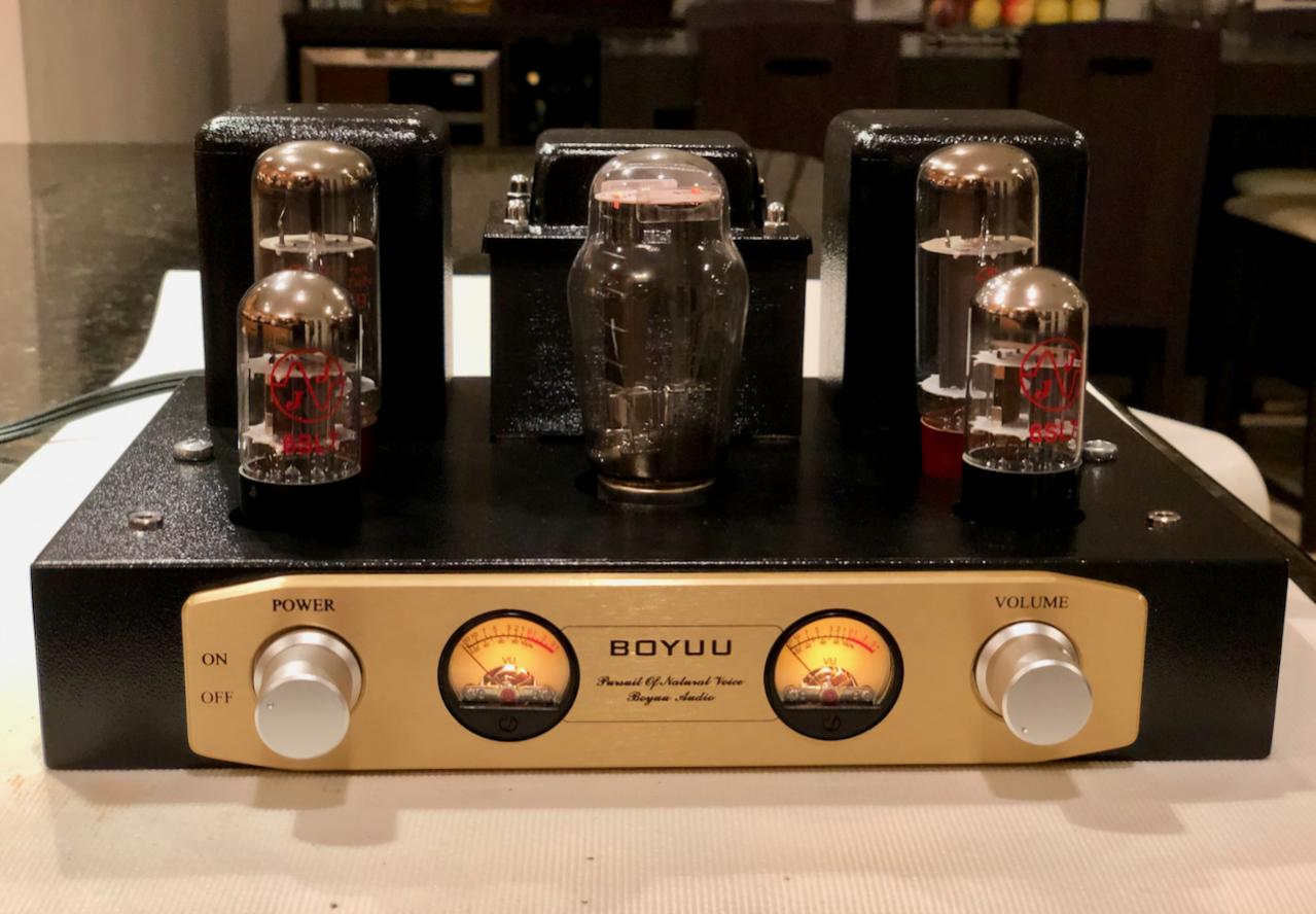

After about a month of lots of travels, I finally had time to work on my amp again this weekend. And I did a major mod that I wanted to share with you guys.
I installed vintage looking VU meters in the front of the amp, and I think it gave a good vintage look to the amp.
I got my VU meter kit for free from Nobsound because they screwed up the delivery of my A9 amp causing delays, but this kit can be bought on eBay.
2PC Panel VU Meter Amplifier DB Level LED Header Display & Driver Board Module 142372810396 | eBay
It does take a lot metal work skills to install these VU meters because you have a make a very clean hole in the aluminum front panel, and also some cuts in chassis front panel but it's worth it.
I bought and installed a 12Vac transformer to power the VU driver board because I didn't want to mess with using big resistors to reduce high voltage to 12 volt.
I can give you detailed instructions of how I installed these VU meters if you're interested.

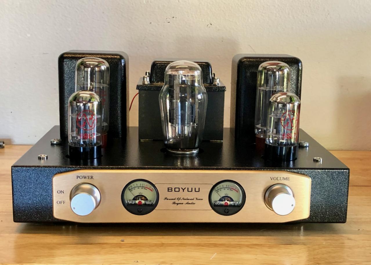

Well done!
Gorgeous looking amp.

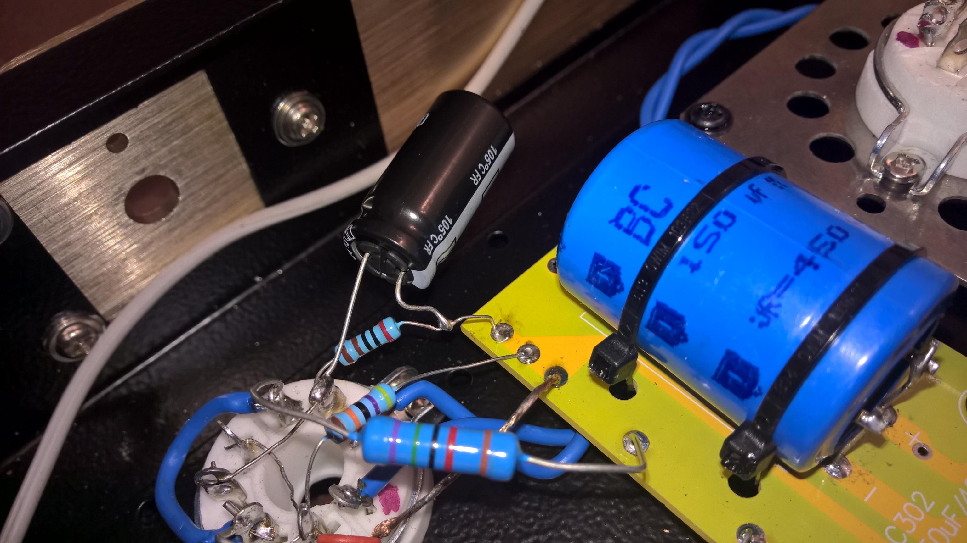

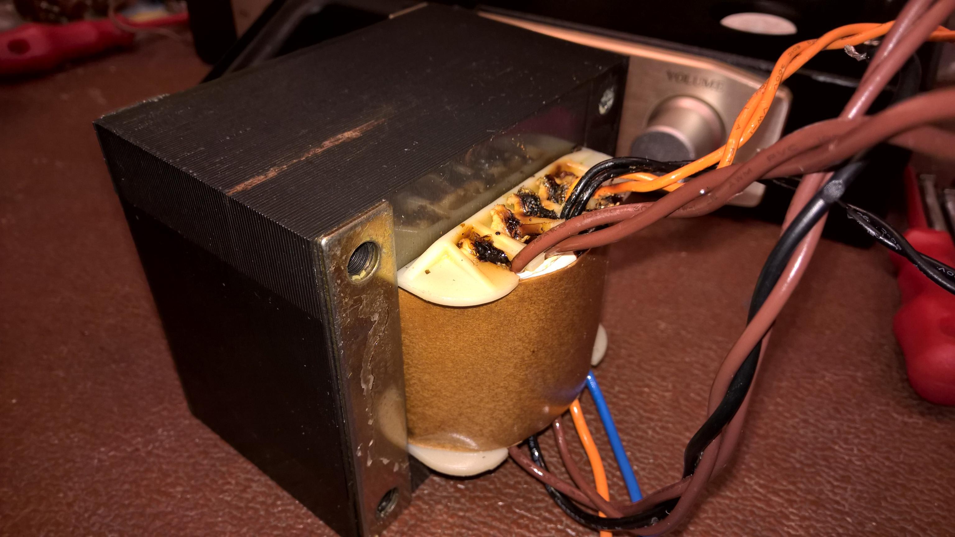

I fried my power transformer.
Hello ... I've just assembled one of these kits. It worked really well for over 20 hours, but had too much mains-frequency hum. After some simple modifications, it worked about 4 hours, but then failed, with the power transistor insulation melted and running out of the bottom.
It could be concidence, but it seems reasonable to suspect my recent meddling: what I did was
1) added resistors to ground the heater circuits, which stopped the hum. Win.
2) added cathode bias resistor bypass capacitors, which improved clarity. Win.
3) about 4 hours later: no sound; acrid burning smell and smoke wisps; all heaters not lit up any more; fuse blown; all transformer pairs short circuit.
More troubleshooting tomorrow, but I suspect one of the bypass capacitors went closed-circuit.
But I'll definitely need a new power transformer 🙁

Can you post a few more details (and good pictures)?I fried my power transformer.....................
How did you add the heater resistors, and what value were they?
Which cathode resistors did you bypass with caps?
The transformer failure could be coincidence, but likely not, as you have inferred. It could have been a defective transformer.
You could always try contacting the vendor about a (warranty) replacement, but not if you are sure that it was your mods that caused the failure.
You can find the same power transformer on aliexpress, or source a different brand.
All part of the 'fun' of DIY!🙂

No, I've said that wrong - I mean the resistance from one of the heater supply leads to ground is 50 ohm.... the resistance across the heater feeds is 50 ohms ...
The 6.3V transformer filament winding DC resistance is far less than 1 Ohm. Put a 100 Ohm resistor on one lead to ground, and another 100 Ohm resistor from the other lead to ground. That makes either lead of the winding to ground 50 Ohms, right?
And the resistors present 200 Ohms across the transformer filament winding is in parallel with the sub-ohm DC resistance of the winding.
By the way, 300mA of 12A_7 or similar tube is 21 Ohms when the filament is warm (a lot less when it is cold at start up).
Hmm. I did not know that. Thank you.
So I don't really know the condition of the transformer other than looks and smell as though it got really hot. (Pic attached.)
I've since discovered the power switch is broken (just keeps turning with no stops or on/off click.)
So I have (i) faulty power switch, (ii) blown fuse, (iii) burnt transformer. I'm trying to think of scenarios for what order that could happen - which caused which - or whether someting else 'down the line' is the cause.

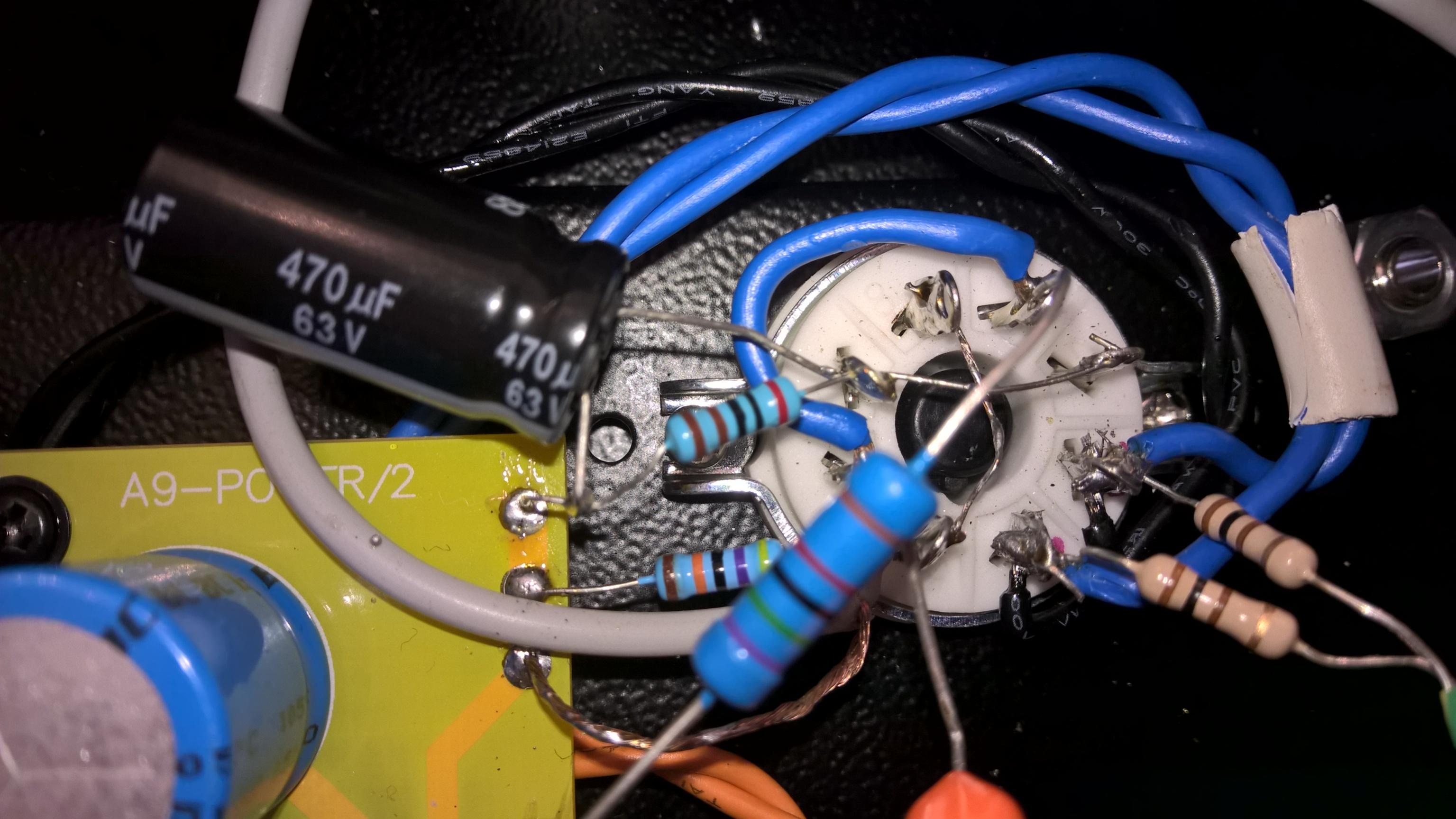

DavidN,
1. What is that 470uf 63V cap connected to?
2. You have a 400V orange coupling cap. What is the highest B+ voltage at turn on before the tubes warm up. Is it possibly more than 400V B+?
I always use a 600V coupling cap because I use solid state rectifiers, and my B+ rises to about 465V before the tubes warm up. Even with many types of tube rectifiers, the rectifier warms up before the input and output tubes, and the B+ can easily exceed 400V.
Example of what could happen to a coupling cap:
My driver plate load resistor drives the coupling cap, which drives the output tube grid resistor. The current is limited by those two resistors, but the voltage is not limited to less than the turn-on B+ of 465V.
If your coupling cap shorts, the output tubes will draw excess current, and perhaps cause the output tube bypass caps to short, and even if not, the excess current on the B+ may take out the power transformer, output transformer, etc.
Sorry the picture doesn't show clearly: they're radial capacitors bridging the cathode resistor, from ground to pins 4 and 7. (Pic 1)
2. ...400V orange coupling cap...
The coupling capacitors are the ones supplied in the kit. I can't test any voltages before I replace the power transformer.
The chassis currently has no PT, and I've removed the valves. Testing continuity/resistance indicates neither coupling caps nor bypass caps are shorting.
Thanks for you insight. I'll revisit the voltages when I have a PT that doesn't pop the fuse. (By 'pop', I mean 'vaporise the wire so fast that the glass sleeve shatters'.)
