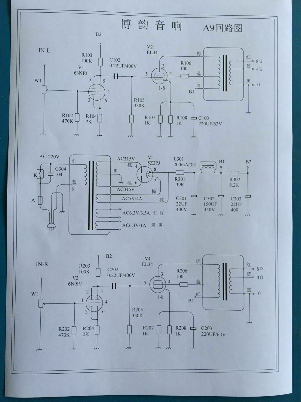

Hi!
Please see the schematic below...is this the one you are using?
I'm not sure exactly what you did (or why) but...
Putting a 100R or 200R resistor from the B+ high voltage rail to ground (bypassing C302) is definitely NOT a good idea. Some Ohms law and power calculations will show that..
So definitely remove that 'mod' as a first step.
Then, double-check your wiring against the schematic.
Next step for me would be to remove all the tubes (and the speaker), power up the amplifier and check for the right heater/filament voltages at the correct pins on the tube sockets. Use the AC volts setting on your meter.
You do know that the tube pins are numbered clockwise, looking at the bottom of the tube? -i.e. from the inside of the chassis- this is a quite common beginner mistake.
Report back with the heater voltages and pin#s, and post some pictures of your wiring, and somebody here will help.

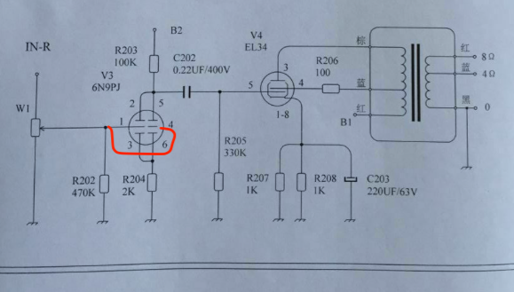

After assembly at first power on I have a huge HMMMMMM in both speakers.
Hi Marius,
Welcome to the group. This group has helped me a lot and I have learned a lot from them too.
I had the same huge hum on both speakers when I first powered on my A9 amp and the problem was that pin 4 of the pre-amp tube needs to connected to pin 1. this connection is not shown in the diagram that comes with the kit. The loud hum should go away once you connect pin 4 with pin 1.
Let me know if this fixes the problem.
Frank

I've seen this same diagram missing the pin 1-4 connection as far back as 2015 and it's unbelievable that still today the Chinese have not yet corrected the diagram. 😡
Frank
Frank
Frank:
Good work in zeroing in on the problem Marius was having! (Experience counts!)
I agree on the schematic needing improvement. The connected grids are 'obvious' to most experienced builders (plates in parallel, cathodes in parallel, etc..) BUT many buyers of the Boyuu and similar kits are not experienced, so no details should be omitted from the schematic.
