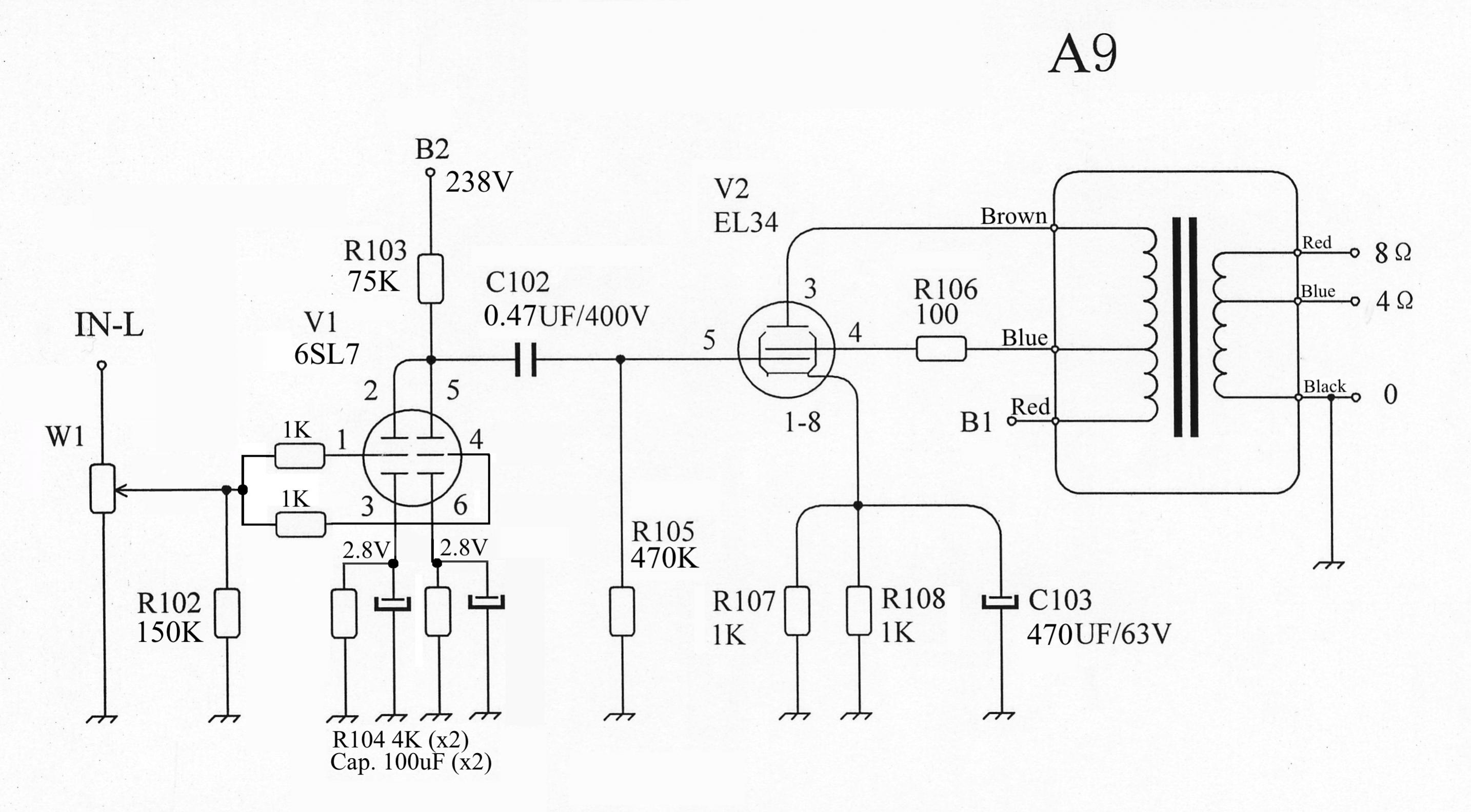

I would like to pick your brain one more time. This is specific to my amp but I think it would be a good knowledge to all in this forum.
Please take a look again at the diagram of my A9 amp (attached).

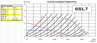

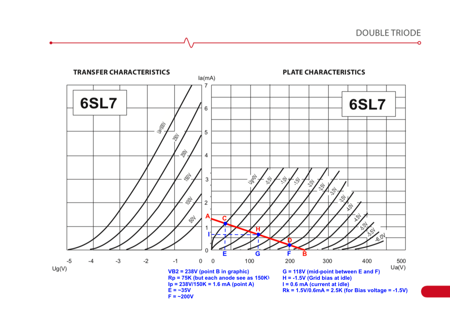

I've been reading about how to correctly calculate bias in a triode tube and I learn the following:
Choose a voltage to power the tube (in my case is 238V) Choose a resistor to tube anode (in my case R103 is 75K. but each plate sees as a 150K resistor) Calculate the currents assuming tube is in short (max) and tube is in open (min): ip= 238V/150K -> Ip= 1.6mA for max and Ip = 0 for min. Plot these values on the tube Plate Characteristics graphic. Mine is for 6SL7 (see picture) Then on graphic you pick the point where the Ip line crosses grid voltage Ug @ 0 volts and @ Ug is still linear. (in my case I picked Ug -3V) Then you read the Ua voltages and pick the voltage in the middle. Let's call this "Ua idle". (In my case Ua1= 35V, Ua2 = 200V and mid point is 118V) From there you see where the Ua idle line crosses the Ip current line and that will be your Ug for idle. in my case was -1.5V Then you read in graphic the Ip current for idle. (in my case was approximately 0.6mA. With the this Ug and Ip you calculate the value of the cathode resistor for Vk. in my case Rk=Ug/Ip -> Rk= 1.5V/0.6mA, Rk= 2.5K)
So if all the above is correct, my 6SL7 tube should have 2.5K cathode resistors which would put the cathode voltages at about 1.5V. But in my amp I currently have Rk 4K and the cathode voltage is 2.8V, which makes Ug -2.8V. And if you look where Ug -2.8V is in the curve, it is really in a bad point of the curve.
I would like your comments in: 1) If the above method to calculate bias is correct. 2) If I should change my cathode resistors to have Ug at -1.5V.

Fdlima,
Before I try and answer about what the driver should be like . . .
Can you tell me what is the DC voltage on the EL34 Cathodes, Left and Right channels?

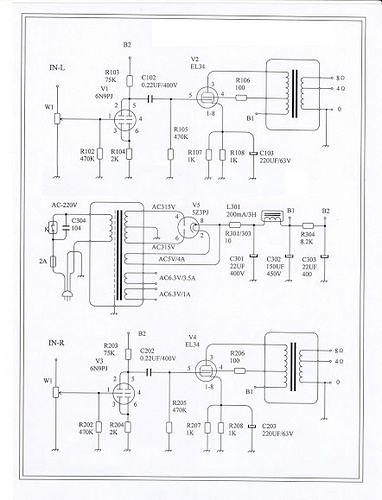

Also, this thread has many schematics, started out as SRPP 6N9P, went to common cathode parallel triode 6N9PJ, and perhaps others, and now is 6SL7.
These tubes may be somewhat equivalent, or may not be for all circuits.

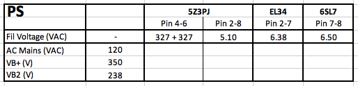

Hi 6A3,

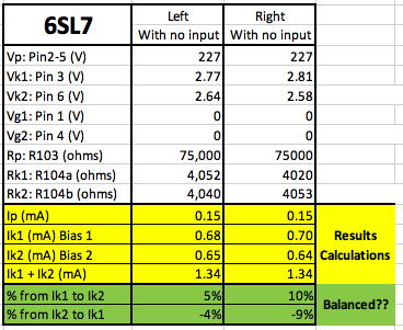

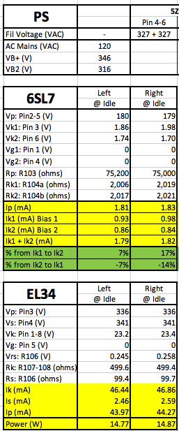

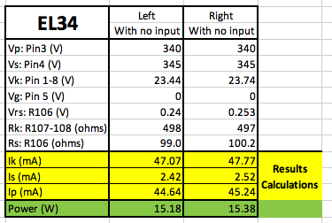

Here are all measurements from my amp. The cells in yellow and green are calculated results.
BTW, I don't think I can upload Excel files to this forum. correct?

Fdlima,
The EL34 Cathode voltage is (almost) 25V.
The EL34 grid is at 0 Volts.
The EL34 grid to cathode is -25V (the grid is more negative than the cathode by 25V).
The 6SL7 plates are at +227V.
The 6SL7 plates have to be capable of swinging +25V to - 25V above and below +227V (+252V to + 202V), in order to fully drive the EL34 grid.
(the coupling cap makes the EL34 grid voltage go from +25V to -25V).
-25V grid to cathode + 25V from the driver plate coupling cap = 0V grid to cathode.
-25V grid to cathode - 25V from the driver plate coupling cap = -50V grid to cathode.
You start with what the EL34 tube needs at the grid (in this case +/-25V),
Then you design a driver that has enough gain (according to your signal source voltage swing), and that can swing the +/-25V. That will drive the EL34 to clipping. Just a little lower signal from the volume control is the loudest you will listen to.
Fdlima,
My post # 888 is quite distorted from the 35/30 = 17%. That was a very first cut. But a different resistor, etc. might give a better result.
The one with 75k is 83/82 = only 1.2%, but watch for two things:
1. With no distortion in the driver, the 2nd harmonic distortion in the EL34 does not get cancelled (you might like it that way).
2. With the operation so far down on the 6SL7 curves, you will likely get a very wide
range of distortion from one tube to another (or even from one triode to the other triode in the same tube).

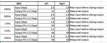

Hi 6A3,

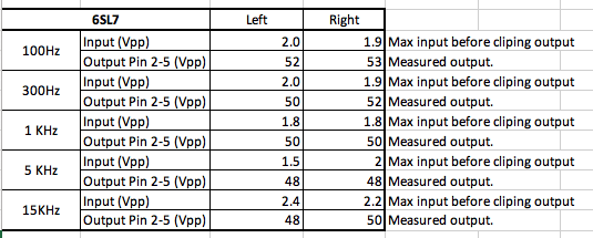

I have also done some measurements on the output (plate) of the 6SL7 tube (using the oscilloscope) and the results are in the table in this picture.
The way I did was I had one channels of the oscilloscope connected to the output of the 6SL7 tube (pins 2-5) and the other channels connected to input of the amp (on center tap of the potentiometer)
Then I started increasing the input signal until start seeing some distortion in the output signal.
Then I lowered the input signal slighty to the point just before seeing distortion in the output signal.
I then measured the input signal and the output signal and those are the maximum values before clipping.
As you can see in the table, for some frequencies, I'm not getting the 50Vpp (+/- 25V) swing, before clipping, that I need to drive the EL34. So I guess I should change the resistor value to get a better results?

Your peak to peak measurement does not tell us anything about the symmetry or the non-symmetry of the output signal. non-symmetry is primarily 2nd Harmonic distortion.
A re-design would require changing the plate load resistor, self bias resistor, quiescent current, and quiescent plate voltage.
By the curves and values you showed on your tube curves, post # 885, you will likely not get lower distortion, but you do need to test and verify that it is actually the 1.2% that the curves showed.
You will need to separately measure the Peak +, Min -, and compare them (un-equal is 2nd harmonic distortion).
Since the plate is at a + voltage, you should measure by using AC coupling in the scope. If you do not have AC coupling that can handle +290V, then measure the EL34 Grid peak and min. Reference to 0V, the Peak +, and Min - are the real excursions.
Remember, when the grid goes more positive than the cathode, it will draw grid current, drive the average cathode voltage up, and the grid current will also distort the driver signal.
Clipping at both the peak + and min - is 3rd harmonic distortion.
If you have an FFT in your scope, you can measure the 2nd and 3rd harmonics.

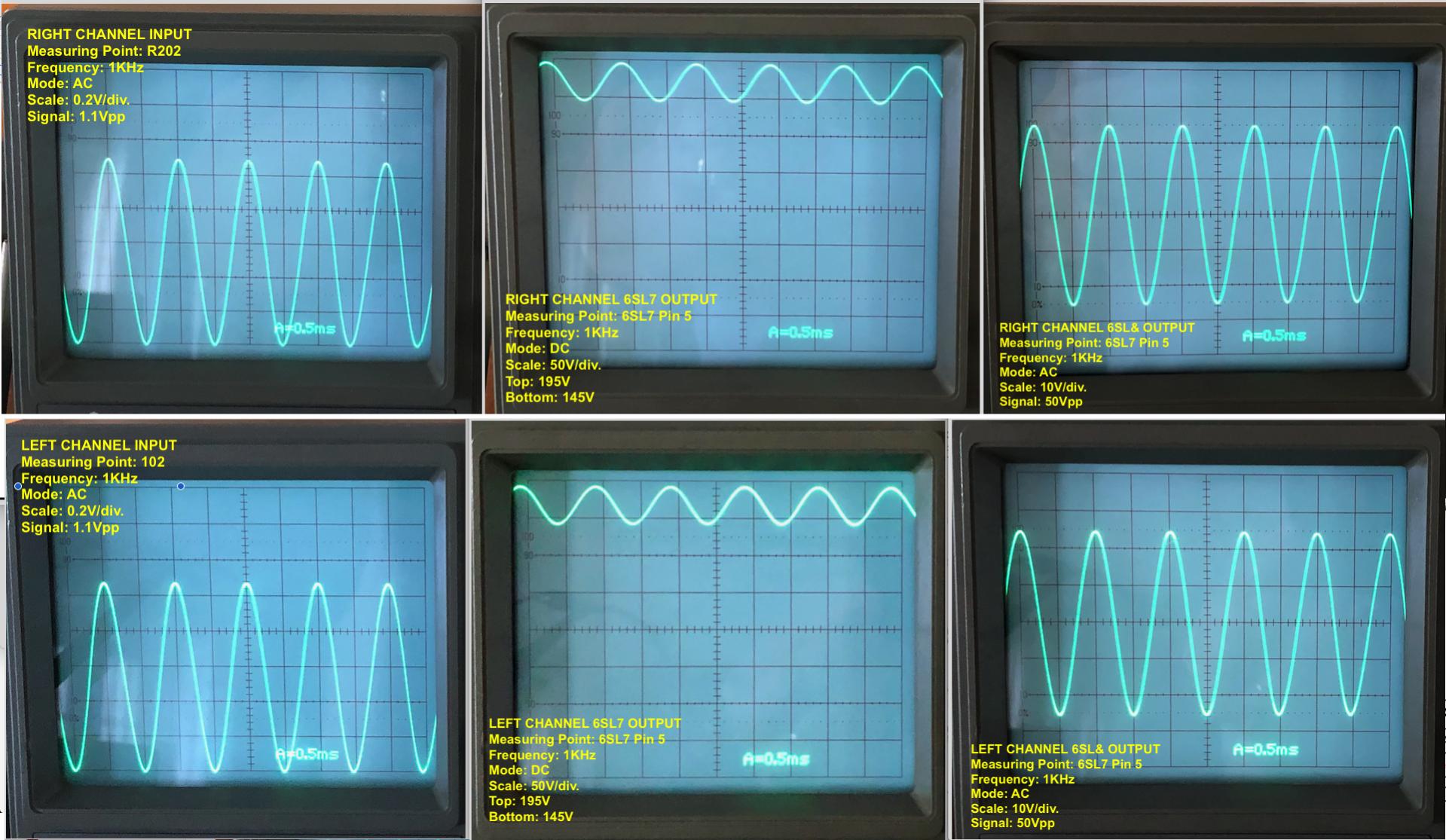

I modified my amp this weekend and I replaced the 4K cathode resistors (6SL7) with 2K resistors and now I have a nice swing on the output of 6SL7 of 145V to 195V (50Vpp). The voltages seen better too.
The input can go up to 1.1Vpp before the output of 6SL7 starts loosing symmetry or having signs of the 2nd Harmonic. the output is about 50Vpp.
But although the 6SL7 can output up to 50Vpp, the input of the EL34 can only take up to 35Vpp before the output starts having distortions. For 35Vpp at the input of EL34, the output is about 165Vpp. Sorry I did not take pictures of the signal at output of EL34.
As always, your comments are very welcome.

Fdlima,
1. Some calculations and assumptions:
35V peak to peak = 17.5V peak
165V peak to peak = 82.5V peak
EL34 u = 11
82.5V / 17.5V = EL34 Gain = ~ 4.7
That is about 1/2 x u
It sounds like the EL34 is triode wired.
What is the transformer primary impedance? Suppose it is 2,500 Ohms, then . . .
P = ((V peak) squared) / (R x 2)
P = (82.5V peak squared) / (2500 x 2)
P = 1.36 Watts rms
2. Testing the output of the amp, with an 8 Ohm load on the 8 Ohm tap:
root (P x R) = Vrms
With P = 1.36W and R = 8 Ohms, V = 3.3 Vrms
Vrms x 2.828 = V peak to peak
3.3Vrms x 2.828 = 9.33V peak to peak
Is 9.33V peak to peak about what you get, with 165V peak to peak on the EL34 Plate?
