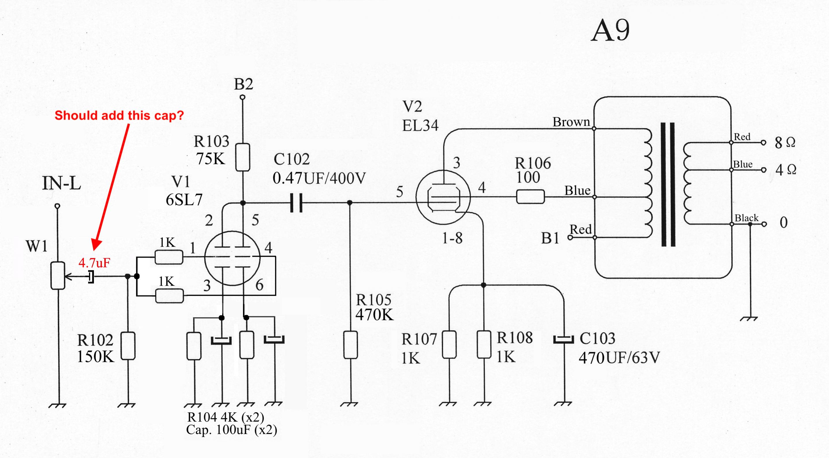

3. I have never used a 'second lower capacitance value bypass capacitor' across an electrolytic bypass capacitor. The same goes for B+ filter capacitors. I have not found it necessary in my circuits.
I used the "second lower capacitors" because I'm using the diagram proposed in post#225 (https://www.diyaudio.com/forums/att...el34-a9-tube-amp-a9-schematic-mods-rev1-2-pdf), but I be glad to remove them if they don't bring any benefits to the circuit.

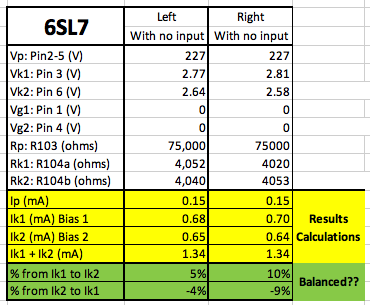

I've installed the two 4K cathode resistors and the two 1K grid stop resistors and it definitely improved the bias balance within the 6SL7 tube. They are now within 10%. see table below.
BTW, I'm currently using 470uF / 63V capacitors in the 6SL7 preamp tube but they are too big and look ugly. Since Vk is only 2.6V, can I use a smaller size capacitor 470uF / 25V?

That's a pretty dramatic improvement!I've installed the two 4K cathode resistors and the two 1K grid stop resistors and it definitely improved the bias balance within the 6SL7 tube. They are now within 10%. see table below.
Yes, a lower voltage cap will be fine IMO.BTW, I'm currently using 470uF / 63V capacitors in the 6SL7 preamp tube but they are too big and look ugly. Since Vk is only 2.6V, can I use a smaller size capacitor 470uF / 25V?
Also, 470uF seems 'big' in that spot - perhaps 6A3 or another person can explain the considerations for choosing a particular size (uF value) cap for cathode bypass.

Fdlima,
A. In regards to ways of testing how effective using a smaller uF bypass cap across a larger uF bypass cap is, I only know of a few test examples:
1. Use a Very capable LCR meter, and test the capacitors' ESRs (Series Resistance), and Dissipation Factors at both low and high frequencies. Then calculate the amount of improvement in the particular circuit you will use them in. i.e. given a 1000uF cap with an ESR of 1 Ohm (rather large for that), and the smaller 0.1 uF cap with an ESR of 0.05 Ohms . . . what is the result of using a 1000uF cap, with or without the 0.1uF cap in parallel (i.e. to bypass a 1000 Ohm self bias resistor and effective cathode impedance of 500 Ohms)? Very few will have access to that kind of an LCR meter; and some of them may not know how to calculate the results in the circuit under question.
2. Very accurately check the frequency response (especially at the high frequencies), with and without the 0.1uF cap in parallel with the 1000uF cap.
3. Measure the Harmonic distortion of the amp. Use a super low distortion sine wave generator, and a spectrum analyzer that has 85dB dynamic range (and either very low distortion, or use a 1kHz notch filter, and a 5kHz notch filter to reject the fundamental, and increase the measurement dynamic range). Check at 1kHz and 5 kHz.
4. Use your ears to hear the difference, with and without the 0.1uF cap in parallel with the 1000uF cap. Be sure to use the Double Blindfold testing method.
Most will pick # 4 above, but without the Double Blindfold method. The other tests are just a little out of range for many of us.
B. You can use a 10V, or 16V rated 470uF capacitor. Some electrolytic capacitors do not work as well if their rating is many times the voltage they will be used at, i.e. 63V rating working at 3V.
C. I am glad that using the individual self bias resistors got the more balanced voltage result you were looking for (and individual grid stopper resistors is just good to do). I was not surprised at the improvement.

Fdlima,
I have been a proponent of using a large value of capacitance for bypass capacitors.
This will give a way to calculate the bypass capacitance (it will have some approximations and simplifications, but will get you close enough). We are not doing a moon shot that does not have a midcourse correction, even NASA did not attempt that.
Lets look at your 6SL7. Transconductance is 1600 micro mhos Mu (u) is 70
The individual self bias resistor in your circuit is 4000 Ohms.
The 6SL7 transconductance is 1600uMhos. If the plate was tied to a low impedance (but it is not), then looking into the cathode we would see 625 Ohms impedance, due to 1 / transconductance.
But because the plate sees a high impedance, we have to take that into account (it affects the impedance of the cathode). The 6SL7’s 2 plates are sharing 75k Ohms (each plate effectively sees 150k Ohms).
In addition to the 625 Ohm cathode impedance, we have to add the impedance the plate sees, divided by the tube u.
150k Ohms / u = 150k / 70 = 2143 Ohms.
Now, looking into the cathode, we see 625 Ohms in Series with 2143 Ohms.
625 + 2143 = 2768 Ohms effective cathode impedance.
The 4000 Ohm self bypass resistor is in parallel with 2768 Ohms cathode resistance.
4000 Ohms in parallel with 2768 Ohms is 1636 Ohms.
We have to bypass 1636 Ohms.
If we are willing for that circuit to be -1 dB at 20 Hz, we need the capacitive reactance to be 1636 Ohms / 11. 1 dB is where the voltage drops to 89% (an 11% voltage loss).
1636 / 11 = 149 Ohms
Capacitive Reactance,
Xc = 1/(2 x pi x F x C) 1 / Xc x (2 x pi x F) = C 1 / (149 Ohms x 2 x 3.1416 x 20Hz) = 54uF
A 50uF bypass cap across the 4k resistor (working with the rest of the 6SL7 circuit) will have a frequency response that is -1 dB at 20 Hz, versus the response at 1 kHz.
Want that circuit to be -1 dB at 10 Hz, use a 100 uF cap.
Remember, if you have 3 circuits that are -1 dB at 20 Hz, the total response will be -1dB x 3 = -3dB at 20 Hz. So, 3 circuits that are -1 dB at 10 Hz, will be -3dB at 10 Hz.

I looked at Section 3.7 of my (new 🙂) copy of Merlin Blencowe's 'Designing High-Fidelity Preamps' where he discusses cathode bypass caps. The simplified formula for finding the bypass cap value gives a result of 40uF for a 4k cathode bias resistor. So 220 uF or even 100uF would probably be 'plenty' for your 6SL7 cathode bypass around a 4k resistor.Also, 470uF seems 'big' in that spot - perhaps 6A3 or another person can explain the considerations for choosing a particular size (uF value) cap for cathode bypass.
BTW, the Blencowe book is excellent - much better IMO than Morgan Jones, which I own but where I usually 'can't find the answer to my question'.
EDIT: See, I knew 6A3 would be here with a good answer! Thanks - we were typing at the same time, 6A3.

I added the following mods to the original schematics:
R101 added,C103 exchanged against 470yf+10nf paralleled ( same as circuit A in the schematics)

From what I'm reading, there is no need for the "second lower capacitors" in parallel with the electrolytic caps so I have removed them from my circuit. So with this mod, the final diagram of my amp is this one shown in the picture. (Note: I only draw the left channel. Right channel is exactly the same)
I have question: Almost all transistors amps circuits I've seen have a small value decoupling capacitor on the input to block possible DC from external sources. is this cap also recommend for tube amp? (BTW, it's showing in the diagram but I have not installed it yet)
I've traveling so I was disconnected for a few days.
Most of my tube amp builds have that type of input cap - I just followed the published schematics for projects. I think it's a good idea. 4.7uF seems like 'a bit much' though, I think 0.47uF or even 0.1uF would probably be OK and a film cap in those values wouldn't take up too much space.I have question: Almost all transistors amps circuits I've seen have a small value decoupling capacitor on the input to block possible DC from external sources. is this cap also recommend for tube amp? (BTW, it's showing in the diagram but I have not installed it yet)
