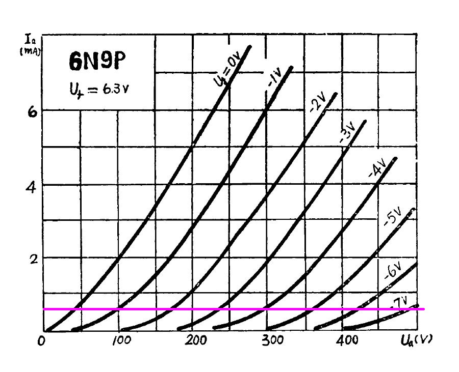

That current seemed low to me, looking at the tube curves.
What do you think?
It looks like the tube specs are showing 2ma or so for each half of the tube.
(I understand that the current changes with the signal voltage on the grids.)
This was what I measured a while back. Post 648
Yup, a bit low. That's like around 1/4watt plate dissipation per section, looking into a 75k load.🙁

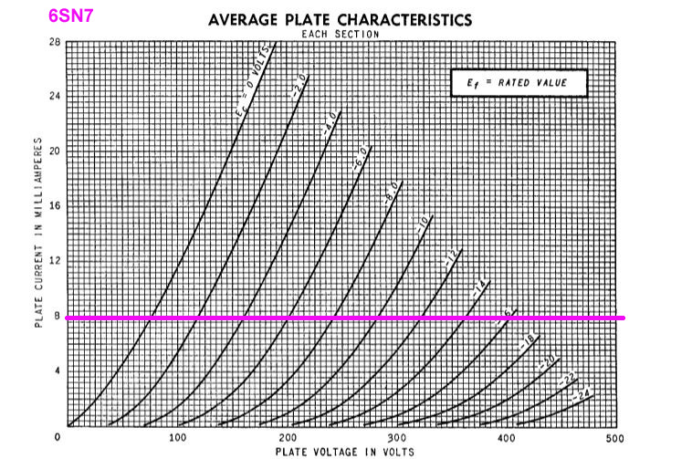

The candidates were 6SN7, 20 NOS, and 10 used tubes (all 60 triodes tested good in a tube tester) and were tested in the article: "Paralleling Tubes Effects". The data collected was 600 measurements, including DC current, AC gain, and distortion out to the 7th Harmonic. Each dual triode pair was tested against itself, and against each of the triodes in a second dual triode pair, until all 60 triodes were tested alone, and tested paralleled with 3 other triodes (one at a time). They had 1 k Ohm in each cathode with individual bypass capacitors, and 25k Ohm in each plate. The grids were connected together. Each triode current ranged from 7.4 to 8.3mA of current, when they all had their own cathode resistor, and their own plate resistor.
When the cathodes were connected together and the plates were connected together, the total self bias resistor was 500 Ohms, and the total plate resistor was 12.5k Ohms. Even though all the individual un-paralleled triode current maximum variation was 12%, when the cathodes and plates were paralleled, sometimes one triode would take over, the result was one triode had up to 2 times as much current as the other triode in the paralleled set. That is a mismatch of 50%.
So from 12% to 50% mismatch . . . that indicates that a mismatch of say 2% for individual triodes may result in a 8% mismatch when they are paralleled (unless you use individual self bias resistors and individual bypass caps . . . and do not parallel the cathodes, just parallel the plates and grids). As long as the tube currents were reasonably matched during parallel operation, the -dBc of each harmonic number (2 - 7) were merely the simple average of the two individual un-paralleled sections.

What chart are you using? I'm having a hard time understanding.
What do you think?
I have a hard time understanding, too..😀
In the work that 6A3 describes, they were running the triodes in the 6SN7 at about 8mA (each).
In the Boyuu, it seems that each triode in the 6N9P is running at about 0.65 mA (assuming the current is divided equally between the two halves of the tube).
Looking at the 'Plate characteristics' graphs (Current vs voltage for different grid bias voltages), the working currents seem to be in different parts of the graph.

Will half a 6N9P not have enough gain to drive the EL34 in SE?
How about the 0.65ma how do you come to this value based on the 2.6volts?
Ohms Law
V=IR
2.6 V voltage drop across a 2k ohm resistor
I= 2.6/2000
I=0.0013 A or 1.3 mA
That's the current for both 'sides' of the tube, since all the tube current flows through that one cathode resistor.
So, if the current is shared equally between the two triodes, it's 1.3/2 mA or 0.65mA for each triode.
I think that's correct?🙂
